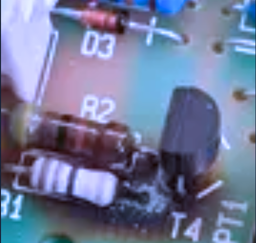

    I made a typo mistake about the resistor reference: in fact I need to confirm R2 (47 kΩ?), not R52 (which is effectively 10Ω).

  • 470 kΩ vs 47 kΩ resistor color-code check

    The R2 can't be seen on photos, it must be behind some other component. On another board I found info that this may be a 470k resistor. This is based on info from another Dometic SMP unit, but they seem to share a lot.
    Also, I found a very low quality and poor colour rendering photo of this resistor, burnt, but there is still something visible. Manual colour correction of white balance still does nothing useful with this photo.
    Circuit board with visible resistor R2 with colored bands and other components. Close-up of a circuit board with a resistor labeled R2 and other electronic components. .
    This is likely a 5-bar resistor, so it goes like yellow, violet, black. The question is if the fourth strip looks rather orange or red. Orange would be 470k and red would be 47k. Maybe someone with a similar board can check.
