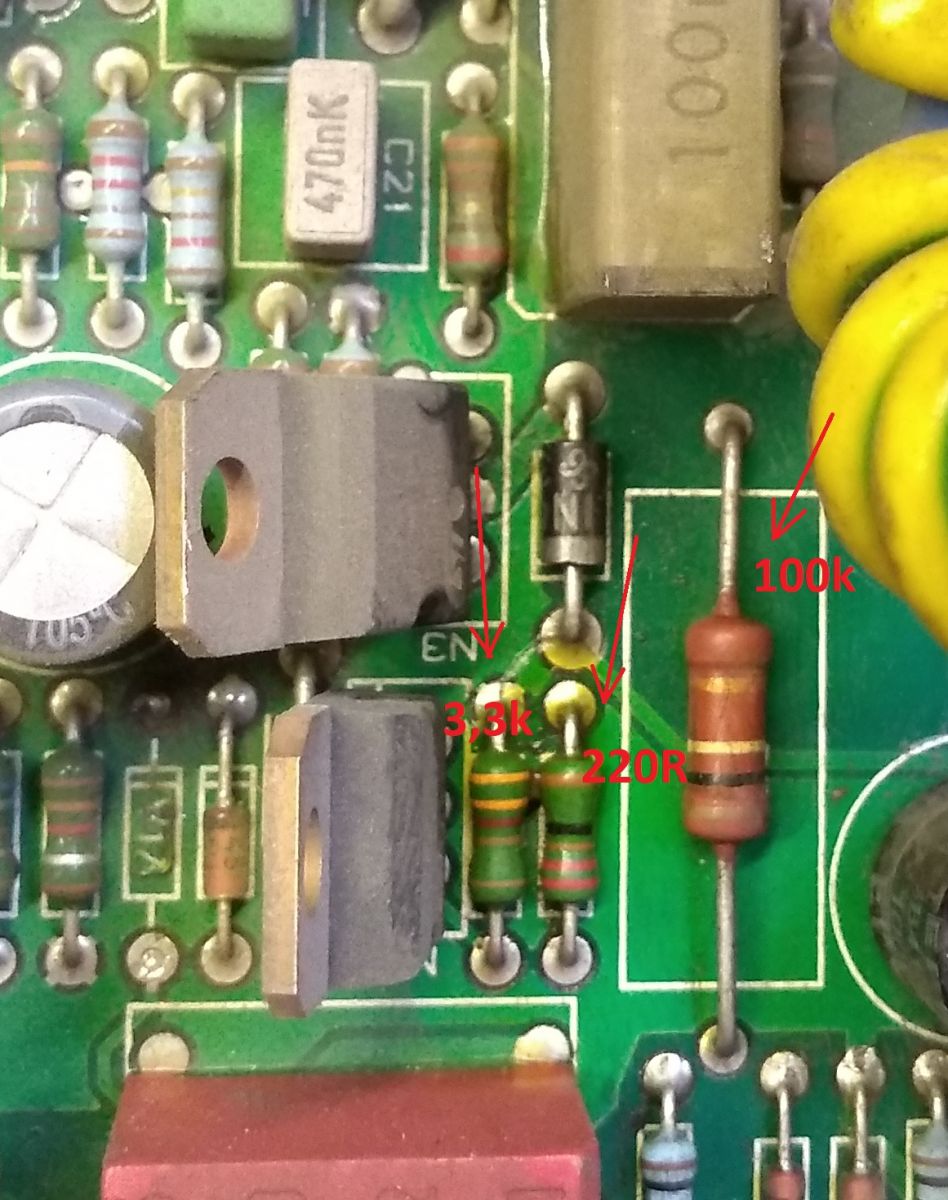

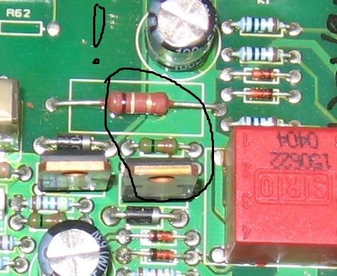

    H Kemppi Minarc 140 - Resistor Values Hidden by LM217? ello, what should be the values of the three resistors (the third is hidden by LM217).

    K@mil
    Posts: 70
    Help: 5
    Rate: 7
