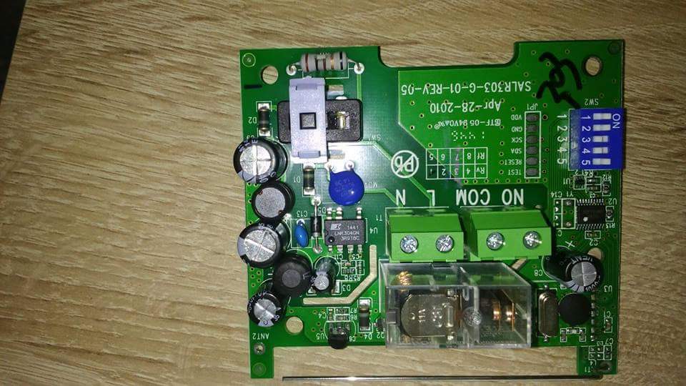

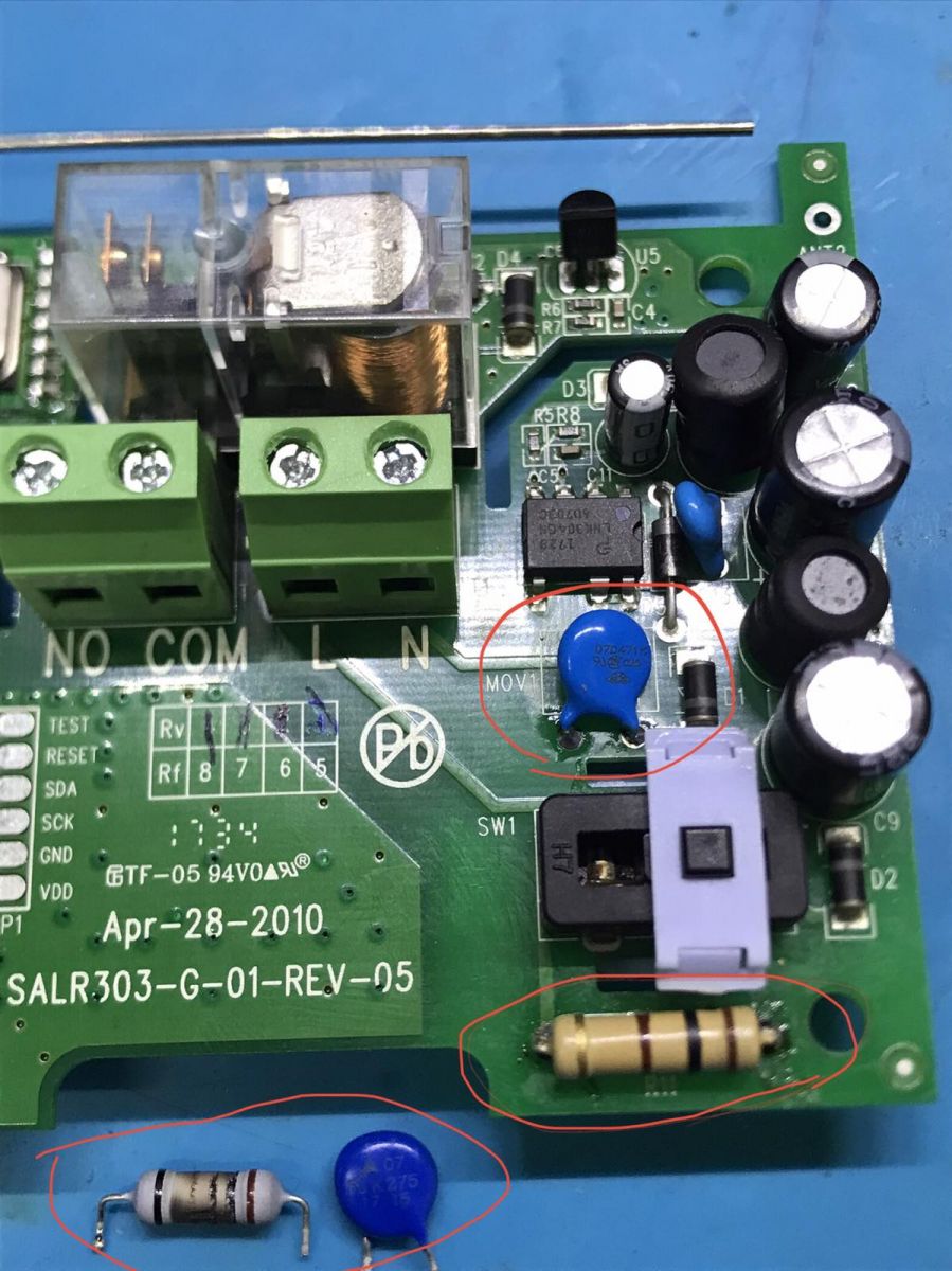

What is the value of the resistor in the upper left corner of the SALR303-G01 board?
The resistor in the upper left corner is 100 Ω / 2 W [#18287772] One reply also identifies the color code as brown, black, brown, gold, black and notes that its power rating is above 2 W [#15243438] The same post says the board’s MOV1 varistor is MOX 431 KD07 [#18287772]
  • #1 15243217
    zWrocławia
    Posts: 32
    As in the title, I`m looking for the value of the first resistor in the upper left corner.
    It immediately says that the second line is a torn mesh in the middle of the resistor.
    • SALR303-G01 Schematic: Identifying Upper Left Corner Resistor Value received_929544747093323.jpeg (85.11 KB) You must be logged in to download this attachment.

    This may be useful, the colors are not clearly visible in the photo - good luck SALR303-G01 Schematic: Identifying Upper Left Corner Resistor Value
  • #3 15243438
    ArturAVS
    Moderator
    Posts: 26413
    Help: 2303
    Rate: 7830
    Can be seen. Brown, black, brown, gold, black. Power above 2W. It`s hard to judge without dimensions.

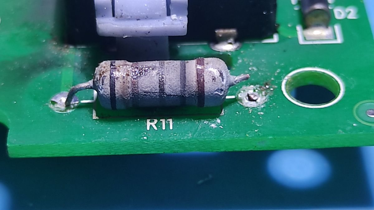

  • #4 15243440
    zWrocławia
    Posts: 32
    The problem is that you can`t read the "multiplier" ... because this part of the resistor has burned out.
  • #5 15243482
    ArturAVS
    Moderator
    Posts: 26413
    Help: 2303
    Rate: 7830
    The photo shows otherwise.

    I inserted 10R 5% and after connecting it, it flashed in the ceramic capacitor.
    Could a too small resistor damage the capacitor in front of the switch?
    I still have 18R 5% (measured 18.0R) in stock.

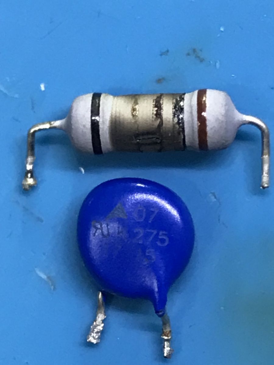

  • #7 17777313
    boring
    Resistor rating is likely 10 ohms. And I need a type of varistor. On the board position MOV1. On my board it burned out to be unreadable. On your photo is also impossible to read. I would be grateful if you write it.

    ddicky
    Posts: 92
    Rate: 9
    Wartość rezystora o który pyta autor postu jest 100 OHm/2w
    On this PCB is varistor MOX 431 KD07.

  • #10 19030693
    BrodowskiG
    Level 22  
    Posts: 378
    Help: 52
    Rate: 195

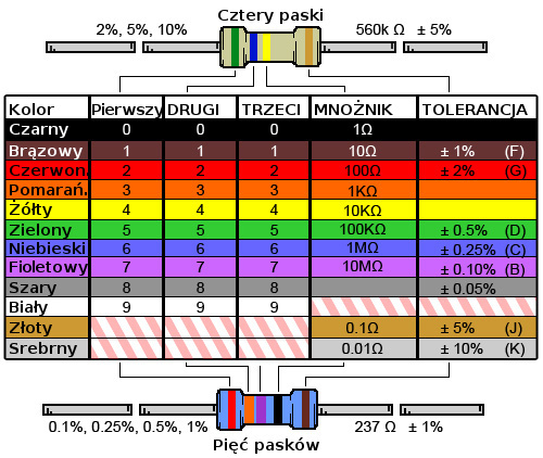

    Hello, I just approached this board, unfortunately it was buried, the resistor should be 100 ohms, can someone explain what`s going on with the stripes, that looking at the standard tables it is 10 ohms, is there any other standard?

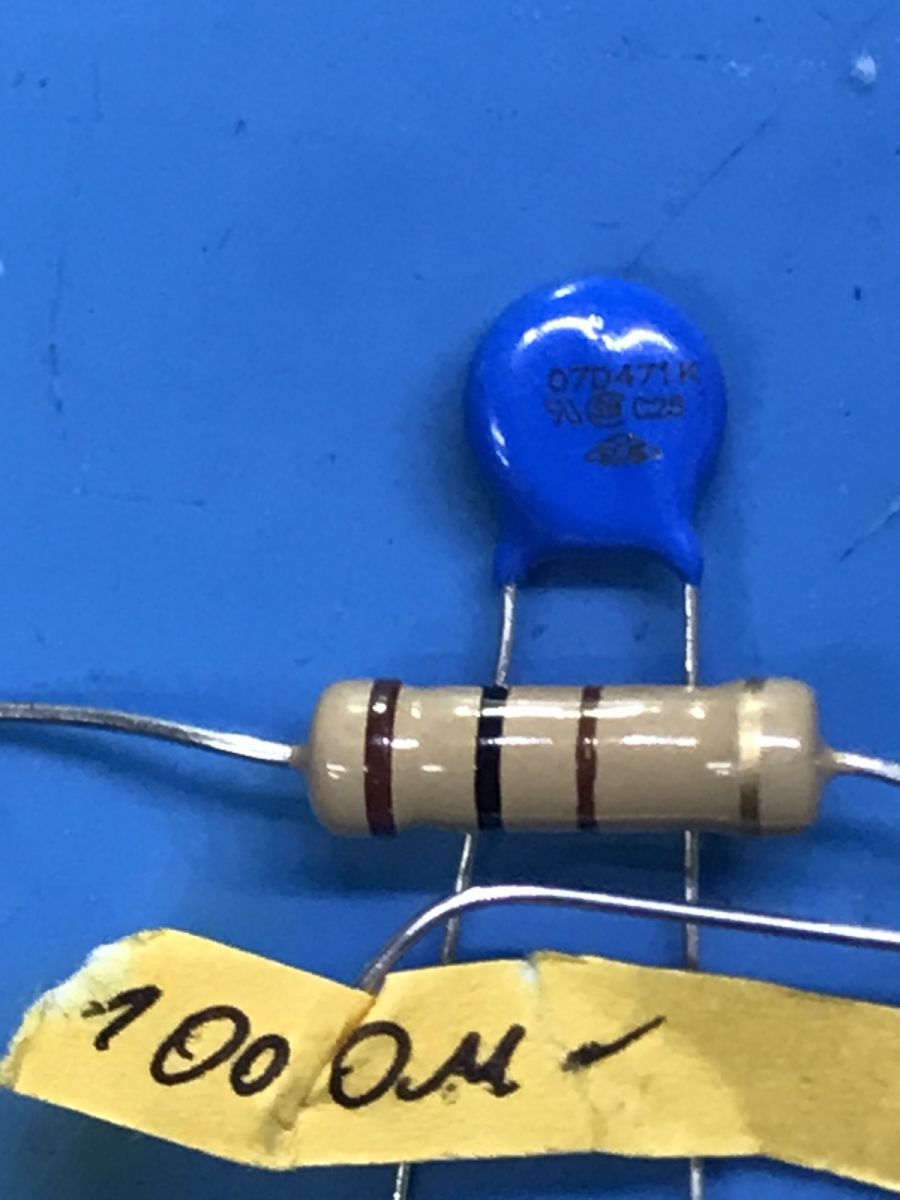

  • #11 20377740
    Vovan066
    Hello! Also got into repairs. I decided to help. How you helped me by raising this topic. Resistor R11 / 100 Ohm / 2W semistor also needs to be replaced...
    SALR303-G01 Schematic: Identifying Upper Left Corner Resistor Value SALR303-G01 Schematic: Identifying Upper Left Corner Resistor Value SALR303-G01 Schematic: Identifying Upper Left Corner Resistor Value

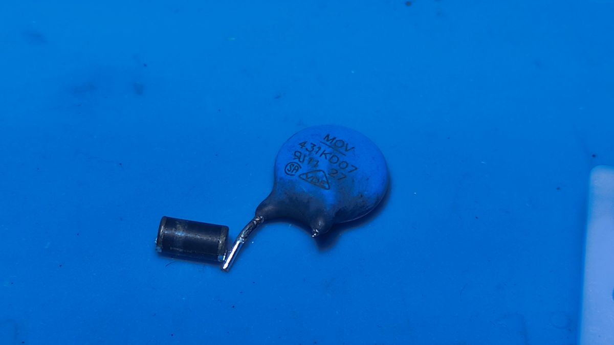

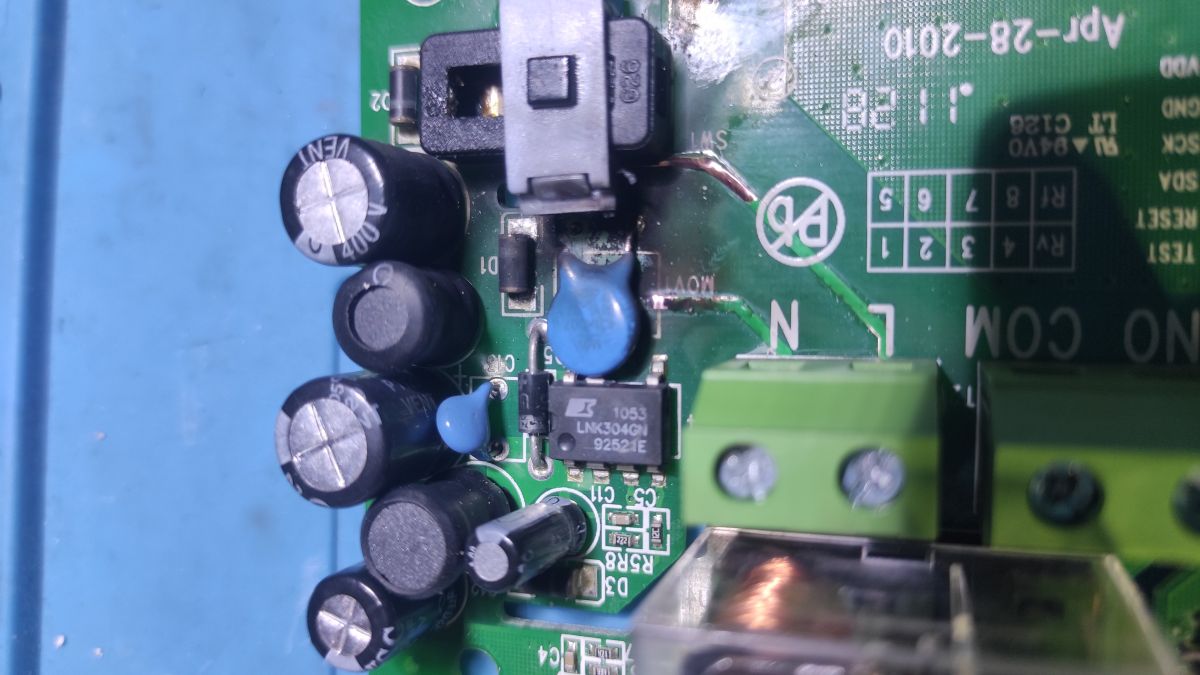

  • #12 21270925
    peterkos2
    Posts: 58
    Rate: 9
    Witam wszystkich. Tutaj też mam podobny problem, potrzebuję tylko jeśli ktoś wie co to za dioda D1, poza rezystorem R11 i MOV1 jest zwarta. Podejrzewam też U4-LNK304. Dziękuję za odpowiedź w międzyczasie Close-up of a printed circuit board with various electronic components, including capacitors, diode D1, and LNK304GN integrated circuit. Blue MOV varistor with the marking 431KD07 on a blue background. Image of a damaged resistor R11 on a circuit board.
