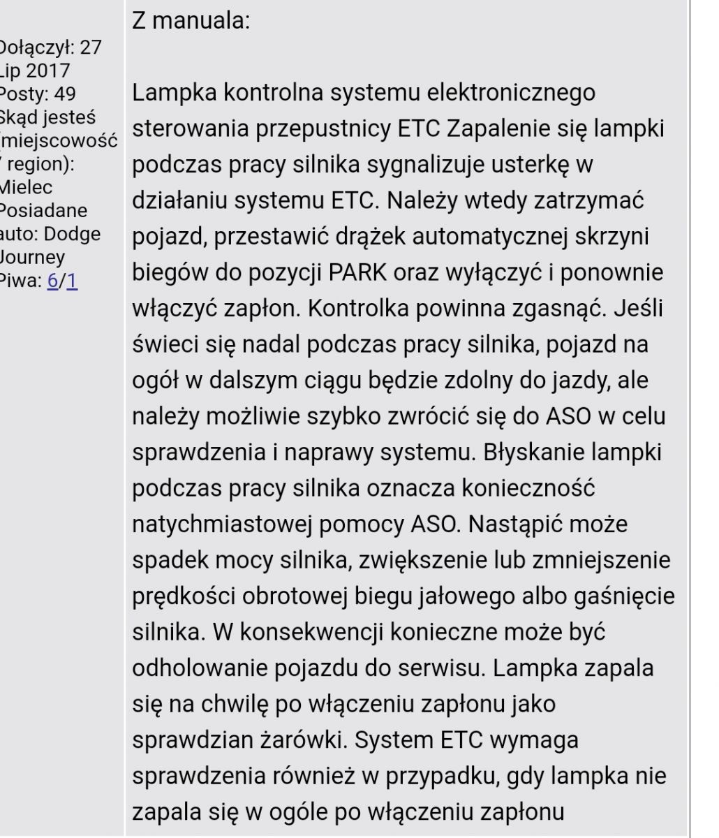

    Hello to everyone here I am new here Auto electrician from Ghana need your help how to solve lighting bolt for Dodge Magnum

    The image shows a part of an online forum with content about the ETC throttle control system warning light in a car. .
