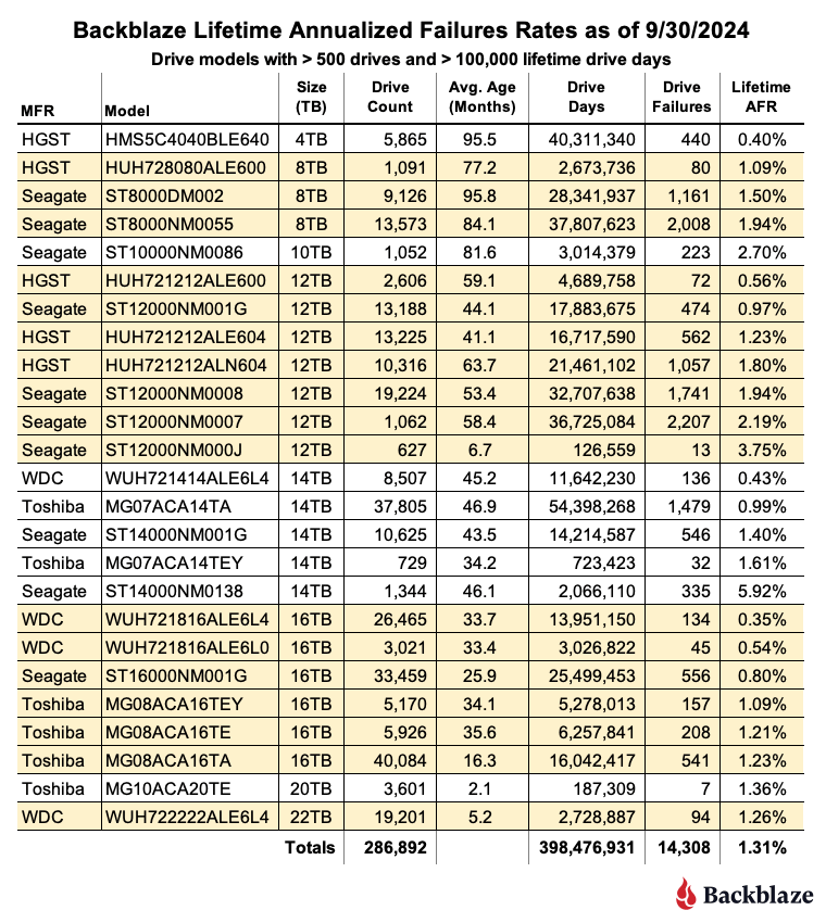

    1) How can I identify if a 2.5" HDD model is good for archiving? Is there a failure chart between the models? Or by sales batch and year of manufacture?
    I have Seagate ST500LM030, WD10JPVX-08JC3T5 and HGST HTS541010A99E662
    2) Is there much difference between 2.5" CMR HDD x 2.5" SMR HDD in terms of long-term data archiving?

    SMR is junk that no one should ever buy. Regardless of manufacturers' fiddling, conjuring up reality, nothing will change that.
    gamemaniaco1987 wrote:
    Is there a failure rate table for individual models? Or by sales lot and year of manufacture?
    Not for the 2.5 inch. For 3.5 it runs backblaze statistics.
    Is there a failure rate table for individual models? Or by batch of sale and year of manufacture?
    - no, it's too much work and too expensive for someone to do this really systematically and reliably.
    ST500LM030,
    - of these it has the highest risk. The SMR, plus the disastrously resolved mechanics, should disqualify it from serious use, but this and similar models are often chosen because they are cheap.
    Is there a big difference between a 2.5-inch CMR hard drive and a 2.5-inch SMR hard drive in terms of long-term data archiving?
    - yes - the primary risk factor is the two-level logical to physical address translation subsystem.

The discussion centers on identifying reliable 2.5" HDD models for long-term data archiving, comparing CMR (Conventional Magnetic Recording) and SMR (Shingled Magnetic Recording) technologies. Participants express strong skepticism towards SMR drives, labeling them as unsuitable for serious use due to higher failure risks and mechanical issues. Recommendations lean towards CMR drives, with specific models like the Samsung ST1000LM024 and various WD and Seagate models suggested for better reliability. The conversation also touches on the inadequacy of 2.5" drives for archiving compared to alternatives like tape storage and M-DISC, emphasizing the importance of checking SMART data and avoiding known problematic models. Additionally, the topic of HDD demagnetization is addressed, clarifying that self-demagnetization is not a concern for HDDs.
TL;DR: 1000-year M-DISC claim highlights archival trade-offs; “None. Hdd disks are not designed for such purposes.” Prefer 3.5-inch CMR, avoid SMR. [Elektroda, cysiekw, post #21398561]
Why it matters: This FAQ helps home users and small labs choose reliable, low-hassle storage for long-term backups and cold archives.
How can I tell if a 2.5-inch HDD model is good for archiving?
There is no authoritative failure table for 2.5-inch drives. Screen by design instead. Prefer CMR and avoid SMR. Avoid models flagged for weak mechanics. When possible, choose 3.5-inch CMR where reliability data exists. This simplifies risk assessment. If you must use 2.5-inch, plan redundancy. “Too much work and too expensive” to track 2.5-inch failures systematically. [Elektroda, kaleron, post #21381432]
Is there a big difference between 2.5-inch CMR and 2.5-inch SMR for long-term storage?
Yes. SMR adds a two-level logical-to-physical address translation that becomes a primary risk factor over time. Sustained writes and recovery scenarios are less predictable. CMR writes directly and avoids this extra layer. As one expert put it, “the primary risk factor is the two-level logical to physical address translation subsystem.” For archives, choose CMR. [Elektroda, kaleron, post #21381432]

Where can I check real-world failure statistics before buying?
Use Backblaze’s public hard drive stats for 3.5-inch models. They have maintained failure statistics for years, which helps compare families. Review model-specific AFR trends, not just brands. Then combine with your workload needs and redundancy plan. [Elektroda, cysiekw, post #21432529]
What failure rate is “normal” for modern 3.5-inch HDDs?
Expect an annualized failure rate around 1–2% as a rough planning baseline, varying by model and age. Use this to size redundancy and test cadence. Always validate current-year reports, and avoid single-drive archives. Treat AFR as guidance, not a guarantee. [Backblaze, 2023]
