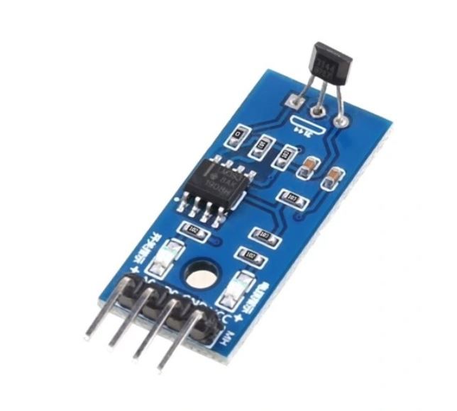

    A colleague Waldek has made a cool RPM counter on an Arduino using an A3144 Hall sensor with software.
    The video is on YT
    https://www.youtube.com/watch?v=nO3DbYL_3vQ&a...vNgj2g_rZfk9Tht4AaABAg.994sViAIPI9ADUeQknJiDE
    My question is, as I am currently relying on ESP, is it possible to upload this soft to ESP in some non-difficult way? Either in "rules" or as a script in domoticz. There are LUA, dz vents, blockly, python scripts in domoticz. Is it possible to convert this in some easy way ? If not I will do it on Arduino and somehow try to connect to Domoticz.
    batch to arduino:
    Code: C / C++
    Added after 4 [minutes]: .
    I also bought a : Hall sensor module hall sensor A3144 Arduino, but without scripting - which I am poor at - is it possible to get a measurement of the number of revolutions ? In combination with ESP
    Hall sensor module A3144 for Arduino
    ESP8266 RPM counter code with LCD and Domoticz upload

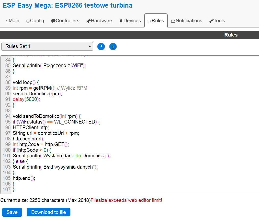

    I've uploaded the soft on ESP8266 but I see it's cramped :) -waiting for ESP32
    ESP Easy Mega user interface with code exceeding text limit. .

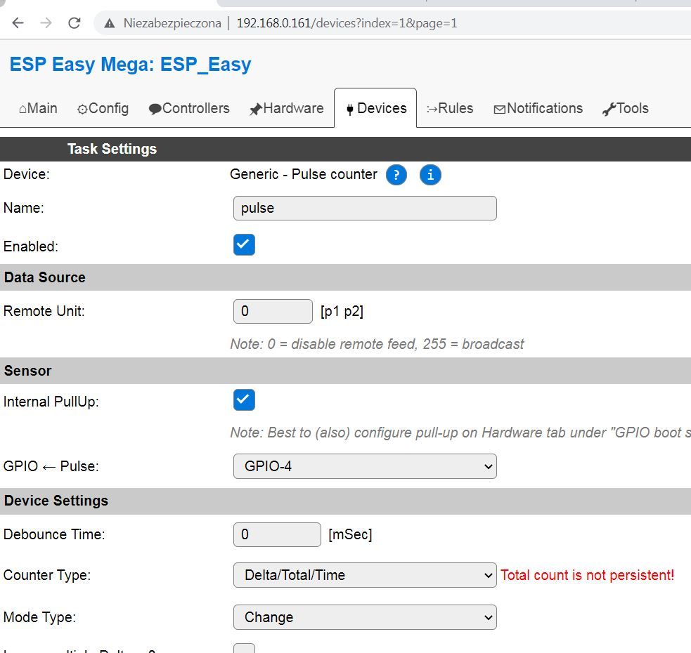

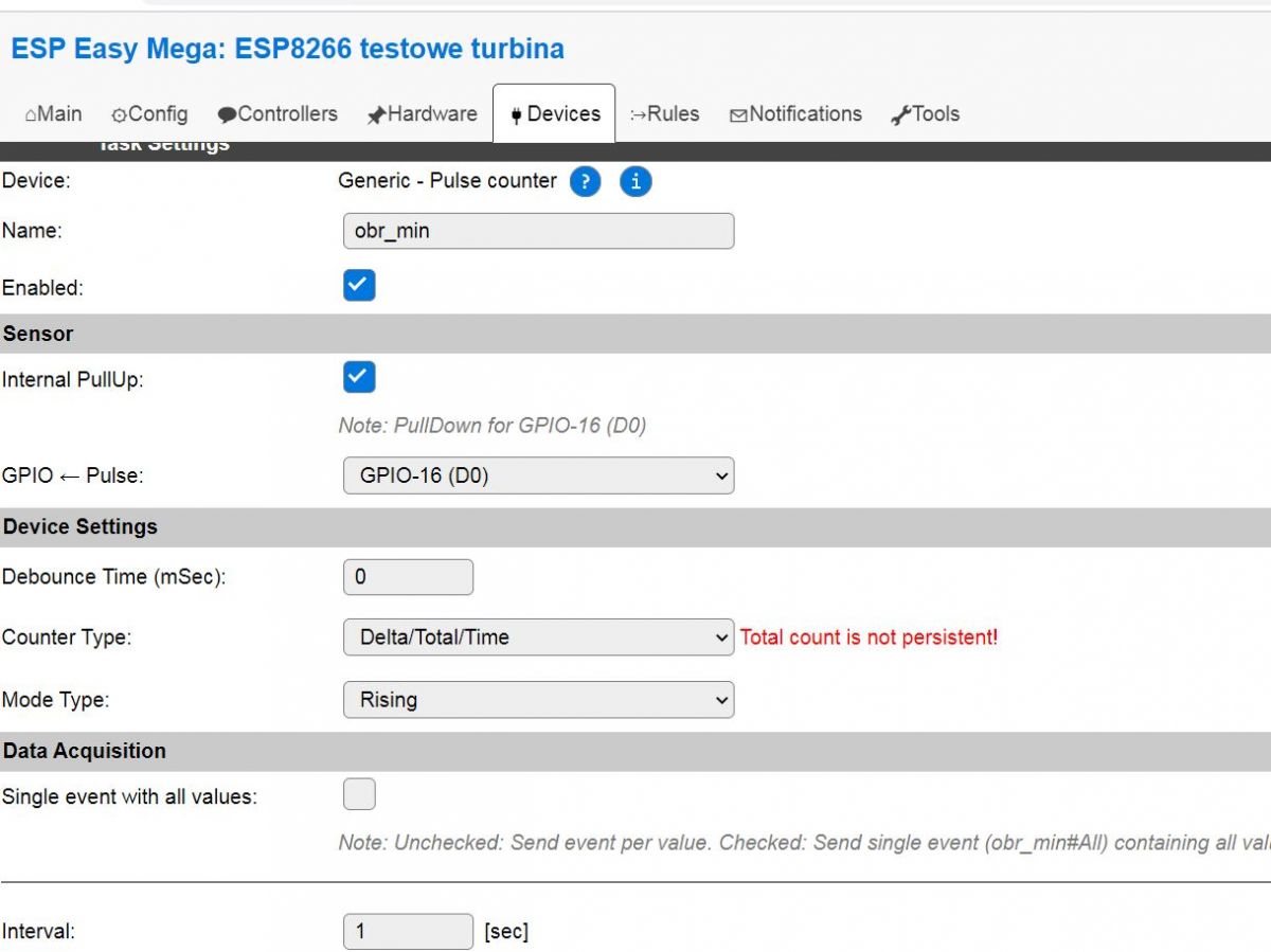

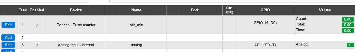

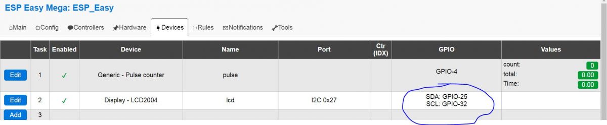

    Configuration screen view with sensor settings, including pulse counter and analog input. .

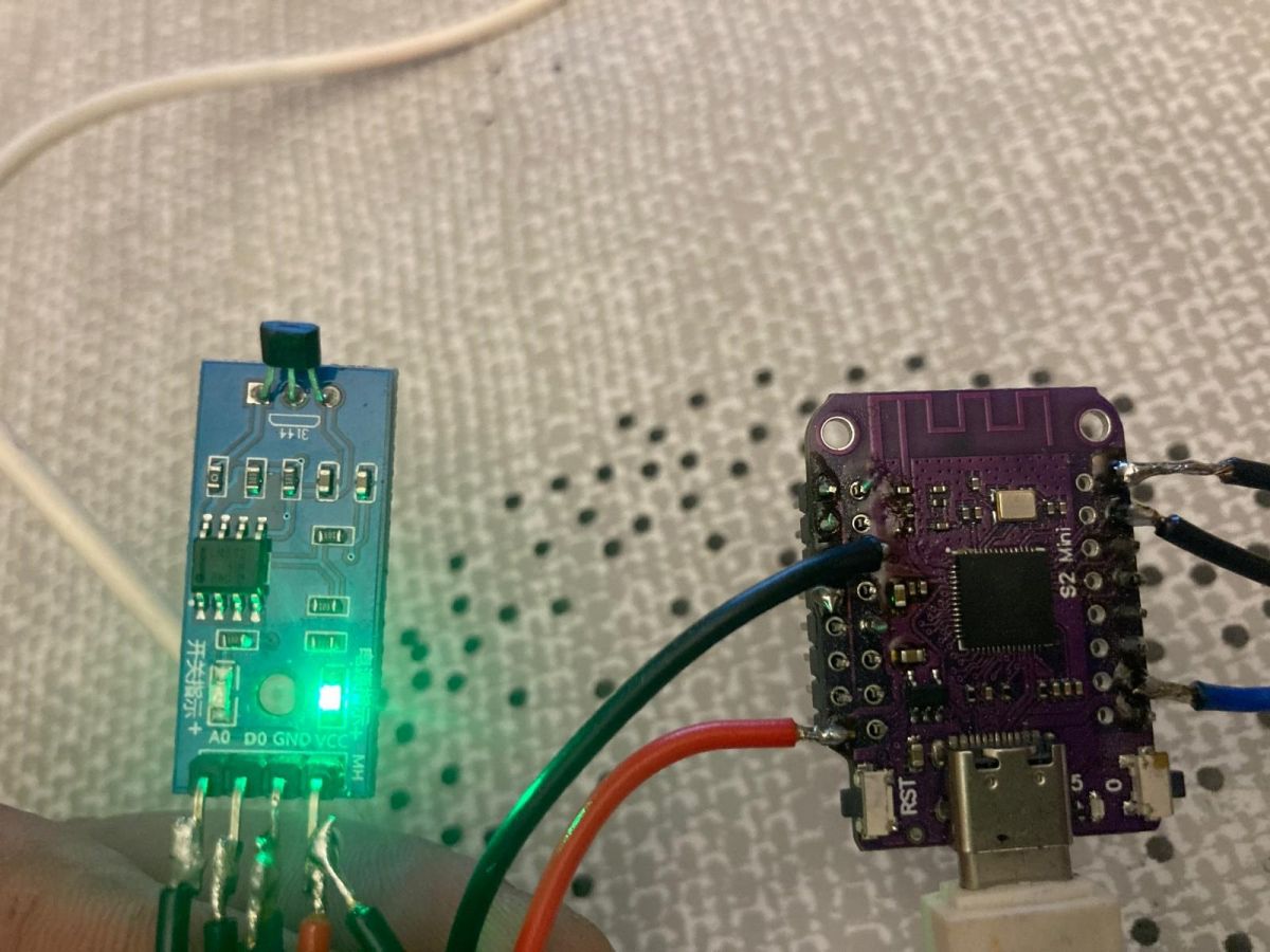

    I'm trying to think the other way, I have this ready-made module with Hall sensor: A3144E, Comparator: LM393, Signal: digital, analogue. I don't know how to set, because count, total and time nothing changes.
    Screenshot of ESP Easy Mega device configuration with pulse counter settings. .
    Added after 6 [hours] 42 [minutes]: .
    Hall sensor module A3144E and microcontroller board connected with wires. .
    Electronic circuit with Hall sensor A3144E and comparator LM393. .
    I managed to get it to work. I don't know what the "Time" is for, whether to use it and how. Surely the correct mounting of the magnet in relation to the sensor is important. It works.

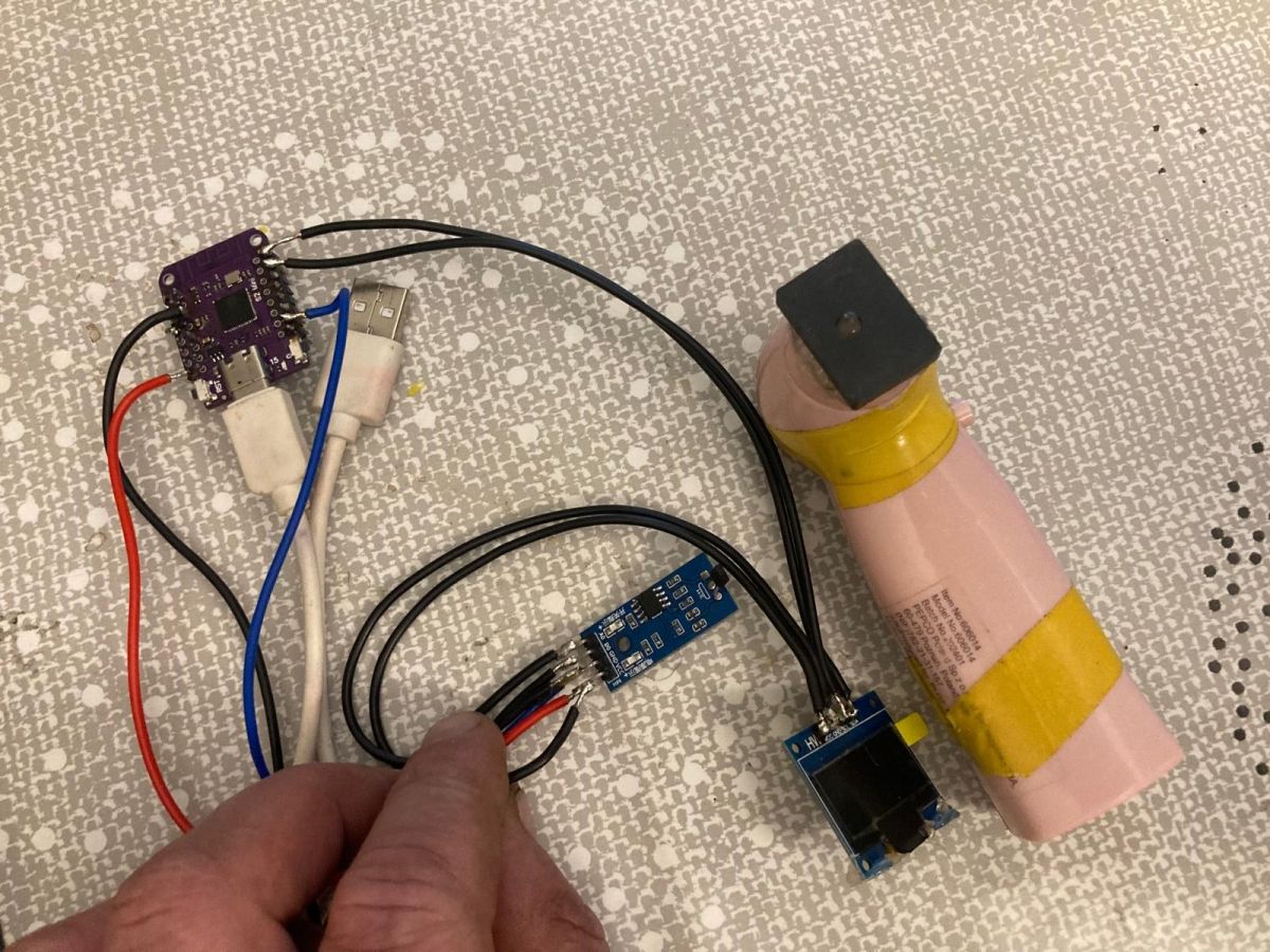

    I got the display, connected the Hall sensor, uploaded the revised software to the ESP. I uploaded it to the ESP32 and it doesn't work - i.e. it doesn't display RPM etc on the display.

    Can you see anything on the display, does it light up maybe you need to tune the contrast, What pins is it connected to on the ESP 32 (SDA - default GPIO21, SCL - default GPIO22)? This display is not on 5v? The Esp32 gives 3v3,.

    I checked the display by displaying the measurements of other sensors [....#...]. I adjusted the contrast. I connected the display (power) to the 5v pin naturally it's VIN (because I switched to ESP32W32room board) or VBUS for esp32S2 mini . SDA SCL as in the picture

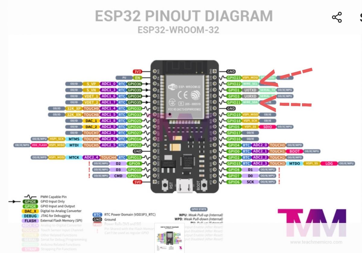

    ESP32-WROOM-32 pinout diagram with color-coded pin functions. .
  • #10 21416616
    sznickers
    Posts: 196
    Rate: 8
    Are you saying to connect SCL, SDA under GPIO21,22 ? There is an option to connect under several different pins these channels and so I did. Do you think that if I change to these pins it will be ok ?

    These pins are the default, for those to work you need to set them in the code.
    ESPEasy rules cannot run Arduino code
    #12 21416663
    starob
    Posts: 1088
    Help: 128
    Rate: 137
    sznickers wrote:
    doesn't work-i.e. doesn't display RPM etc.
    @sznickers again you are trying to conflate two different "currency systems".
    You are trying to run an arduino program in RULES espeasy. RULES is an internal interpreter created for espeasy and is like its own programming "language".
    Mixing ingredients like this is only good for cooking bigos :) .
    ... you either upload a pure .ino ...or espeasy and a proper rules script.

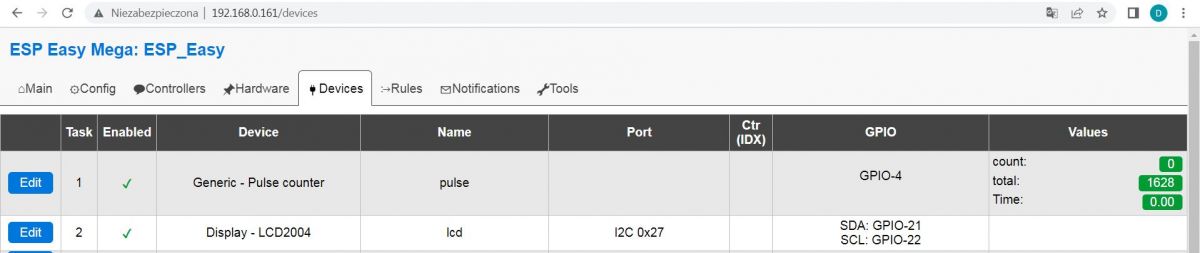

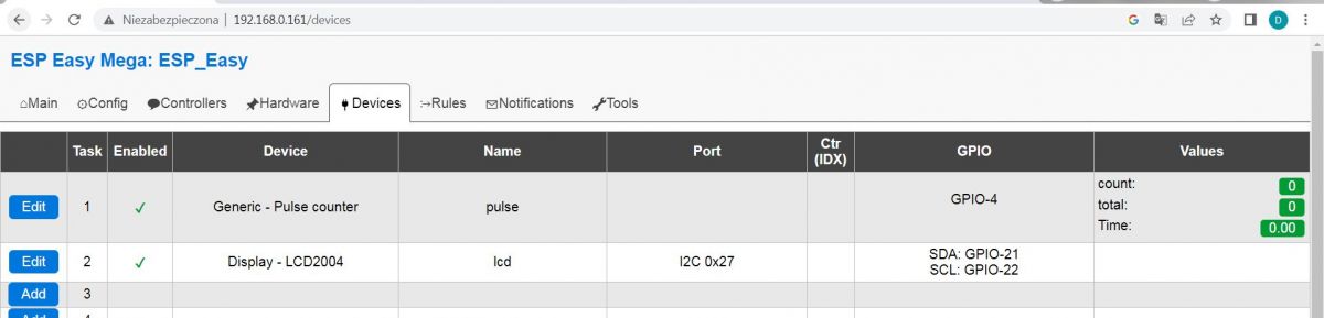

    The iftri I changed the SCL and SDA pins to 21 and 22, but it didn't go either. The display lights up, but only in green.
    Screenshot of the ESP Easy Mega interface showing a device list with names, ports, and GPIO values. .

    The I2C bus always requires 2 external pull-up resistors for the SDA and SCL lines.
    Perhaps, it is sufficient for the GPIO to include an internal pullup? (most "tutorials" only use internal").
    First run the display itself by uploading some arduino demo, when you are sure that the hardware works well - upload espeasy.

    Screenshot of ESP Easy Mega settings on the Devices tab with configuration for a pulse counter. .
    I changed to pull up, also nothing. The display works because I tested it on a different script, when I turn ESP on or off it says ESP Easy.

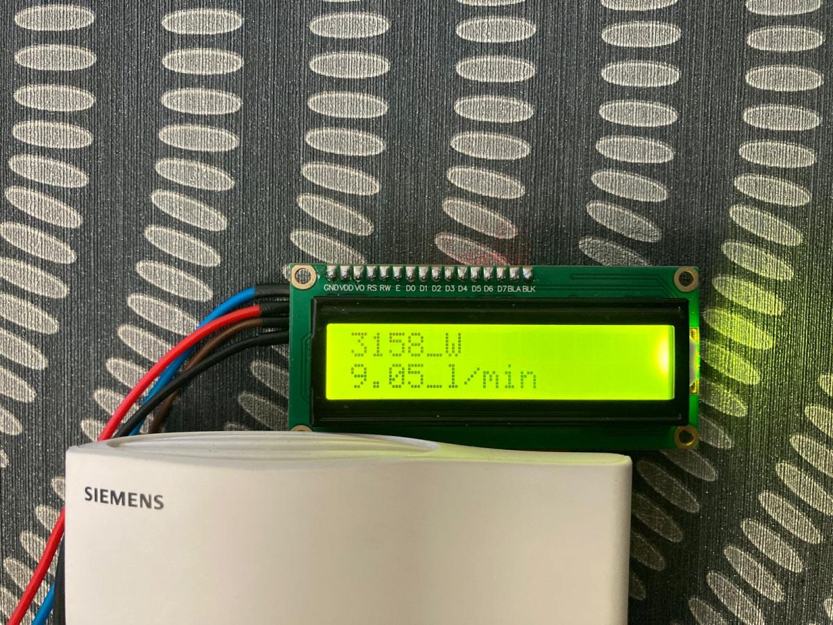

    Added after 3 [minutes]: .
    LCD display showing values: 3158 W and 9.051/min, connected to a Siemens device. .
    when switching on the LUA script from domoticz from other sensors it works nicely

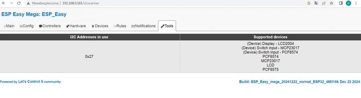

    tip... In espeasy there is in tools > interfaces > I2c scanner, allows you to check if the device is detected.
    What are you trying to display and how?... because I don't really believe you've already dealt with the rules. More info!

    Yeah, there's such a tool, I'm getting it :)
    Screenshot of the ESP Easy Mega user interface showing used I2C addresses and supported devices.

    Which sensor signal, A or D do you have connected to the GPIO of the esp? (Because you have cables on both).
    When you spin that magnet does your DOUT LED blink?
    I ask this for future reference :) .

    On the hall module, I have the signal cable connected to D0 and the ESP counts the number of revs and the number of rpm --> yes +/- because it obviously still needs to be calibrated. The LED on the hall module when I apply a magnet or a fan with a magnet blinks, yes or lights up continuously as there are revs.
