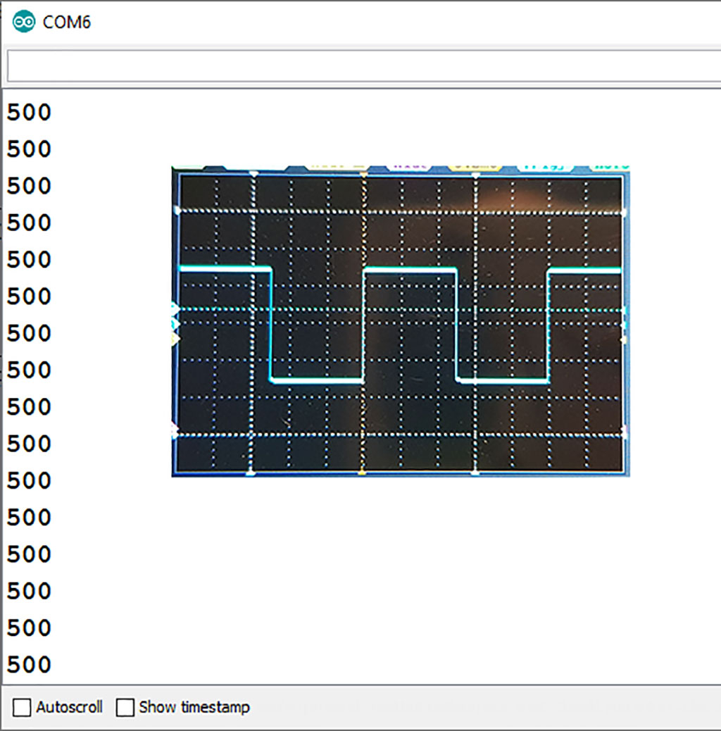

    For testing, I prepared a trivial code: For one second, the interrupts are to count pulses from the digital output of the Waveshare Hall AH49E module (it has both analogue and digital outputs). Then, I turn off the interrupts and display the number of counted pulses. In the target program, I will count the RPM. To start with, the number of pulses per second is enough for me.
    To check how the code works, I connect a signal from a rectangular waveform generator to the module input. The signal has a frequency of a few hundred Hz. This is a frequency close to that which will be given by the sensor mounted on the spindle. The code works perfectly. By varying the frequency from the generator I can measure "speed" from a few hundred to a few tens of thousands of RPM without any problem. Beautifully.

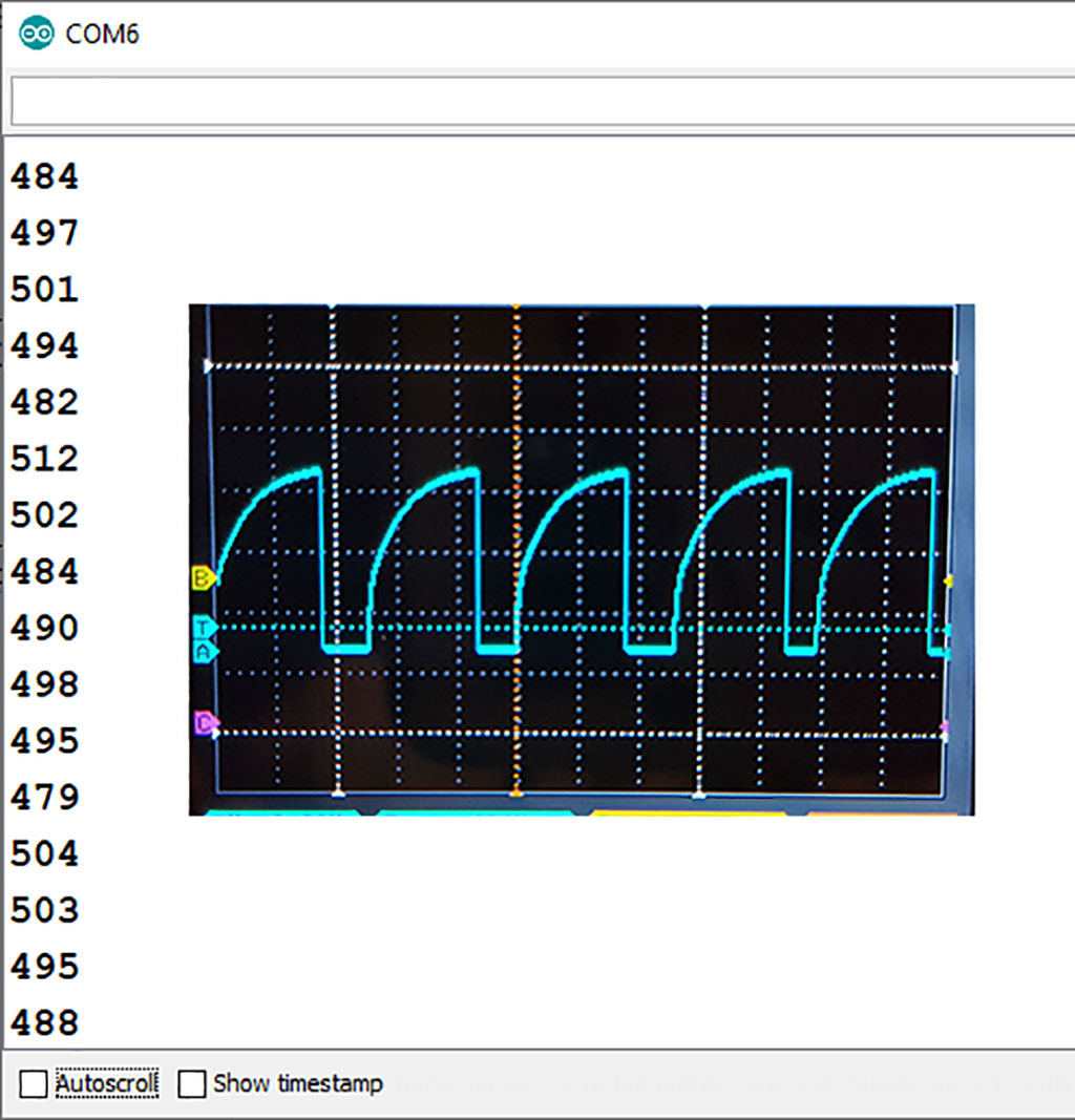

    Unfortunately beautiful is not. :-( The problems start when, instead of the generator, I connect a HAL sensor to the ESP 32 (GPIO 17).
    I made two attempts with the same sad result:
    1) The sensor is attached close to a magnet glued to the fan wings from the PC.
    2) The sensor mounted near the CNC spindle
    The results shown by the software are highly variable. They vary from second to second, e.g. between 780 and 1140 pulses counted in one second, despite the apparently constant speed of the fan or spindle. I would still be able to believe that the fan rotates unevenly, but the inverter-controlled spindle rather has a constant speed. The amplitude of the signal from the generator and the HAL module is the same.
    My toy oscilloscope shows that the signal rises slowly but falls quickly.
    I attach two images. One shows the results on the Arduino IDE console for the rectangular waveform and the waveform itself on the screen of my toy oscilloscope, the other shows the results plotted every second when the HAL sensor is connected to the ESP and the waveform from the digital output of the HAL sensor module. Even on the oscilloscope screen the frequency readout is not constant.

    SALLDHMF wrote:
    Where could the error be? I don't like the shape of the "digital" signal from the sensor module.
    In my opinion, the comparator used in the module is loaded with a relatively high resistance at the output. And since the LM393 has an open collector output then those rising edges you see are mild because here only the resistor to the plus works. You could try adding a resistor between the module's output and the plus of its supply and watch how the shape improves.
    But in general, for this application a Hall sensor not linear but digital, integrated with a schmitt flipper, would be better. Something like this, for example:
    https://botland.com.pl/pl/czujniki-magnetyczn...ik-halla-pola-magnetycznego-iduino-se054.html

    SALLDHMF wrote:
    In Botland, I did not recognize the difference between these sensors.
    Don't worry because Botland itself probably doesn't read too much into the difference between linear and digital.
    For example, this:
    https://botland.com.pl/pl/czujniki-pradu/1429...ul-z-czujnikiem-halla-pola-magnetycznego.html
    Where in the picture you can clearly see the symbol on the sensor "49E" meaning linear (same as on your module) and no resistor R1 needed for digital, and they sell this as digital.
    SALLDHMF wrote:
    I supply the sensor with 3.3V from the module with ESP.
    A very important point here. The digital module I gave you as an example earlier with the A3144 sensor (or equivalent with the same number) has a catalogue power supply range of 4.5...24V.
    Therefore, on a 3.3V supply it is basically not suitable. But if you only have e.g. 5V available in the device then, because the sensor itself has an open collector output, you can supply the sensor with 5V and connect a pull-up resistor to the output to 3.3V and everything will be perfectly fine:

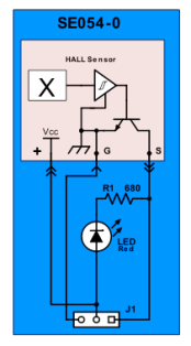

    SALLDHMF wrote:
    Byle the sensor did not give 3.8V output, and this information is on the
    page.
    This voltage is due not to the properties of the sensor itself but only to the fact that on the module the sensor output is connected to +5V via a resistor and an LED (red), which has a drop in the conduction direction of 1.2V (hence 5V-1.2V=3.8V).
    But don't worry about that, as this module needs to be modified slightly for your purposes anyway.
    Here is a schematic of this board, labelled SE054 by the vendors (used for both linear and digital sensors). Below, in digital sensor configuration (for linear sensors, the board is the same, only the resistor and LED spaces are vacant):
    How to count pulses from HAL AH49E sensor in Arduino for CNC? .
    source: http://www.okaauto.com/HallSensorD.html .
    Here you can also clearly see where this 3.8V is coming from.
    For your needs, you just have to remove this LED and to one of the solder fields of this LED (the one that is connected to the resistor) add a wire that goes to 3.3V.
    And a schematic will come out exactly as I drew earlier. Where the high state will be equal to 3.3V.
