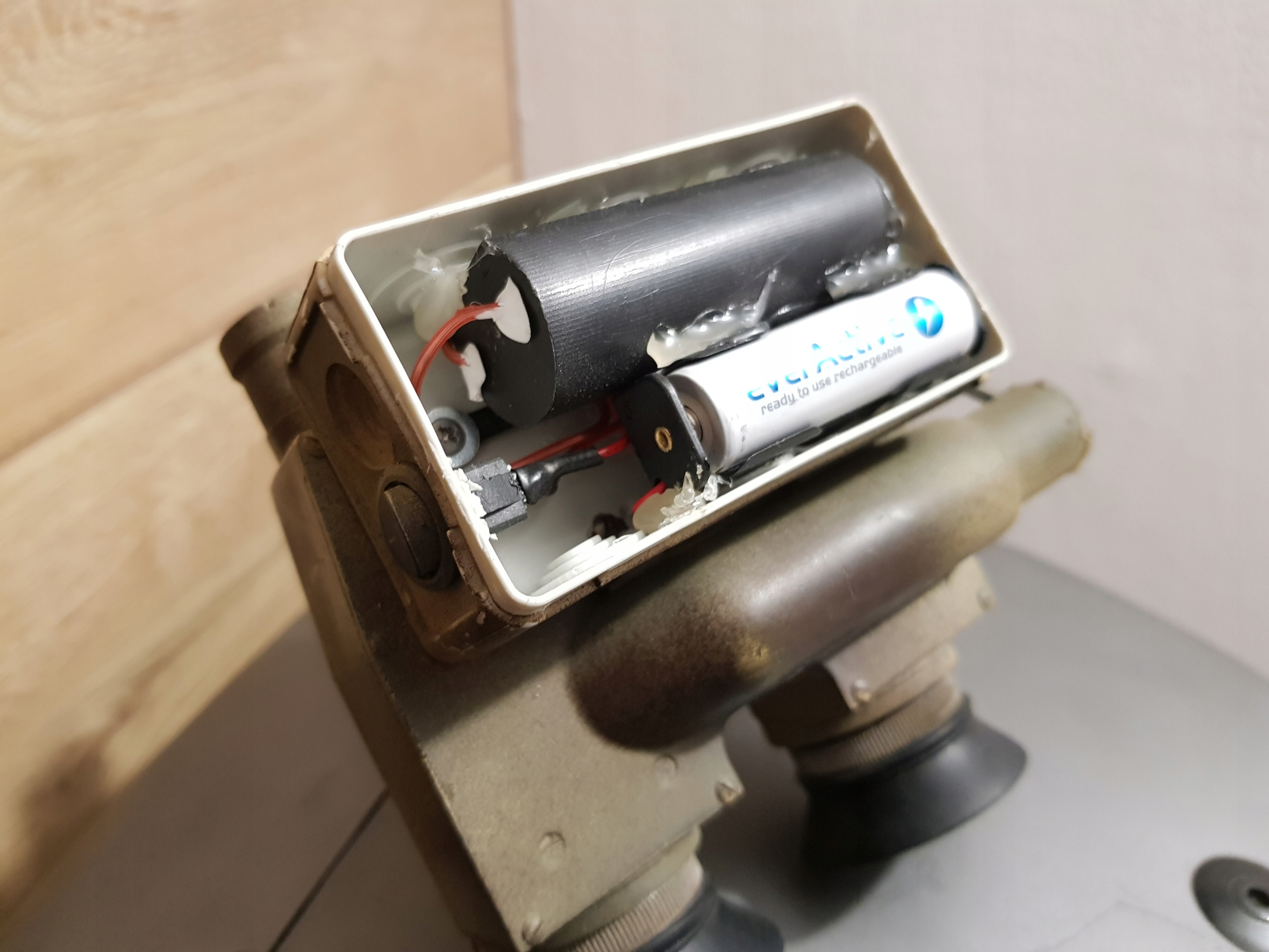

  • #14 15126084
    krakowmichal
    Posts: 6
    I took some photos for those interested.
    https://photos.google.com/share/AF1QipOvHikPh...g?hl=pl&key=NG9aLW9kYnI2VY01rdaRmUhkaU2Y01rda
    In the light well I use an IR power diode controlled by attiny13 and 3 current stabilizers.
    I can't really get it right. It gets very hot, the power of the light seems quite weak and the source is too far over the visible part. I set the duty cycle to 270 uS for a 300uS period. Only then the parameters of the illuminator allow for effective illumination in complete darkness. Heats up cruelly: /.

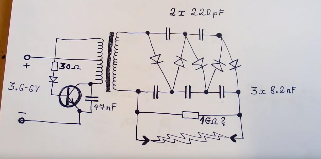

  • #16 17166613
    AlekZ
    Vacuum tubes specialist
    Posts: 2314
    Help: 85
    Rate: 2893
    You can use something like the attachment. You can wind the transformer yourself, but it can be a day of work.

    NiclasLindner
    Posts: 8
    Good evening,
    My name is Niclas. I'm from Germany. Unfortunately, I personally do not speak Polish - that's why I try to be understood by the translator.
    I bought the NS-71 some time ago. So far, everything has worked out. I restored the entire unit. Old paint, rust and new paint removed on it. I've also reworked the lenses. I built a thick lipo-battery into the power supply.
    Countless hours ... we figured it out and suddenly ... Is High voltage blocking the mind ... Otherwise you'll just hear ... monotonous clattering, suddenly there was always a short interval with a loud bang. So I turned it on, checked it out.
    and had to create an almost 1.5 cm arc between two Find points in the wiring. Every 2-3 seconds it could be seen through transparent plastic. My original idea for parts may be able to fix faded parts quickly - all parts are encased in some kind of transparent silicone.
    My idea was now to build a new high-voltage block. On the internet, like here, you can find some drawings and plans. I am only afraid that dangerous voltages will be discharged there, which may be dangerous for me.
    How exactly did you do it? And is it possible to write a step-by-step guide for a layman like me?
    My idea was a circuit like this: Ne555-Timer Stun Gun with 20kV
    Does something like this work? How would you calculate the capacitors for a multiplier?
    Does anyone know the electricity consumed by these two pipes?
    It would be a pity if the device stopped working just because of this = (
    You are my only hope in this regard.
    Hope my message is a bit understandable.

    In my experience, a simple self-drilling converter on one transistor with a voltage multiplier is enough. I probably have the same type of night vision device (such "binoculars" with an additional illuminator. In my opinion, the sensitivity of the transducers is not too high. Tomorrow I will post a diagram.

  2. Maintain capacitor-to-diode orientation identical to the previous stage.
  3. Re-check output; each stage raises peak DC by the AC input amplitude [Elektroda, krakowmichal, post #15028993]
Can I drive the stock transformer with an NE555?
Yes. Set NE555 as astable at 20 – 30 kHz, 50 % duty. Use a power BJT or logic-level MOSFET plus snubber across primary. dj_volt revived a dead PNW-2 this way [Elektroda, dj_volt, post #15045636]
What is the purpose of the shielded HV cable?
The inner core carries +14–19 kV; the braid is ground, forming a coax that keeps stray fields away from optics and your hands [Elektroda, Mcrash, post #20880714]
Is it safe to run the converter on 12 V instead of 6 V?
No. Doubling input doubles flyback energy and can punch through aged silicone, causing shorted tracks and smoke [Elektroda, NiclasLindner, #18862344; Elektroda, jta, #18861941]. Limit supply to 6 V or redesign the transformer.
