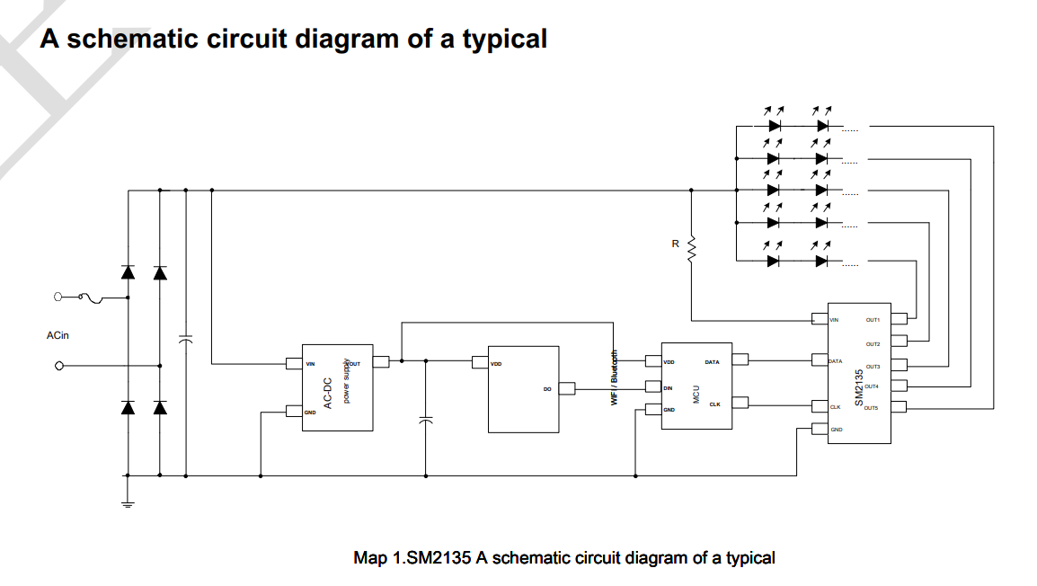

    The MiBoxer FUT035s+ series operates on 12-24V and controls brightness via PWM, and does not limit current. It is used in conjunction with LED strips.
    Your LED panel has a 230V power supply in its specification, which means there is only some (unspecified what) inverter in it, probably a DC one, and this is no longer specified by its specification.
    I'm unlikely to have seen an LED panel that has a 12V/24V LED strip hidden inside it running on constant voltage....
    Well I don't know if that would work, but surely the first step here would be to carefully open up your LED panel and see what LED circuitry is in there, but I doubt it would match up.
    I've shown on the forum a bit of RGBCW and similar lamps with WiFi control and there are usually DC dedicated drivers there, such as the SM2135:
    Schematic circuit diagram of SM2135 with LED elements .
    They already have a PWM input to control from the MCU, it is possible that there is something like that in your lamp but without PWM input, so you won't control it from the Miboxer....
