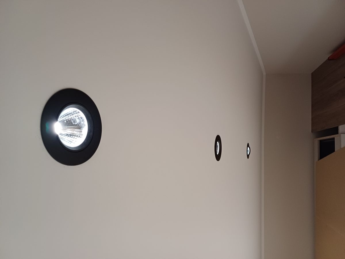

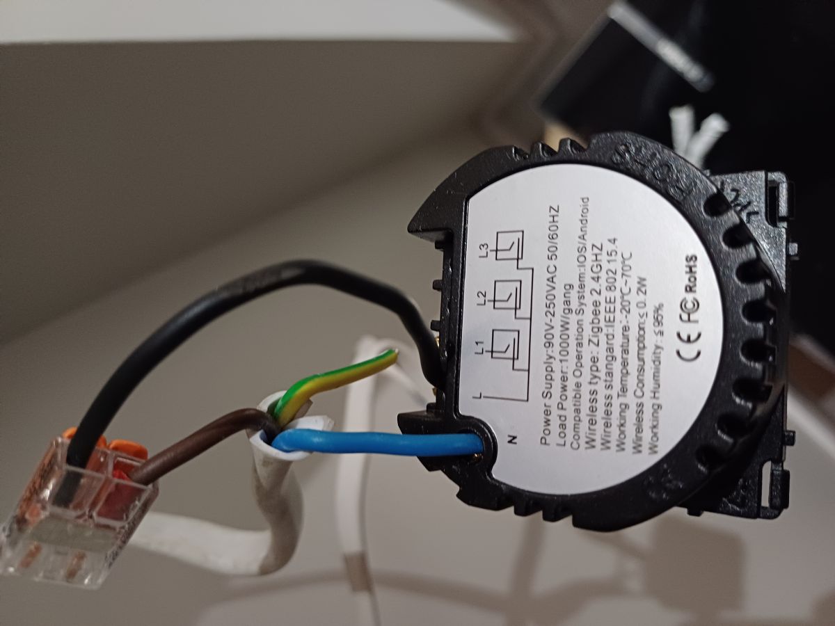

    Zigbee switch 1 gang connected to 3 LED bulbs - the problem is that the bulbs lightly all the time and when switched on, the brightness only increases slightly. Without the Zigbee switch the lamps shine strongly.
    Three LED bulbs integrated into the ceiling, emitting dim light.
    Zigbee 1 gang switch with connected electrical wires.

    Wrong connection.
    Should be ->L supply line to the device, and L1 from the device to supply the LED circuit.
