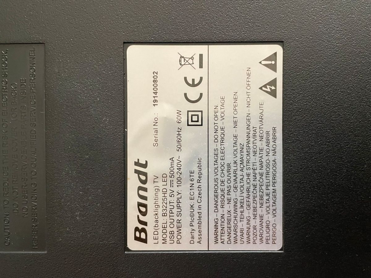

    Nameplate of a Brandt TV with technical information and safety warnings.

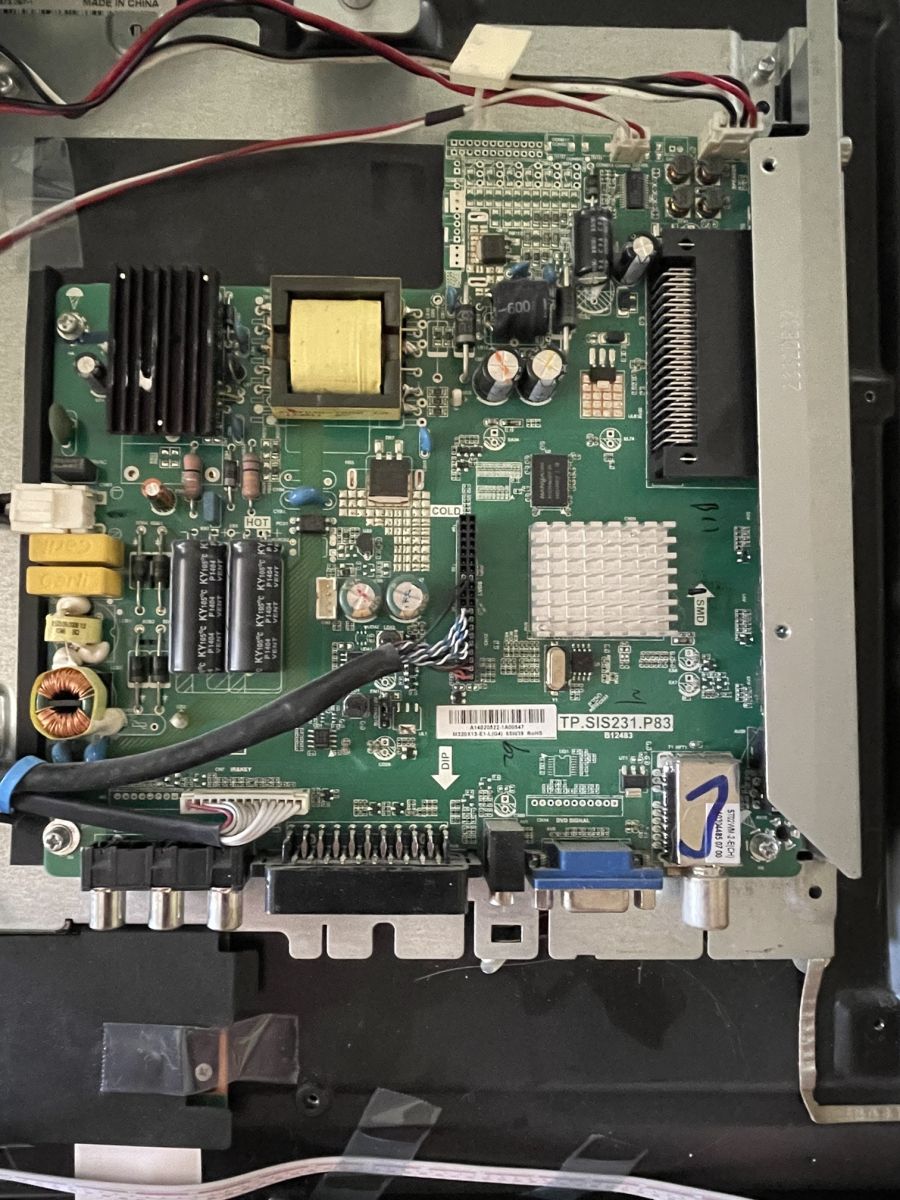

    Section of a green printed circuit board with electronic components, barcode, and TP.S label.
    Mainboard of an LCD TV or monitor with various connectors and electronic components.

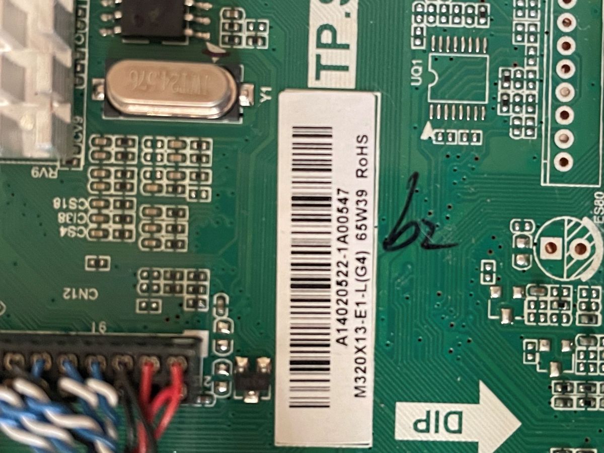

    Hi,
    Please help, my BRANDT B3225HD LED TV restarts indefinitely on the BRANDT logo
    thank you

    here is the usb recovery file for
    model BRANDT B3225HD LED
    main TP.SIS231.P83
    panel M320X13-E1-L(G4)
    copy the file SISEU23X8M.bin on an empty usb stick
    unplug the power cord
    insert the usb stick and reconnect the power cord
    look at the standby led, at the beginning it flashes slowly, after about 1 minute it doubles the speed, update completed
    unplug the power cord and the usb stick
    reconnect the power cord and turn on the tv: it will start in first installation mode
    if it doesn't work with usb recovery, spiflash is damaged
    replace it with a new one and program it using the file SISEU23X8M.bin

    Thank you billobirillo for your prompt reply and the recovery bin file,
    I have tested to flash my TV and unfortunately no flash, no blink LED.
    So I suppose my TV SPI flash is damaged, so next step is to buy and change my chip.
