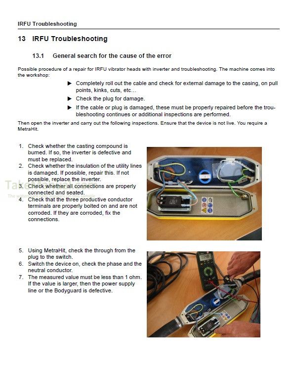

    Wacker Neuson IRFU 58 Concrete Vibrator Stops After 30 Seconds—Possible Causes and Schematic Request Wacker Neuson IRFU 58 concrete vibrator defect
    The concrete vibrator starts, and after 30 seconds will stop. What can be the defect?
    I've bought second hand, and it works 2 times, and after that, doesn't work anymore.
    It has frequency converter inside.
    I have the belove Repair Manual !
    Wacker-Neuson IREN IRFU 38 45 57 65 Repair Manual Internal Vibrator
    https://takemanual.com/product/wacker-neuson-...-38-45-57-65-repair-manual-internal-vibrator/
    The LED light it's ON in Bodyguard , that means the Bodyguard it's OK ?
    5100002788 Repair kit connector set (Bodyguard)
    Repair kit connector line IRFU
