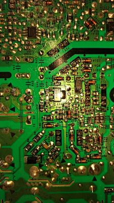

    [Hello
    I have a problem with the Hilti C4 / 36-350 charger, viz. The charger blinks green every 2s and does not charge. No reaction to plugging in the battery.
    Hilti C4/36-350 Charger Issue: Green LED Flashing Every 2s, Battery Not Charging Hilti C4/36-350 Charger Issue: Green LED Flashing Every 2s, Battery Not Charging

    It blinks continuously without a battery or with a battery. The description on the charger shows that it should glow after turning on the power. Does anyone have any schematic? Or someone had a similar problem?
    On the board, I noticed a burned path and jumper J3 with a 0R resistor. Same problem after replacing this item. Before the relay on the capacitors there is 19.5V after turning on the power.

    How did you diagnose it? Which layout in the first photo?

    I have repaired this type many times, first see why it burned the path and what it powers.

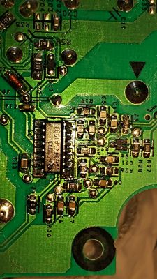

    From what I saw, it powers the 10pin IC1 L6599AD
    10pin is gnd from what I invented in the technical data of the system. I picked up the chip because it has a 45R short circuit between the 10th and 12th pin. The system probably controls the Q3 transistors,
    Q4 12NM50ND
    I think 45R on the power pins is checked on a raised chip. This is a bit too little resistance. Can you write what else could go in turn?

    Measure the tension on pins 10-12.

    There is no short circuit on the soldered ones. The values seem similar on both.
    Relative to the 3-legged plus.
    First transistor:
    minus on 1pin 757mV
    minus on 2pin 423mV
    Second transistor:
    1pin 707mV
    2pin 403mV
    Can I do it without a deal? Because I don't want to put it back in if it's supposed to be short-circuited.
    Added after 3 [minutes]:
    What voltage should there be because I connected directly to the desoldered 5V 10pin- 12+ system and takes 190mA from the workshop power supply

    The circuit probably fell from too high a supply voltage above 17V, see the circuit on page 30 where it is implemented through a stabilizer on the transistor.
    A similar solution may be here.
    It takes so much because it has a short circuit of the internal stabilizer.

    Remember to run on the service power supply by checking the oscillograms on the oscillator transistors.

    You supply the system directly from the power supply, and from the 230V network, before soldering the system, you must check the voltage on the leg 12. If you do not check it, the new chip may go away.

    Ok, I should pick up 12pin and give it what voltage? Isn't it better to put a zener diode at maximum voltage?

    You can insert a 9 to 16V zener diode at 16V later, but I suspect that there is a voltage stabilization system there and if it is out of order, it may still damage the system.
    Check if it is realized through Q6 transistor.

    From what I can see the voltage goes from transistor Q3 BCP54 Through the 10R resistor
    It is controlled by IC2 MIP2M2
    It can be, as "Shon" wrote, that he will be wasted. If so, it is no longer worth fixing it. I will try to run on the new one what the short circuit does and I will know because the second system costs about PLN 50
