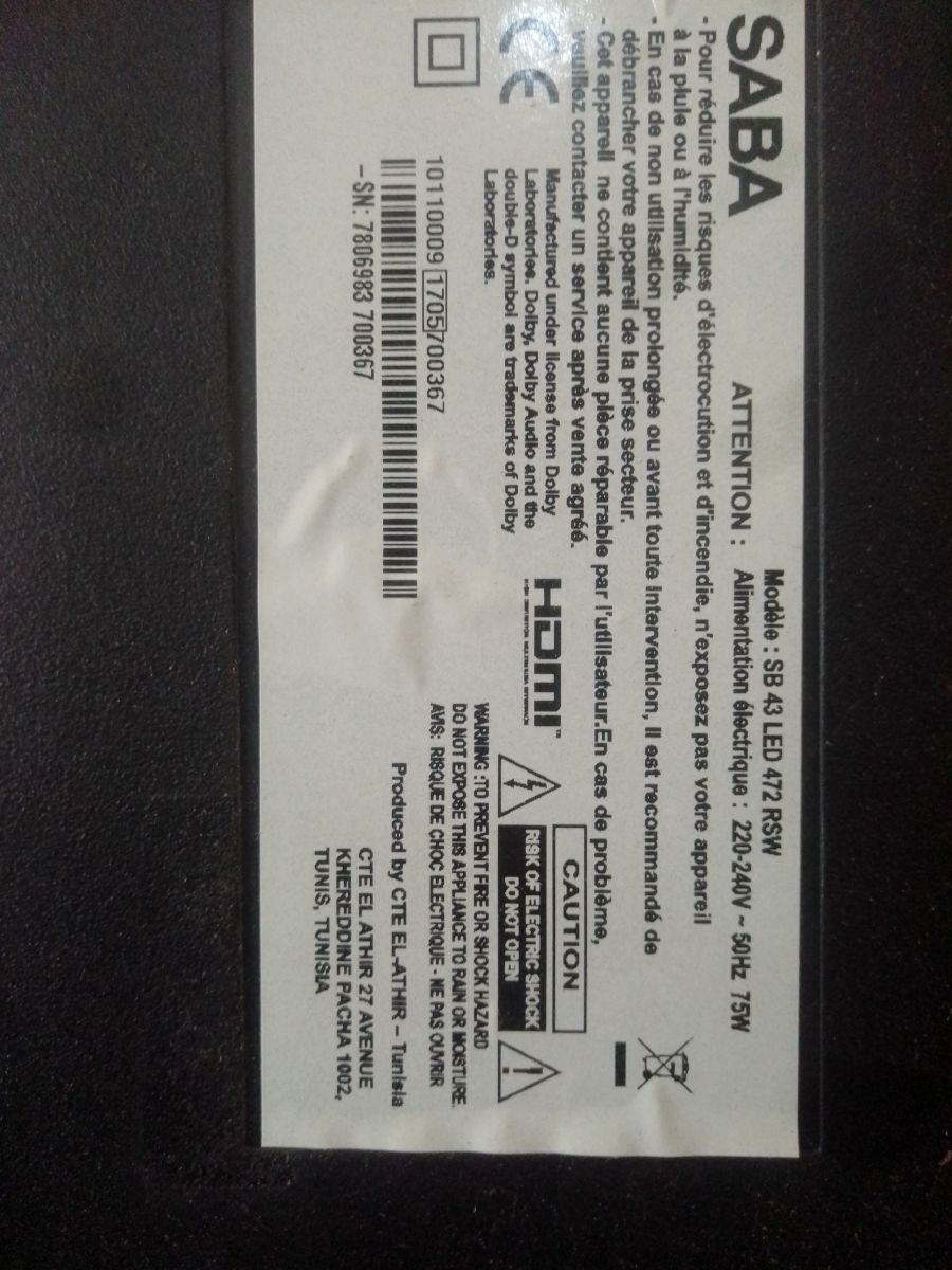

    are you sure about the model?
    post a photo of the sticker on the back of the tv: product code and serial number required

    USB NAND Firmware for SABA43LED472RSW 17MB97 VES430UNDL-2D-N12 Request
