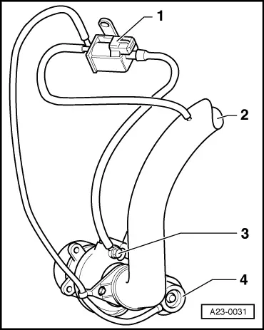

    Hi there I'm looking for a complete Vacuum System diagram of Golf 4 Tdi 1.9 AGR engine
    AI: Could you please specify the year of your Golf 4 TDI 1.9 AGR?
    2000
    AI: Are you looking for the vacuum system diagram for a specific reason, like troubleshooting a problem or doing a modification?
    I replaced my AHL engine with the AGR engine so it seems like the vacuum systems are different
    i only have a diagram of the AHL engine so I need the AGR engine's diagram

    Is the turbo not working?
  • #3 21612260
    ahumeniy
    AGR turbo is controlled with boost pressure, not vacuum unlike the ALH. Don't connect any hose from the vacuum system on the turbo system. This is a common mistake because the engine looks a lot like the ALH and mechanics often connect it like on the ALH (happened to me a lot of times, every time I have to fix it after a mechanic messes with the system)

    That's all I have found, in the manufacturer language. Let's hope it will help a little.
