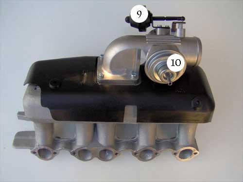

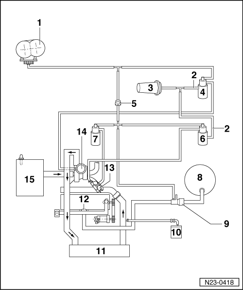

For the ACV/AJT/AUF/AYY/AYC vacuum layout, connect the hoses as 8→1, 6 and 3→2, 7→9, and 4→10; if needed, swap 6 with 7 for the valve that closes the intake flap during engine shutoff [#6817835] No. 12 is the vacuum line from the vacuum pump to the brake servo, and No. 8 gets a short hose with a small air filter attached [#6797546] The small grey sensor takes one hose from the vacuum supply (a tee can be used) and the other hose to the intake closing flap on the manifold/black box [#6797546]

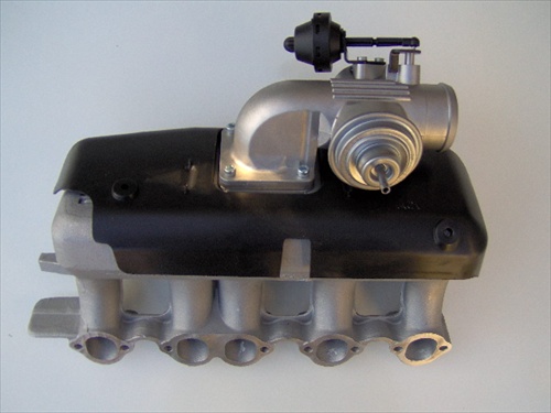

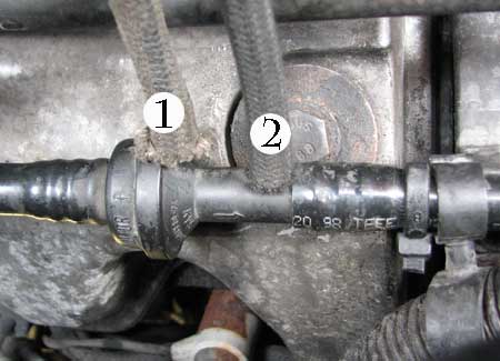

    I have a problem with connecting the hoses coming from the turbo to the... I have a problem with connecting the hoses coming out of the turbo to... exactly where they should go in the version I have under the intercooler there is an EGR with an attached pump (please see photo). Please help and thank you in advance.

    I know it sounds strange but I'm already sure it's the ACV, can I ask for a complete diagram of how all the vacuum hoses should be connected, i.e. those from the plastic hose that goes from the servo to the vac pump, then at the top it looks to me like there are three outlets, there's also one coming out of the EGR and there's a small grey sensor from which there are also two hoses coming out.
    Best regards and thanks in advance for your help.

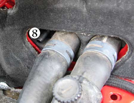

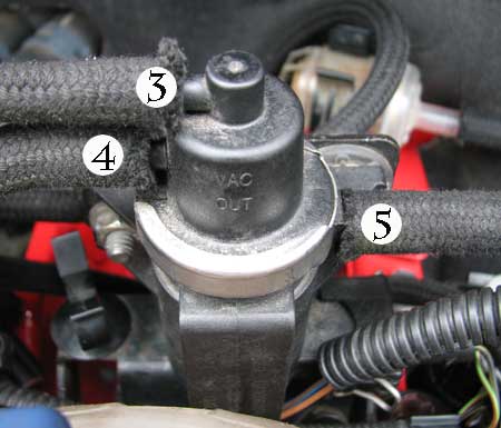

    But just to be 100% sure because I am really a beginner I am attaching the original pictures from my engine, can I ask for help like.
    connect valve 1 to 5 etc.
    In my version there is also a small valve sticking out from the wall behind the engine visible in the attached photos no.8
    Greetings

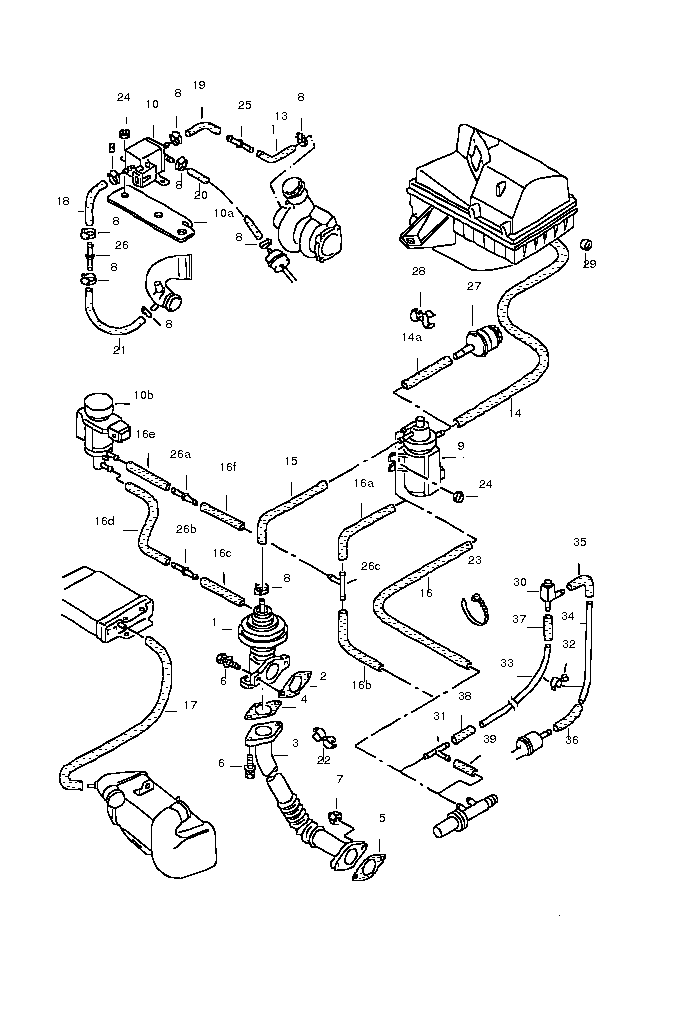

    Dalton33 wrote:
    I know this is going to sound weird but I'm already sure it's ACV or I can
    At last this sounded correct and something can be answered.
    I attach a picture of the vacuum system for engines
    2.5ltr. diesel eng.: ACV,AJT,AUF,AYY,AYC
    Turbo to Intercooler Hose Routing on VW T4 Transporter 2.5 TDi 2003 with EGR Pump .
    (corrected)
    There is free access to similar images at
    http://www.vagcat.com after free registration on the parallel forum.

    Well, yes, but again I emphasise I am a complete beginner and from this diagram it seems to be for all versions, which for AVC I have no idea again please how is it possible to describe the connection according to the attached pictures above e.g..
    1 connect to 8 etc.

    It couldn't be clearer. If that's not enough then give the car to a mechanic.

    Can I ask someone knowledgeable to take a look at the pictures I have uploaded above and tell me which valve should be connected to which.

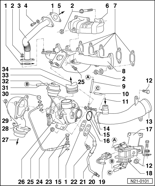

    I don't have a picture of the turbocharger because there was a diagram above and I already have it well connected
