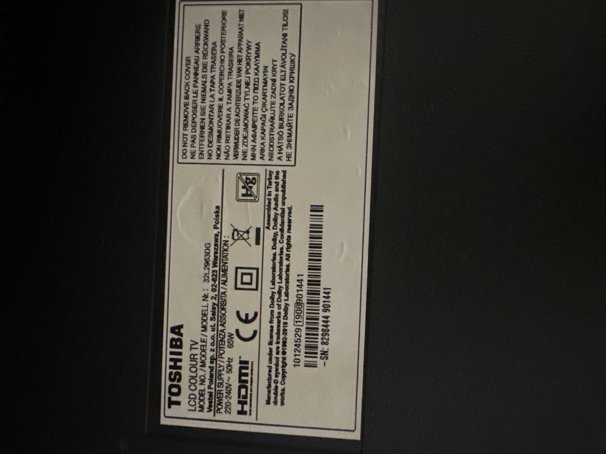

    Hello dear friends, I have a small problem, help me, in short, a Toshiba 32l2963DG TV with a 17MB211S motherboard and a VES315UNDB-2D-N21 panel. In short, the reason is that its native motherboard burned out, I went to an online store and bought a new one without noticing that it was for a Hyundai FLR32TS
    Information label on the back of Toshiba TV model 32L2963DG 439SMART TV. I wanted to ask or maybe help how I can run this motherboard on a TOSHIBA TV, maybe with some firmware, because I've tried a lot of things, nothing helps, and I don't have the software itself.

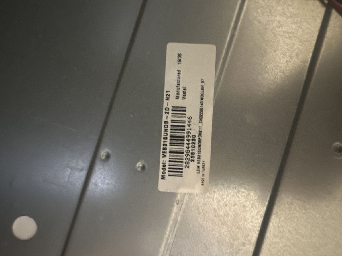

    Label on LCD panel with model VES315UNDB-2D-N21 and serial number.

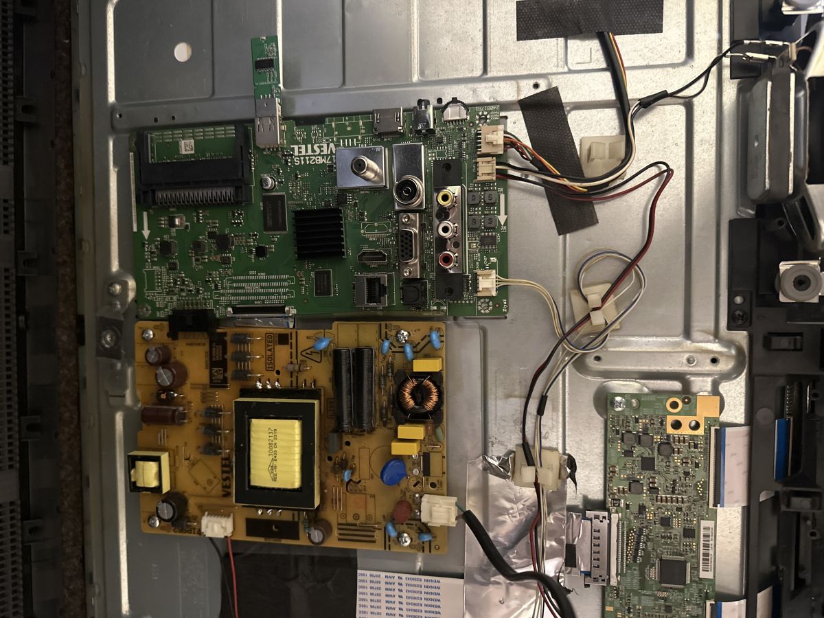

    Mainboard 17MB211S and power supply mounted inside LED TV casing

    You have installed the Hyundai motherboard in your TV. To install the software, you need the OK key on the remote control to be active. It is possible that the Toshiba remote control is not compatible with the Hyundai (different code). Below is the software for your TV. If you cannot install it, look for a Hyundai remote control. Link valid for 2 days. You try at your own risk.
    https://files.fm/u/dkmpvsdbcv
    L.E.
    Hyundai FLR32TS = 17MB211S panel VES315UNDA-2D-N21
    If you have image problems, tell me and it will be solved much more easily.
    Only if the remote control is active.

    Ok, but is it possible to do it so that the TV does not have to be flashed on Toshiba but left on Hyundai (I just want the TV to start and it to show a picture) and about the remote control I have a universal remote control that is flashed well in order to flash the remote control I need it to at least give some signs but so only the green-yellow indicator lights up, only through the motherboard itself it reacts to something like something tries to turn on and back the indicator is green-yellow
    Added after 1 [hours] 13 [minutes]:
    In short, I flashed your firmware using the universal remote — it worked, but now only the green indicator light is on. There’s no image, nothing, and the device no longer responds to the remote, not even the universal one. The only way to turn it off is through the motherboard, but even then it doesn’t really shut down — it just shows a yellow-green indicator.
