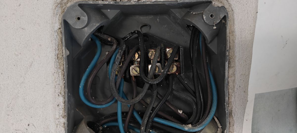

    And I have this question for you: I need to get the power out under the shed. And consequently, which wire to choose. As far as I can see, I have 4x wires from this box and I just don't know what thickness it is (photo). In addition, what socket needs to be connected to this force so that I can hook up a compressor, pressure washer. The protection I have is C20.
    Interior of an electrical box with four-core cables connected to a terminal block. .

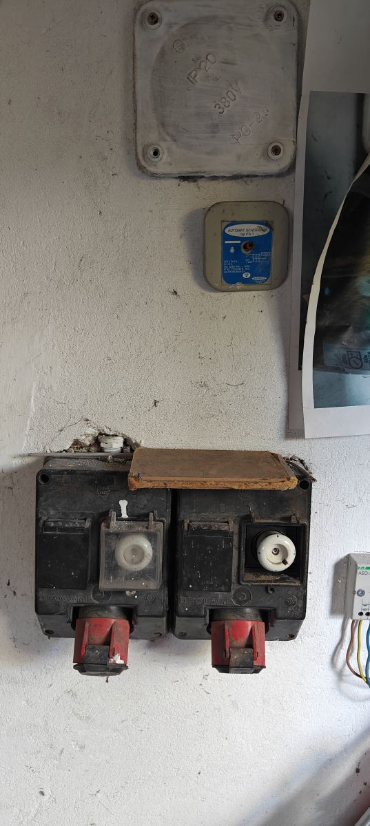

    From the top left corner, the wires come out of the switchboard. Whereas on the left bottom and right side down are the wires going to the power sockets. (Photo)

    The thickness of a conductor, or rather its cross-section, as in the power industry the dimension of a conductor is specified in mm2, cannot be determined from a photo. This can be done by measuring the bare conductor with a comb or calliper, or (most simply) by comparing a piece of conductor to a suitable conductor with a known cross-section.

    Ok. Then I'll measure with a caliper and let you know. Because I was thinking of stepping into the shed of such a building switchboard. Admittedly, I only need a 230 volt socket, but I don't think it's possible to connect the wires from this switchgear as in the wall under the same 230 volt sockets.

    It's probably worth having power in the garage, but if a 230-volt socket is all you need then you can only do that too.

    The fuse you have is a C20, which means the fuse trip current is 20 amps. If you don't have a differential, and I see an old installation, it may be that the protection is too high. You need to take measurements of the short-circuit loop impedance to find out if such protection will work. You need 4 mm² conductors for this 1.45 × 20 = 29 A protection.
