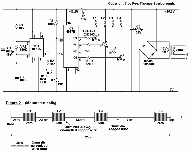

Recommended Enamelled Copper Wire Gauge for NE555 4017B Magnetic Coil Gun?

    Giacinto Lombardi
  • Outdated coil gun design needs regulated supply and flyback protection
    #2 21657791

    Giacinto Lombardi
  • Lower voltage needs thicker wire and fewer turns
