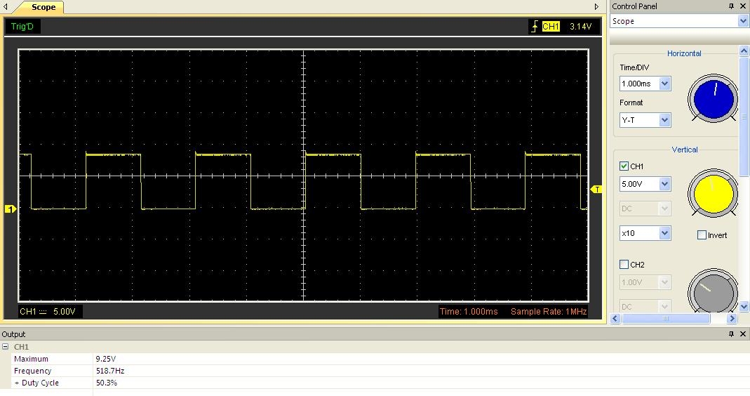

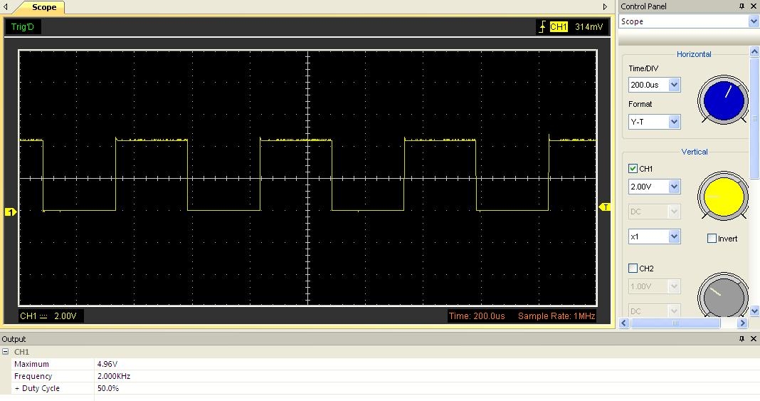

    Below are a few waveforms with different power values.
    Description of the square wave generator based on the NE555 chip Description of the square wave generator based on the NE555 chip Description of the square wave generator based on the NE555 chip Description of the square wave generator based on the NE555 chip Description of the square wave generator based on the NE555 chip Description of the square wave generator based on the NE555 chip Description of the square wave generator based on the NE555 chip Description of the square wave generator based on the NE555 chip Description of the square wave generator based on the NE555 chip Description of the square wave generator based on the NE555 chip Description of the square wave generator based on the NE555 chip Description of the square wave generator based on the NE555 chip Description of the square wave generator based on the NE555 chip Description of the square wave generator based on the NE555 chip
    It can be seen that the amplitude at the output is almost the same as the supply voltage of the tested generator. You can see that with about 15V power supply, the amplitude at the output was almost that of the supply voltage, so the manufacturer's data is slightly understated - at least in this particular case.
    The filling, which was achieved on the tested generator, is in the range of 30-99% (below 30%, the generator output shows a low state, setting the filling potentiometer to the minimum value will give us a 99% filling of the course) and you have to wind up a bit to set what we want, because by turning the knob to change the fill, we also change the frequency. We don't have that big problems with the frequency control potentiometer - here the frequency also changes, but only to a very small extent.
    It can also be noticed that the change of the supply level has an impact on the frequency of the generated waveform at the same potentiometer settings, i.e. by increasing the supply voltage, the frequency of the output waveform increases and its filling slightly.
    During the generator tests, it was possible to obtain a higher frequency of the generated signal than specified by the manufacturer, but the higher the frequency, the more distorted the signal becomes.

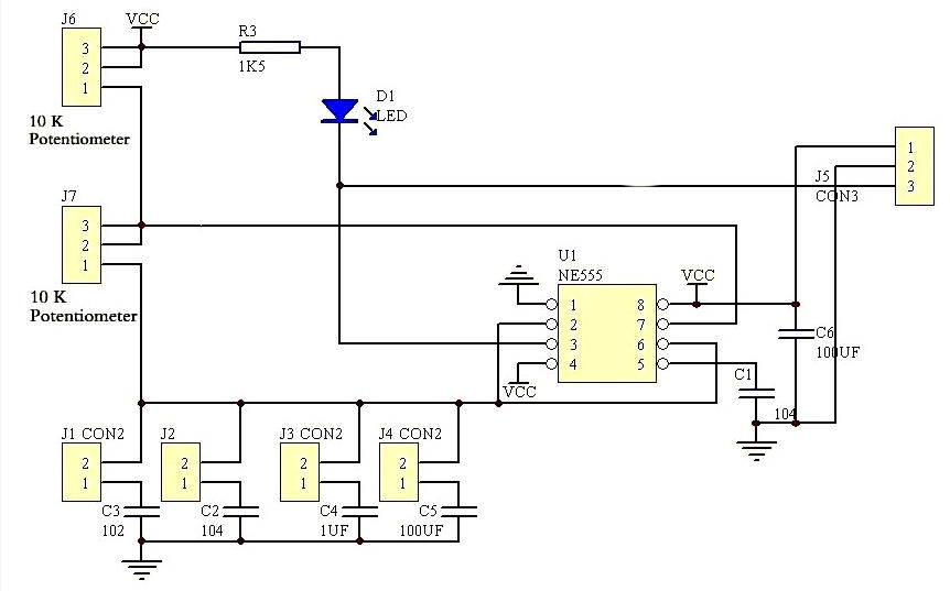

    Can you ask for a diagram of this wonder?
  • #3 16982928
    CMS
    Posts: 8468
    Help: 258
    Rate: 2601
    Why do you need a diagram?
    Ready layout costs much less than if you were to buy each item individually.
    However, if you have all the components in the proverbial drawer, the diagram can be found in the 555 catalog note.

    Scheme:
