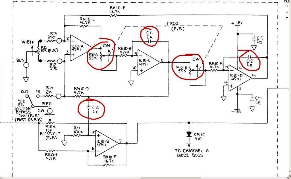

How to calculate resistor and capacitor values for UREI 546 parametric EQ band frequencies?

  • Need the original band-pass filter equations

  • Spreadsheet values still don’t match original EQ formulas

  • Bypass every stage with 0.1 µF capacitors

  • Seeking bandpass gain equation for state-variable filter

The discussion focuses on calculating resistor, capacitor, and potentiometer values for modifying the band frequencies of the UREI 546 parametric equalizer. The original UREI 546 schematic is referenced for cloning and modification purposes. Contributors note the complexity of deriving exact expressions for component values specific to this circuit, as standard active filter formulas do not directly apply. The frequency of each band can be approximated by the formula f = 1/(2πRC), where R ranges approximately from 4.7kΩ to 55kΩ and C defines the central frequency capacitor. Additional insights include the importance of bypass capacitors (Cd and Ce, typically 0.1µF, 25V rating) for noise reduction and op-amp stability. The gain control equation for the bandpass filter remains a point of inquiry. Several external resources and filter design documents were shared, though none perfectly match the UREI 546 values. The discussion highlights the challenge of adapting the original design to different band counts and frequency ranges while maintaining performance.
