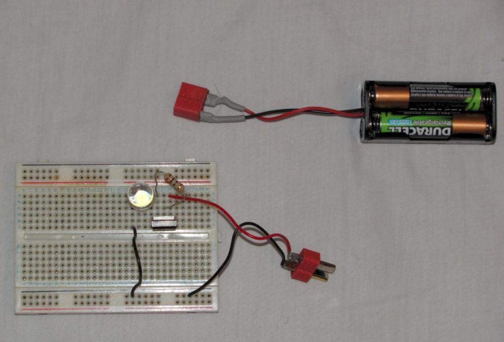

Why is an LM317 current regulator giving only about 0.73 V between ADJ and OUT and making an LED dim when powered from a 5.3 V battery pack?
Your LM317 is falling out of regulation because the supply voltage is too low for a current-source setup. In this configuration you need the LED forward voltage plus the LM317's 1.25 V reference across the sense resistor plus the regulator's dropout voltage (about 1.5 V or more), so a 3 V pack or a weak 5.3 V pack is not enough [#21660775][#21660773] When there isn't enough headroom, the ADJ–OUT voltage drops below 1.25 V, the LED current falls, and the LED looks dimmer; the large voltage dropped across the LM317 is normal once it is regulating [#21660784][#21660786] The fix is to use a higher input voltage or a low-dropout/switching current regulator, and keep the LED current within its rating [#21660775]

  • LM317 needs more than 3V battery supply
    #2 21660775

  • Insufficient supply voltage caused LM317 dropout
    #11 21660773
    Christopher Telford
  • LM317 current regulator needs 1.25 V across adj-out
    #12 21660784
    Steve Lawson

Why is Vadj–Vout only 0.73 V on my LM317 current regulator?
Your supply is too low for regulation. The LM317 must maintain 1.25 V between OUT and ADJ. If input voltage is below VLED + 1.25 V + dropout, the reference collapses and you read ~0.73 V. The LED current also falls, so it looks dim. “The fact that you are measuring .73 volts… is because there isn’t enough overall voltage.” [Elektroda, Steve Lawson, post #21660775]
How much input voltage do I need to drive a 3 V LED at constant current?
Budget input as VLED + 1.25 V (sense) + dropout. With a 3 V LED and typical dropout 1.5–2.35 V, you need about 5.75–6.6 V. If you run near the margin, small battery sag can break regulation. That is why a 3 V pack fails here. [Elektroda, Steve Lawson, post #21660775]
