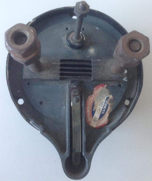

  • Testing meter resistance and adding a shunt resistor

  • Possible ex-Marconi marine surplus with shunt needed

  • Shunt-based test to identify meter movement type

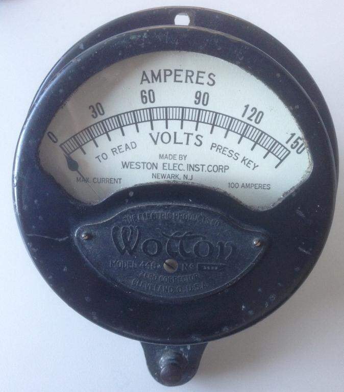

The discussion centers on identifying and testing an old analog panel meter, model 448, approximately 9 cm in diameter, found among vintage equipment. It is suggested the meter may be a military surplus or marine radio ammeter, possibly from Marconi, used to measure current in battery or engine charging systems. The meter likely requires a shunt resistor to extend its current range, as indicated by a visible shunt on the back. Testing involves measuring the meter coil resistance with an ohmmeter; an open circuit indicates a faulty meter, while very low resistance suggests the presence of a shunt or damage. Functional testing can be done by applying a low voltage source in series with a potentiometer to adjust current and observe needle deflection, then calculating the appropriate shunt resistor value using Ohm’s law to scale the meter for high current measurement. The meter movement type can be inferred from the scale linearity: linear scales indicate a moving coil meter, while nonlinear scales suggest a moving iron ammeter. The discussion also touches on the historical and collectible value of vintage electronic components such as thermionic valves and mercury switches with bakelite insulators.
