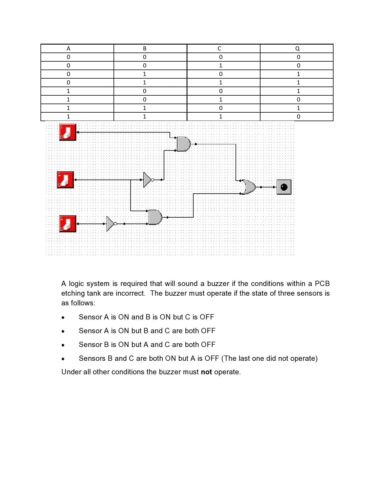

how can i adjust this logic Diagram to operate in all the above conditions ? When B,C are ON and A o

  • Buzzer logic for four sensor states
    #1 21678916
    NYAME EPHRAIM MECHANE
  • Boolean equation and simplification approach
    #2 21678917
    Elizabeth Simon
  • Boolean minimization from the truth table
    #3 21678918
    Max Maxfield
  • #4 21678919
    Rick Curl
  • Unlabeled inputs identified as a, b, and c
    #5 21678920
    John Beetem
  • #6 21678921
    Max Maxfield
  • #7 21678922
    Max Maxfield
  • #8 21678923
    Max Maxfield
  • #9 21678924
    Max Maxfield
A logic system is required to activate a buzzer under specific sensor conditions in a PCB etching tank. The buzzer must sound when: (1) Sensor A and B are ON while C is OFF, (2) Sensor A is ON with B and C OFF, (3) Sensor B is ON with A and C OFF, or (4) Sensors B and C are ON with A OFF. The Boolean logic expression derived is A·B·¬C + A·¬B·¬C + ¬A·B·¬C + ¬A·B·C, which can be simplified using Boolean algebra. The truth table confirms these conditions, and the logic function can be expressed as q = a & ~c | ~a & b or in Verilog as q = a ? ~c : b. Correct labeling of inputs in the logic diagram is critical, with the middle input as A, top as B, and bottom as C. Implementation suggestions include using Karnaugh maps for simplification and employing multiplexers, such as 8:1 multiplexers, to realize the logic function efficiently.
