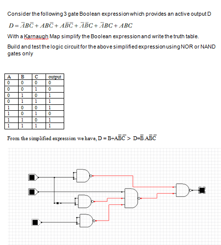

Hi, i need someone to check if i build this nand circuit correctly with regards to the Boolean expre

  • Truth table has an error; use 7442 and 7430

  • Truth table error in NAND logic expression

The discussion centers on verifying the correctness of a NAND gate circuit implementation relative to a given Boolean expression and its associated truth table. It was identified that the truth table contains inconsistencies, specifically a mismatch between the number of terms in the Boolean expression and the output lines marked as logic high. The input labeling on the circuit diagram was requested for clarity. Participants emphasized the importance of reconciling the Boolean expression with the truth table before further circuit validation. The use of Karnaugh maps was recommended to simplify and verify the logic function, with a suggestion to convert the resulting AND-OR expressions into NAND-only implementations as an exercise. References to TTL logic components were made, including the 7442 BCD-to-decimal decoder with active-low outputs and the 7430 eight-input NAND gate, as potential hardware solutions. Additional resources on implementing logic functions exclusively with NAND or NOR gates were shared to aid understanding and design accuracy.
