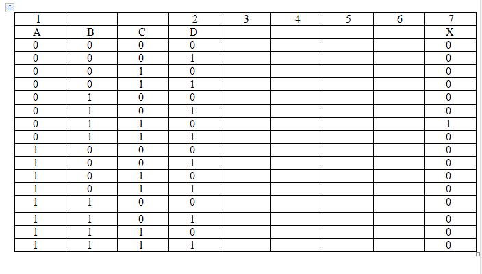

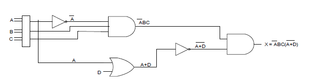

how can the Boolean expression be given marked at each stage inside the 16 row truth table ?

  • Label truth table columns with each gate equation
    #2 21679067
    Elizabeth Simon
  • Step-by-step guide to truth tables
    #3 21679068
