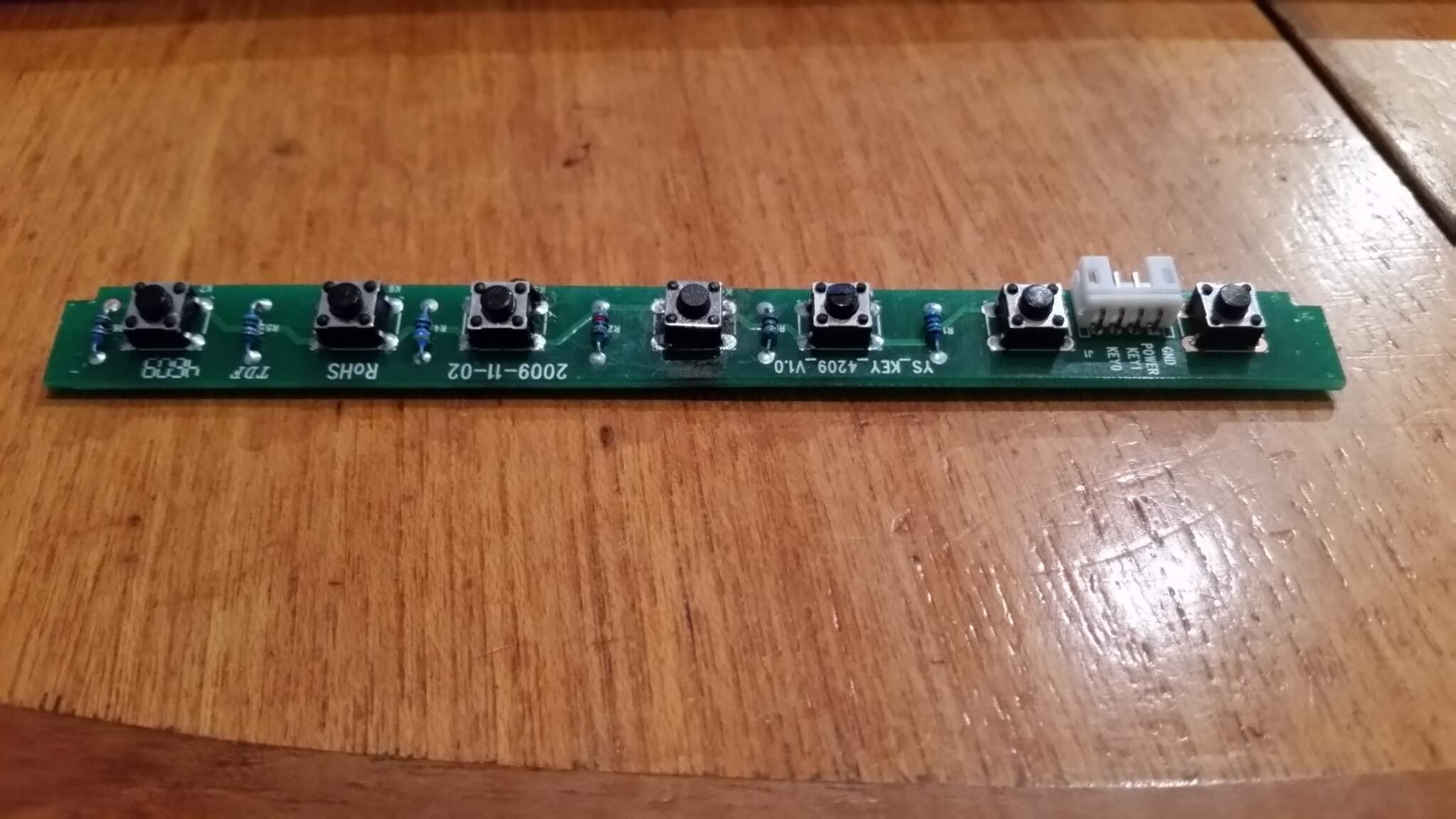

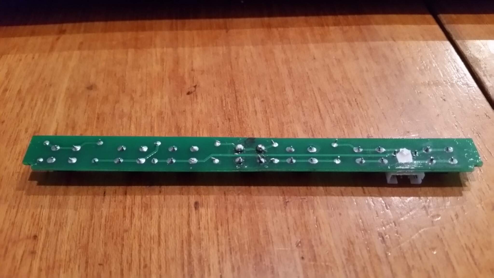

PCB from a TV – button acting as though it’s depressed, yet isn’t
246 7
  • Suspect shorted button trace or input line
    #1 21679552
    Nathan King
  • Check switch contacts and resistor ladder voltages
    #2 21679553
    David Ashton
  • Suggest checking the TV circuit and model-specific fixes
    #3 21679554
    David Ashton
  • Contact cleaner may fix intermittent switch faults
    #4 21679555
    Aubrey Kagan
  • Button matrix resistance readings and contact cleaner test
    #5 21679556
    Nathan King
  • Suggest measuring key-pin voltages in circuit
    #6 21679557
    David Ashton
  • Request for clarification on in-circuit key pin measurements
    #7 21679558
    Nathan King
  • #8 21679559
    javier Gwinn
A TV's channel down button on its PCB behaves as if continuously pressed despite no physical depression. The button was replaced and the PCB cleaned with compressed air and contact cleaner, but the issue persisted. Multimeter tests showed normal resistor values and button resistance dropping to zero when pressed, indicating the switches function correctly. The PCB uses a resistor ladder or voltage detection method across multiple buttons without an IC. The problem likely lies in the PCB output voltage on the key line to the TV, causing the TV to register a false button press. Suggestions include measuring voltage on each key pin with the PCB connected to the TV, thoroughly cleaning with specialized contact cleaner (e.g., Servisol), retinning solder joints, and inspecting for faulty traces or connections. The white adhesive on connectors is likely factory-applied glue and not the cause. The issue is isolated to the PCB as disconnecting it stops the automatic channel down behavior.
