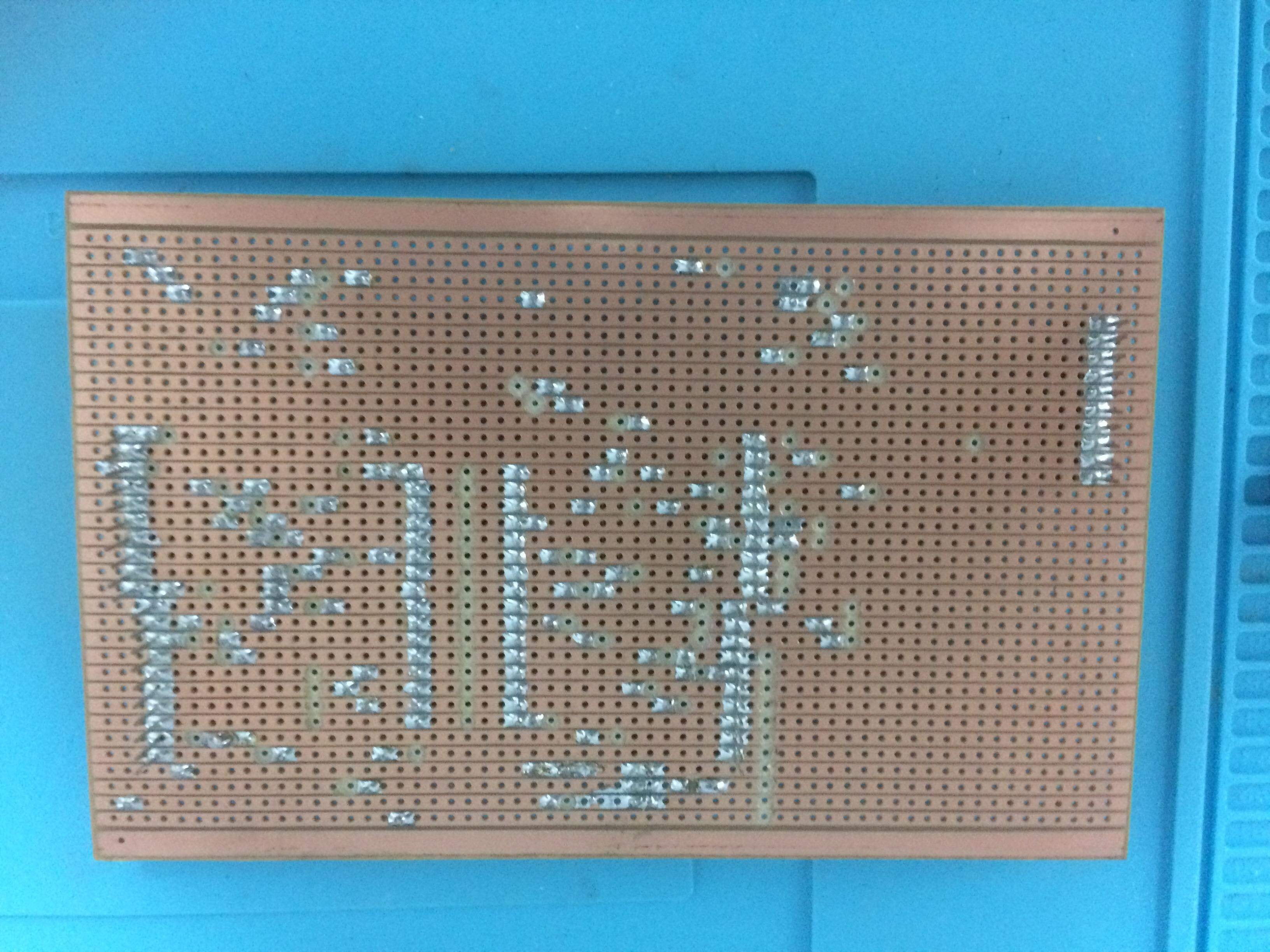

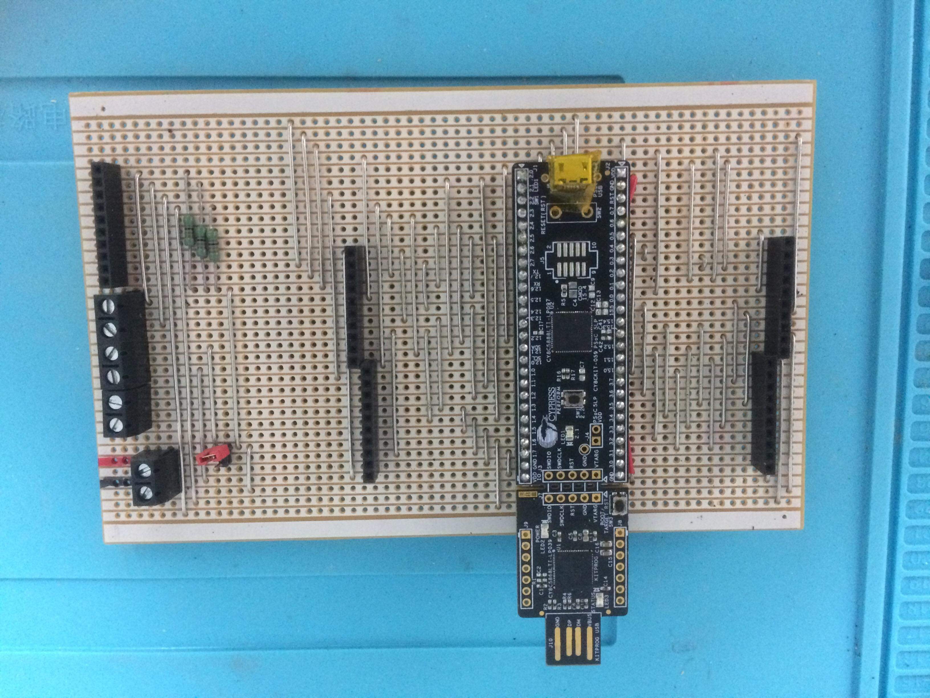

Reliable vertical stacking connectors for Arduino shields with 0.5 MHz signal integrity
312 6
  • Seeking reliable low-profile stacking connectors for Arduino shields
    #1 21679922
    Conrad Mannering
  • #2 21679923
    Elizabeth Simon
  • #3 21679924
    Conrad Mannering
  • Use bottom-mounted plugs or flat cable to reduce wear
    #4 21679925
    Aubrey Kagan
  • IDC ribbon cable as a reliable alternative to stacking connectors
    #5 21679926
    Conrad Mannering
  • Use blank pass-through boards as sacrificial buffers
    #6 21679927
    Aubrey Kagan
  • IDC ribbon cable chosen as low-cost stacking solution
    #7 21679928
    Conrad Mannering
