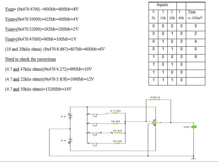

Hi, please i need to know if the calculations for this summing amplifier is correct

  • Watch units and keep original resistor values

  • WolframAlpha for checking amplifier calculations

  • Binary-weighted input resistors needed for accuracy

  • Correcting DAC summing amplifier calculations and notation
