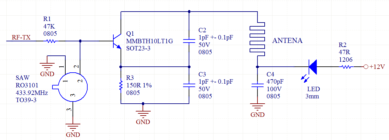

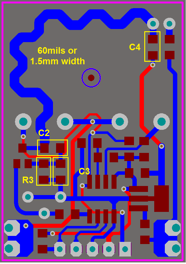

Cheap RF 433.92MHz design, PCB track antenna, values of capacitors
513 10
How can I choose the best C2/C3 values and antenna layout for a 433.92 MHz PCB transmitter to maximize range?
You probably should not try to calculate a single “correct” C2/C3 value; the practical approach is to keep C2 = C3 and tune them experimentally for maximum received signal. [#21682149][#21682148] Those capacitors are critical in the Colpitts oscillator, so changing them can upset the circuit. [#21682149] The receiver’s linear output on pin 3 can be used as a relative signal-strength meter while you move the transmitter or swap capacitor values. [#21682148] For the antenna, keep the same general loop shape as the original if you are copying it, or make it larger while preserving the trace length; the “wiggles” are mainly there to fit the needed length into the available space. [#21682152] On FR-4 with dielectric constant around 4, the wavelength at 433.92 MHz is about 346 mm on the PCB, so your trace is electrically short and should be treated as an inductive/matching problem. [#21682156] Keep ground plane around the oscillator components but clear it back near the antenna, and if possible use a proper whip wire or a transmitter module instead of relying only on the PCB trace. [#21682156][#21682149]

  • Experimentally tune C2 and C3 for maximum signal

  • Antenna should be fed through matching components

  • PCB antenna layout and matching component tuning

  • Recommend replacing PCB loop with whip antenna

  • Keep loop shape and account for PCB dielectric constant

  • Starting capacitor value and antenna length calculation for 433.92 MHz

  • Tune antenna track and C5 to 433.92 MHz
