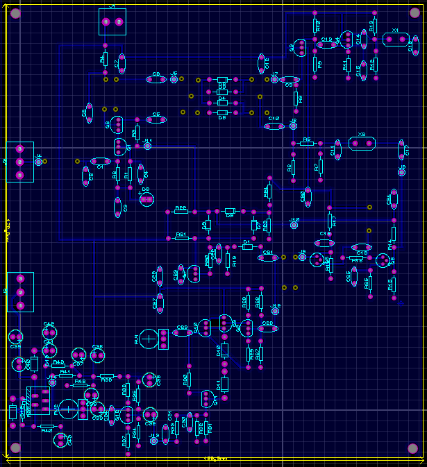

AM Radio Receiver IF Board PCB Layout Feedback and Suitability for Didactic Use
372 11
Is my AM receiver IF PCB layout suitable, and what are the best ground-plane, trace-width, and trace-length practices for it?
Yes: for this kind of discrete-transistor, through-hole IF board, a two-sided PCB with the component side as a solid ground plane and all traces on the solder side is a sensible layout, and a 4-layer board is not necessary [#21684145][#21684148] If you want separate power and ground planes on adjacent layers to maximize capacitance, that requires a 4-layer PCB, but for your circuit a supply trace can work if you place bypass capacitors to ground with very short leads and track lengths at each supply point [#21684148] For one-off prototyping, you can even use ugly construction on one-side unetched copper-clad board and treat the unetched copper as the ground plane [#21684148] AM-broadcast transistor radios at 455 kHz were commonly built on single-sided PCBs without ground planes, so your design is well within the range of simple construction methods [#21684145] One reply also asked to confirm the schematic, since 10.7 MHz is an unusual IF for an AM receiver [#21684149]

  • Recommend two-sided PCB with ground-plane component side
    #3 21684145
    PeterTraneus Anderson

  • Bypass capacitors can replace a supply plane here
    #6 21684148

  • Separated front end and IF boards for review
    #10 21684152
    Daniel Pintescu
