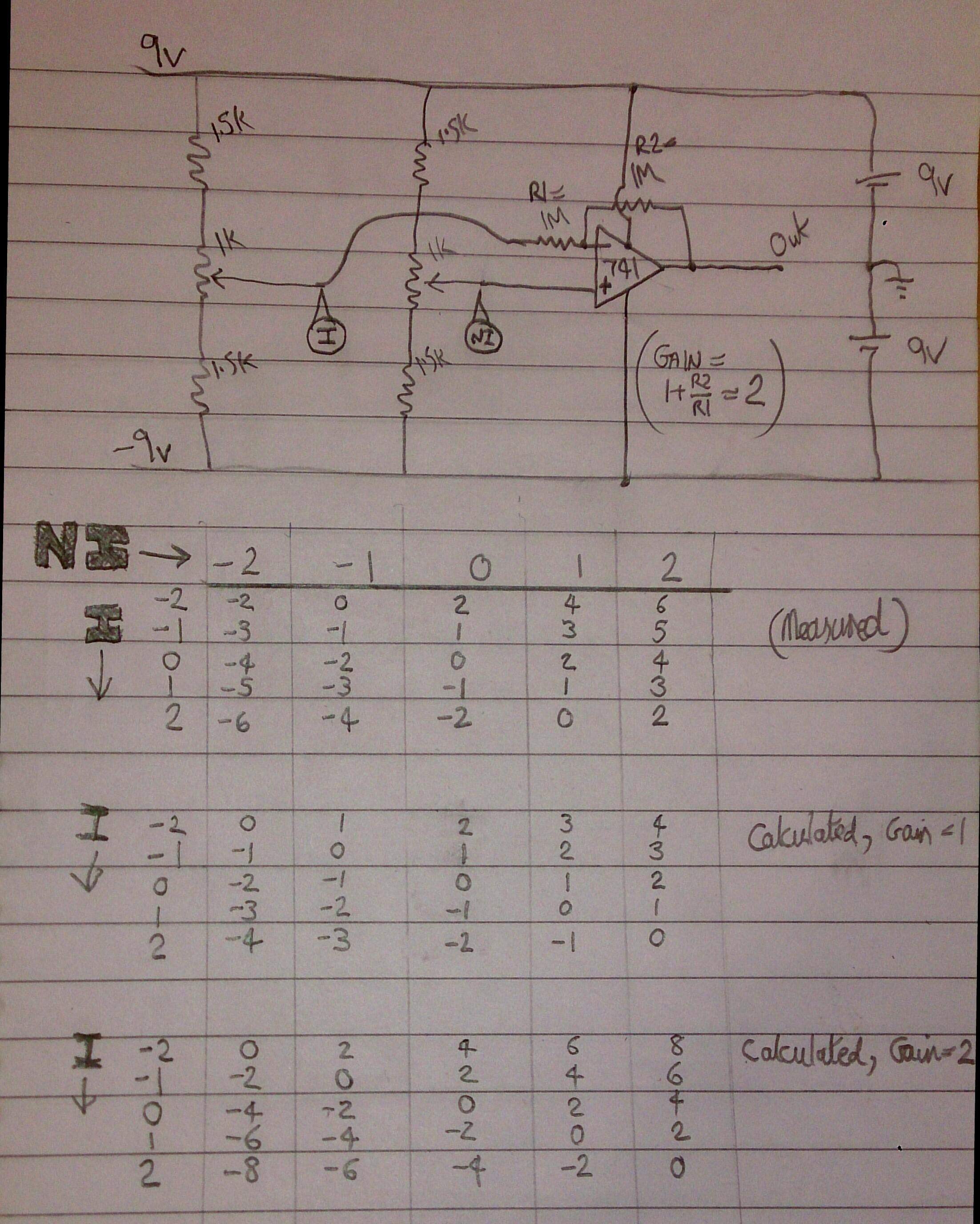

OpAmp Output Not Matching Expected Gain 2 With ±9V Supply and Dual Pot Inputs

  • Requesting explanation for unexpected op-amp gain behavior

  • Missing divider on non-inverting input causes wrong gain

  • Recommend standard op amp configurations and virtual earth concept

The discussion addresses confusion about an operational amplifier (op amp) circuit powered by ±9V with dual potentiometer inputs and an expected gain of 2. The user observed output voltages that did not match the anticipated gain calculations. Clarifications explain that the gain from the non-inverting input (NI) to output is 1 + R2/R1 = +2, while the gain from the inverting input (I) to output is -R2/R1 = -1, consistent with the measured results. The circuit resembles a difference amplifier but lacks the correct resistor configuration, particularly the voltage divider on the non-inverting input, causing unexpected output behavior. Recommendations include using matched resistor values (e.g., R1 = R2 and feedback resistors equal) as per standard difference amplifier design, referencing authoritative sources such as the Wikipedia difference amplifier article and George Clayton's "Operational Amplifiers" textbook. Additional advice suggests practicing with standard op amp configurations (inverting, non-inverting, differential, summing amplifiers) on breadboards or simulators to build foundational understanding. Resources like Electronics Tutorials and webinars on op amp parameters (input offset voltage, CMRR, input bias current, noise, zero-drift vs. standard precision amplifiers) are recommended for deeper learning.
