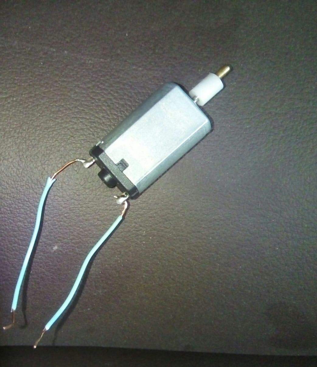

How can I run a 1.2V DC hair trimmer motor smoothly from a 12V charger, and what components should I use?
Use a regulator to drop the 12V supply to about 1.25V; the simplest suggested solution is an LM317 in a TO-220 package with the proper resistor setup and a heatsink [#21683031] A series resistor such as 8.2Ω/2W can work as a cheap fix, but it will dissipate nearly 2W as heat and may get very hot, so it is only a compromise [#21683031][#21683035] The reason the resistor solution is imperfect is that the motor load changes: it needs more current at startup and under heavy cutting, so too much resistance prevents starting while too little lets the voltage rise when unloaded [#21683033] A switching regulator is the better technical solution because it is more efficient, and prebuilt modules in the Recom R78 series were suggested; they accept about 5V to 30V input and come in outputs down to 1.8V, with 0.5A or 1A versions [#21683033] If needed, a diode in series can drop about 0.6V from such a module toward the desired 1.2V [#21683033]

A user seeks to power a Kemei hair trimmer's 1.2V DC motor, originally running on a 1.2V 600mAh battery, using a 12V charger. Direct connection to 12V, 5V, or 3.3V supplies causes the motor to pulse or the power supply to cycle on and off, while a 3.7V 18650 battery runs it smoothly. The user successfully ran the motor on a 5V/2A adapter with an 8.2Ω 2W resistor in series to reduce speed, but this resistor solution dissipates significant heat and is unreliable under load, causing startup issues and polarity sensitivity. Recommendations include using a voltage regulator such as the LM317 linear regulator to provide a stable 1.25V output, though it also dissipates heat and requires a heatsink. Switching regulators offer efficient voltage regulation with less heat but are more complex and costly (around $6.64), which may not be economical compared to replacing the trimmer. The motor's pulsing and startup difficulties are attributed to its varying load and overcurrent protection. The user plans to order LM317 regulators and build a DIY heatsink to implement a more stable power supply solution.
