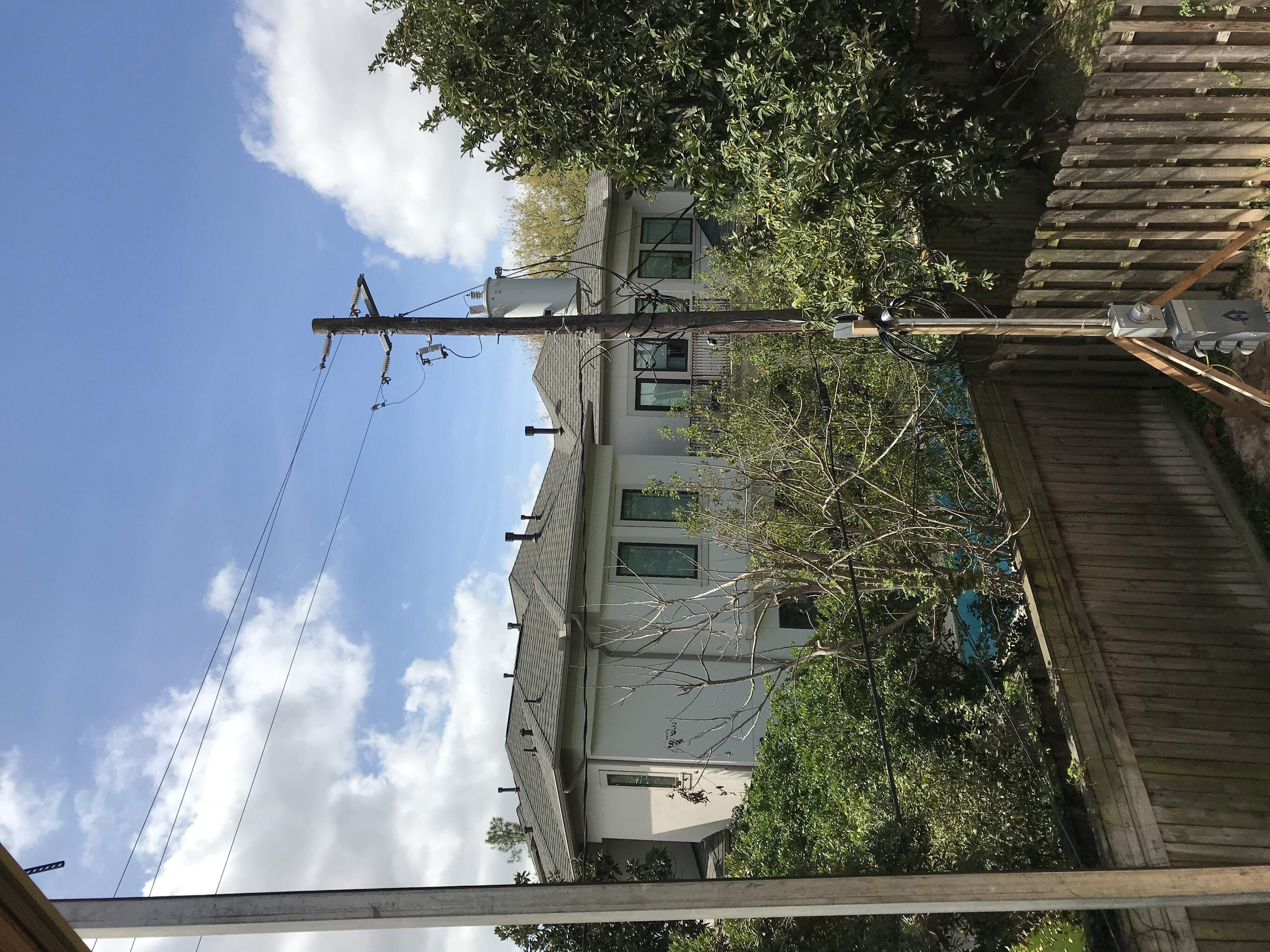

Are the primary wires on a residential electric pole all energized, or are unused ones neutral, and can the utility remove or move them to meet clearance requirements?
On a typical residential 3-phase primary line, the conductors are energized “hot” even if only one phase is actually feeding the transformer at that pole; the other phases are still powered, just unused there [#21684133][#21684141] One reply also noted the pole appears to be a 3-phase, 4-wire setup, not a neutral-only arrangement [#21684135] The utility may leave the other phase wires in place for future use, so removing or consolidating them is not something you can assume will happen [#21684141] Insulating primary high-voltage wires is probably not practical and is unlikely to be the cheapest option [#21684141] For siting a building, the utility easement will likely control the allowed clearance more than whether the line is currently using all three phases [#21684140]

  • Residential primary wires are usually energized phases
    #10 21684141
    Andy I
In residential electric distribution, all overhead primary wires atop poles are typically energized "hot" conductors, even if only one phase is connected to a transformer and others lack hot clamp connections. The presence of insulators on all three wires indicates they are energized phases in a three-phase, four-wire Wye system, with one phase supplying the transformer and the others potentially reserved for future use. Neutral conductors are usually separate and located lower on the pole. Temporary setups, such as construction poles with meters mounted on the pole rather than the house, may show single-phase connections with unused phases still energized. Power companies maintain easements and often retain all three phases for load balancing and future expansion, making removal or consolidation of unused phase wires uncommon and potentially costly. Solutions like installing Aerial Bundled Conductors or insulating wires are possible but require utility company approval. Transitioning from temporary to permanent installations typically involves relocating meters to the house and possibly connecting additional phases. The complexity of removing unused phases depends on utility policies and infrastructure requirements.
