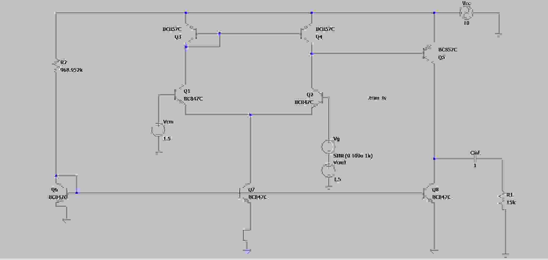

How to Choose R2 and Cinf for Av=1500 in LTSpice Amplifier Simulation (Vcc=10V, R1=15k)
339 18
How do I set R2 and Cinf in LTSpice to obtain a gain of 1500, measure gain and distortion correctly, and reduce the amplifier gain without changing R1, R2, VCC, or VCM?
To get Av = 1500, sweep R2 in LTSpice until Vout/Vin is 1500, and make Cinf large enough that its reactance is small compared with R1; one suggested value was 10 µF [#21684490] [#21684493] Measure gain as the ratio Vout/Vin using the AC component only, preferably with peak-to-peak values from the waveform cursors, and take the output before Cinf because that capacitor only passes the AC component [#21684481] [#21684483] [#21684490] For distortion, use the FFT display or the .four directive on the output signal [#21684492] Keep vg small enough to stay in the linear region; one reply noted that a 1 V peak input drives the amplifier into saturation, so a much smaller amplitude is needed to minimize distortion [#21684486] If you need to reduce the gain without changing the existing R1/R2/VCC/VCM values, add feedback: put 1 kΩ in series with Q1 base, connect 1,499 kΩ from Q1 base to the collector/output node, add 100 pF from that node to ground for stability, set R2 = 10 kΩ, VCM = 5 V, and Cinf = 10 µF [#21684493]

  • Measure gain with cursors and sweep R2
    #15 21684490
    Giovanni Di Maria
  • #16 21684491
    Robinson-Constantin Chera
  • #17 21684492
    Giovanni Di Maria
  • Feedback-loop design for 1500 gain with 100 pF compensation
    #18 21684493
    PeterTraneus Anderson
