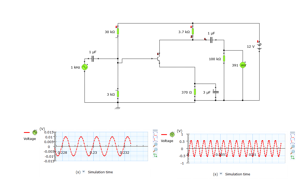

Does this amplifier model achieve a voltage gain of 10 as specified?
375 26
Does this amplifier circuit achieve a voltage gain of 10 as specified?
Yes — after removing the emitter bypass capacitor, the circuit can meet a gain of 10, and the posted output shows about 0.02 Vpp in and 0.2 Vpp out, which is a gain of 10 [#21679167] With the capacitor across the emitter resistor fitted, the AC gain becomes much higher than 10, so the capacitor must be left out if you want that specified gain [#21679156][#21679157] The DC design was described as correct, with the collector sitting around 6 V [#21679157] The effective emitter resistance is about 390 Ω (370 Ω plus roughly 20 Ω transistor emitter resistance), so a 3.9 kΩ collector resistor would give a gain very close to exactly 10 [#21679167] Any DC offset seen in the simulator was likely an artifact, and the output blocking capacitor should prevent offset in the real circuit [#21679168]

The discussion centers on verifying whether a specific transistor amplifier circuit achieves the targeted voltage gain of 10. Initial analysis confirms the DC gain is approximately 10 when ignoring input/output blocking capacitors, but the AC gain is significantly higher due to the emitter bypass capacitor, influenced by the transistor's hFE (165). Removing the emitter capacitor reduces gain closer to the target but introduces DC offset issues in simulation, which are attributed to simulator artifacts rather than circuit faults. The gain is primarily determined by the ratio of collector to emitter resistance, including the transistor's intrinsic emitter resistance (~20 Ω). Adjusting collector resistance to standard preferred values (E12 series) is recommended for precise gain control. Simulation results show input signals around 20 mV peak-to-peak and output signals scaling accordingly, with gains ranging from 10 to over 140 depending on configuration. The use of output blocking capacitors and load resistors helps manage DC offset. The conversation also touches on the importance of understanding fundamental electronics theory (resistance, capacitance, impedance, transistor operation) for effective circuit design and simulation. Additional topics include logic gate simulation and truth table construction, emphasizing self-learning and practical experimentation.

Does this amplifier reach a voltage gain of 10 as specified?
Yes. With the emitter bypass capacitor removed and RC/RE chosen correctly, the thread author measured 0.02 Vpp in and 0.20 Vpp out, giving ≈10× gain without clipping. [Elektroda, Anonymous, post #21679167]
Why was the gain much higher than 10 at first?
The emitter bypass capacitor reduces AC emitter resistance, so the stage’s AC gain rises well above the DC design value. As one expert put it, the AC gain then depends on the transistor’s hFE. [Elektroda, Anonymous, post #21679156]
How do I set the gain to 10 without the emitter bypass capacitor?
Use Av ≈ RC/(RE + re). Estimate re ≈ 26 mV/IE. Example: RE = 370 Ω, IE ≈ 1.3 mA gives re ≈ 20 Ω, so RC ≈ 3.9 kΩ yields Av ≈ 3.9 kΩ/390 Ω ≈ 10. [Elektroda, Anonymous, post #21679167]

How do I deal with DC offset seen in the simulator?
Keep the output coupling capacitor and the load resistor at the output. In the discussed circuit, the DC offset at the load disappears; the tool’s reading was a simulation artifact. [Elektroda, Anonymous, post #21679168]
