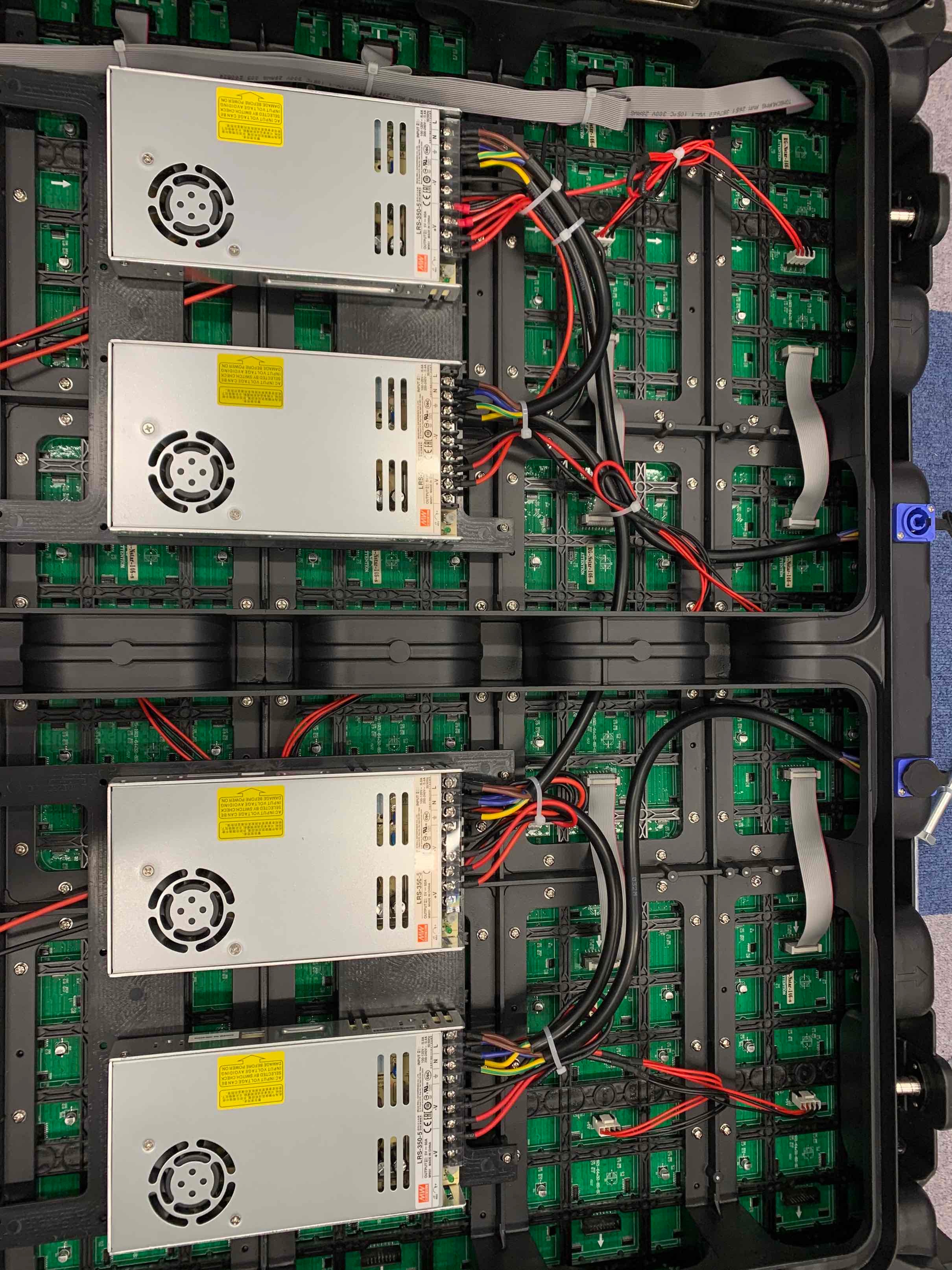

LED Display With 4 Power Supplies: Calculating Total Amps, Wire Gauge, and Connector Rating
243 3
  • Main input likely exceeds 20 amp connector rating
    #1 21685195
    uniopp
  • Input current likely well below 6.8 A per module
    #2 21685196
    Chip Fryer
  • #3 21685197
    uniopp
  • Measure each module’s current draw separately
    #4 21685198
    Chip Fryer
