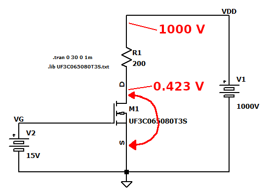

SiC MOSFET 650V Tested at 1000V—Why No Failure or Breakdown Observed?

  • SPICE ignores MOSFET voltage ratings
