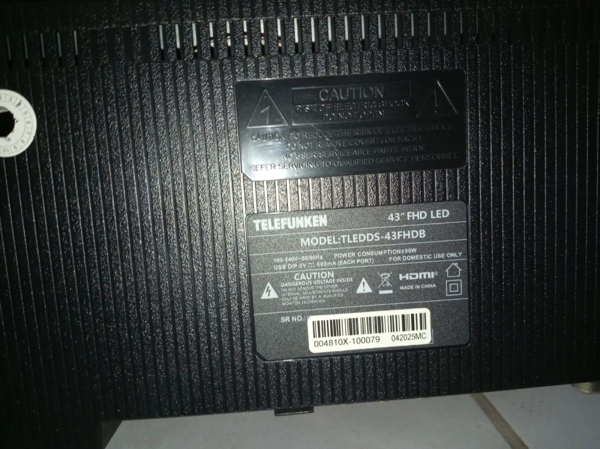

    How to repair smart Telefunken LED TV, model: tledds-43fhdb, if it is stuck on logo
  • #2 21810958

    Can you share the board and panel numbers so we can try to search for compatible software?

    >>21810958 Hi there, this was all I could find: Model: TLEDD-43FHDB Serial number: 004810X-100079
    Not sure if you can assist but I need to find compatible firmware.

    post a photo of the sticker on the back of the tv
    if it's not a Vestel (I suppose), you have to open the tv and post a photo of the mainboard code and a photo of the panel code

    Back label on a Telefunken 43 FHD LED TV with model, power specs, warnings, and barcode

    as I supposed, it's not a Vestel

    Some "thing" from the MSD3463-xxxx series
    or
    Link
    TV Model: CEL-43FHDB-16/1
    Screen Number: VES430UNDS-2D-N11
    Part Number (SKU): 23364424 FOR CELCUS CEL-43FHDB-16/1
    Main: 17MB97
    As mentioned, unscrew the back panel and check the label on the circuit board.
