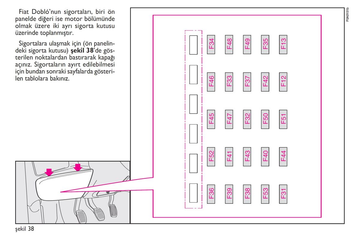

    I have a 2006 Fiat Doblo 1.4. When I lock the doors automatically with the key, the central locking system trips the fuse. I haven't been able to solve the problem.( F38 )
    THANK YOU
    Fiat Doblò fuse box diagram showing layout and labels from F31 to F53.

    See to the wires in the tailgate grommet.
    And the driver's door. Most often the wires break there
