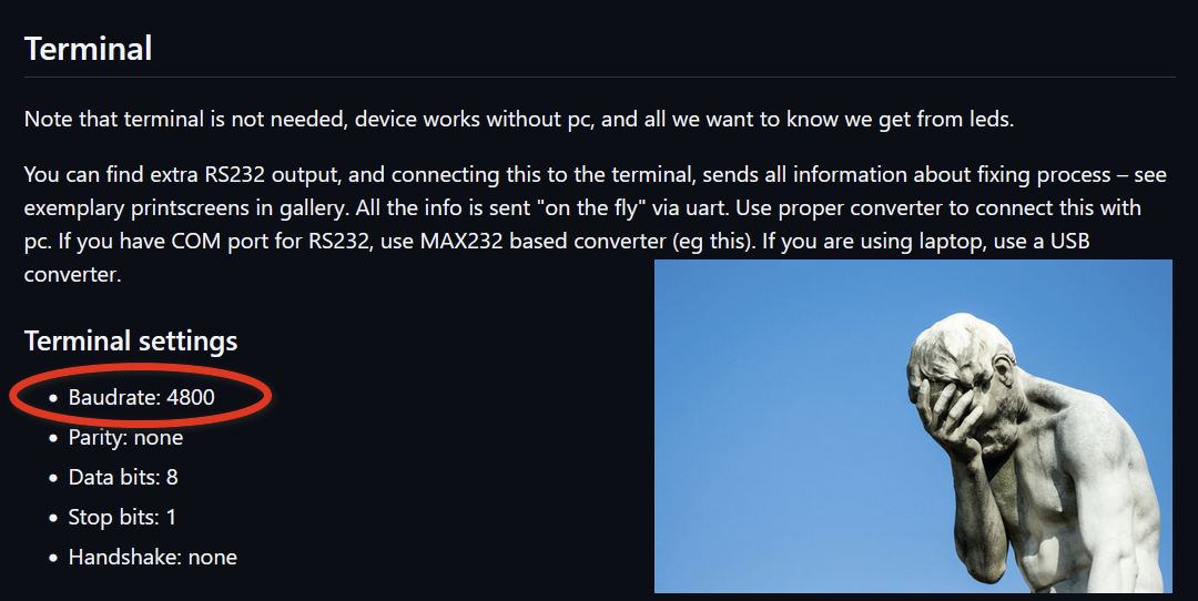

    Hello everyone,
    I have built the version 2.11 of Atmega fusebit doctor with Atmega328P as doctor, firmware like here: https://github.com/SukkoPera/avr-fusebit-doctor/tree/main.
    I have tried to connect it to a serial monitor on my laptop (TeraTerm, Bascom serial emulator and Microsoft serial monitor) on 38400 baud, but no success to obtain the right messages. On Bascom monitor I obtain a long series of "C" each time I press the start button, on TeraTerm a long series of "diamonds". I have tried to connect only the TxD from doctor and both TxD and RxD, but same thing happened.
    I do believe the PCB circuit is ok, as I have revived 7 Atmega8.
    Please help.
    Added after 6 [hours] 30 [minutes]:
    Issue solved, it works at 4800 baud.

    Terminal settings with Baudrate: 4800 circled and a sculpture doing a facepalm .
  • #3 21715623
    robinn123
    Modified the baud rate at 4800 (COMx,8, N,1).
