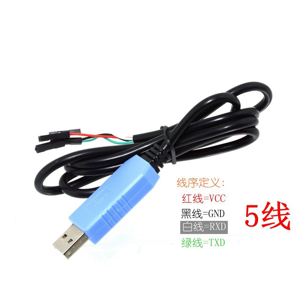

    I Have AVATTO Wall Light switch with CB3S .
    I Connected everything correctly and run the GUI flasher, but always get the "Failed to set baud rate!" error.
    Tried 115200, 921600, 1500000 speeds. No luck.
    FTDI Drivers are up-to-date.
    Already flashed lot of ESP with this FTDI. without any issue.
    TX <-> RXD1
    RX <-> TXD1
    5V(Downgraded to 3.3v) <-> 3.3
    GND <-> GND
    Everything is soldered straight to the CB3S .
    (bkWriter 1.6 is also not working)
    This is my FTDI Device:

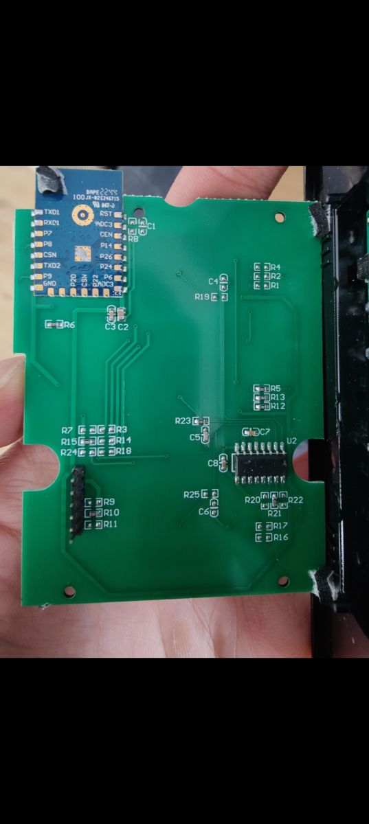

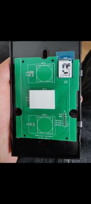

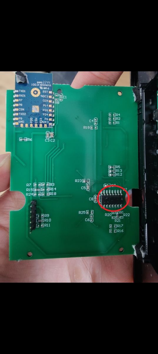

    This is my PCB both sides:
    Fix Failed to Set Baud Rate Error: AVATTO Light Switch, CB3S, GUI Flasher, FTDI Device Fix Failed to Set Baud Rate Error: AVATTO Light Switch, CB3S, GUI Flasher, FTDI Device

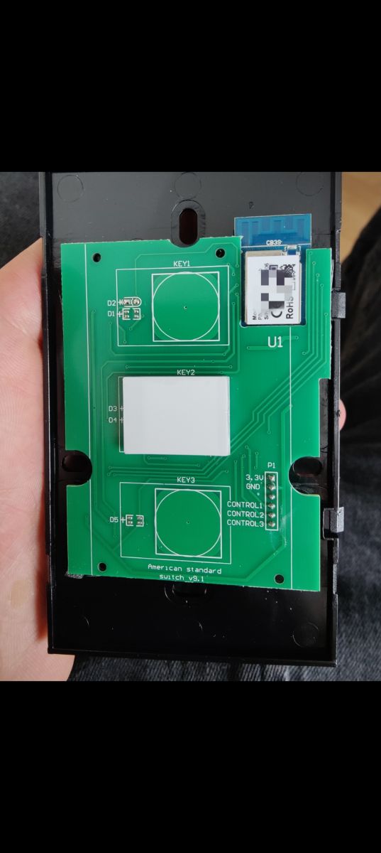

    Added after 5 [hours] 6 [minutes]:
    Problem solved.
    Had to remove this chip before flashing:

    Had to remove this chip before flashing.
