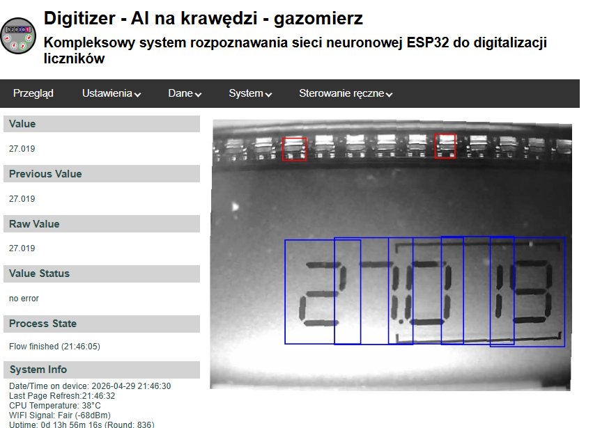

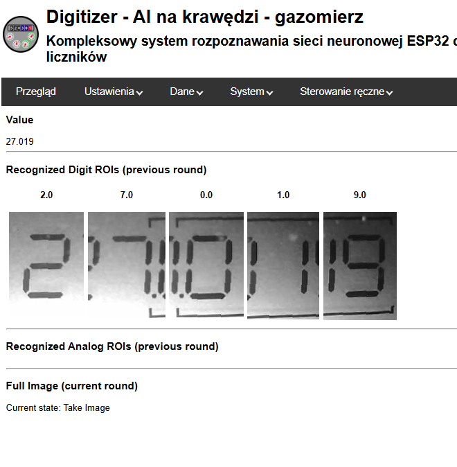

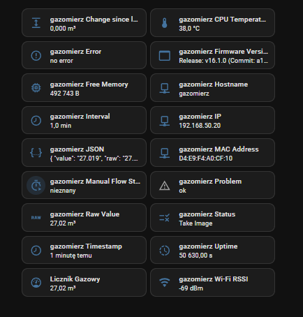

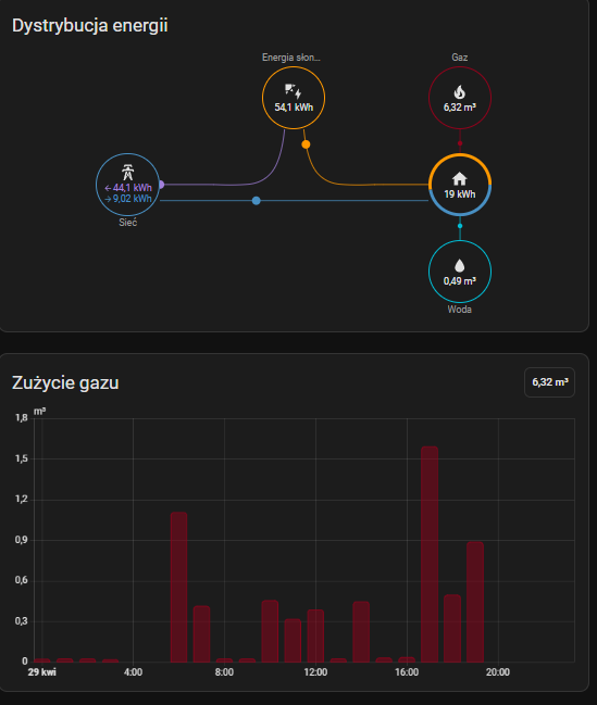

    #36 21893592
    PaweWolniewicz
    Elektrometal EM-eG4 - how to read gas consumption remotely, integration with Home Assistant
    https://jomjol.github.io/AI-on-the-edge-device-docs/Installation/
    Good evening, I wanted to let you know that the ESP camera with the meter and meter recognition software works without any problems. I recommend delving into the subject, it works sensationally, flawlessly, resolution to 0.001 l, greetings serdec
    iNSULT.
    As you can see, the entities all in Home Assistant work flawlessly, doing 1440 readings per day, or every minute. It has a filter to prevent negative results, as well as safeguards so it doesn't jump ahead too much. Overall it is very well thought out. Browser-based software - a revelation for me. The cost of the whole device with the 3D case, which I printed myself, is about £70.
