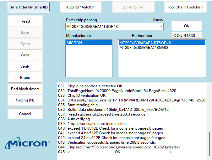

    Good evening my net friends!
    I just bought the universal programmer RT809HSE and I have a problem.
    It doesn't respond to the "Open" command to upload the bin file and buffer view to see what I have inside. Could you please help me?
    * I have a PSU 12 V
    * Chip ID verification OK
    OS: WINDOWS 11
    Soft Version of RT809HSE: 20250423
    RT809HSE software screenshot showing detected Micron chip and operation log

    When you click Write, this opens a window to indicate the file.
