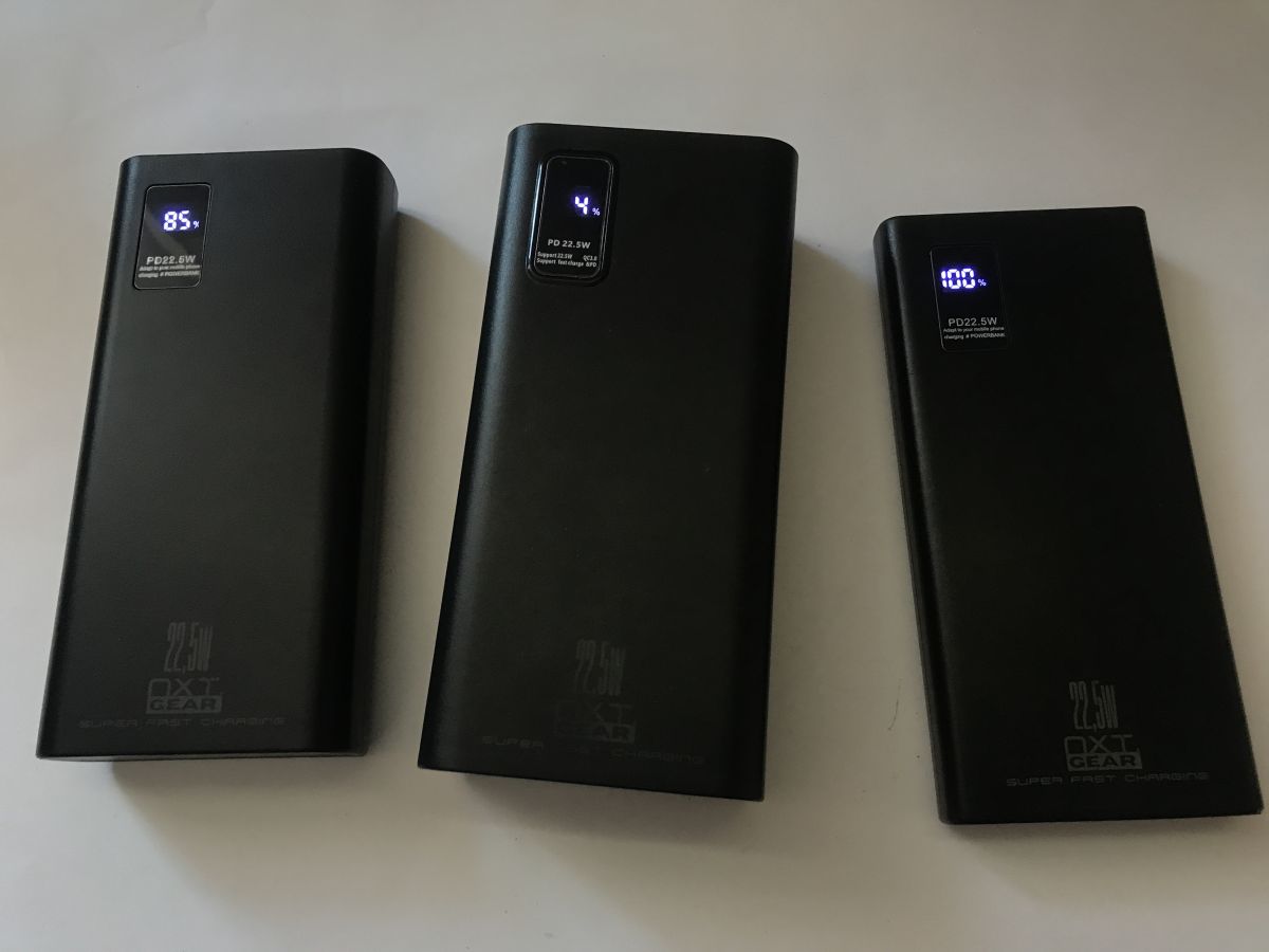

    Today's test will focus entirely on powerbanks supporting the Quick Charge standard, i.e. capable of powering our mobile devices with a voltage higher than the standard 5 volts. This speeds up their charging significantly. The declared power of each unit is 22.5 watts and the capacities are 10 Ah, 20 Ah and 30 Ah, respectively. They can be purchased for, respectively, PLN60, PLN115 and PLN160. Does it make sense to pay this much? Let's find out!
    All three powerbanks are from the same family, so a brief specification to start with:

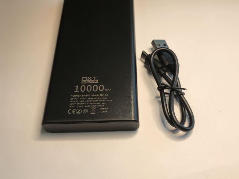

    Some powerbanks try to advertise themselves as supporting 'fast charging', but 'fast' in the marketing sense - not the 'Quick Charge' standard. Here, however, the voltages are specified, so this concern is not there. We look further. A cable is included.
    Black NXT Gear BY-K7 10000 mAh power bank with USB cable next to it

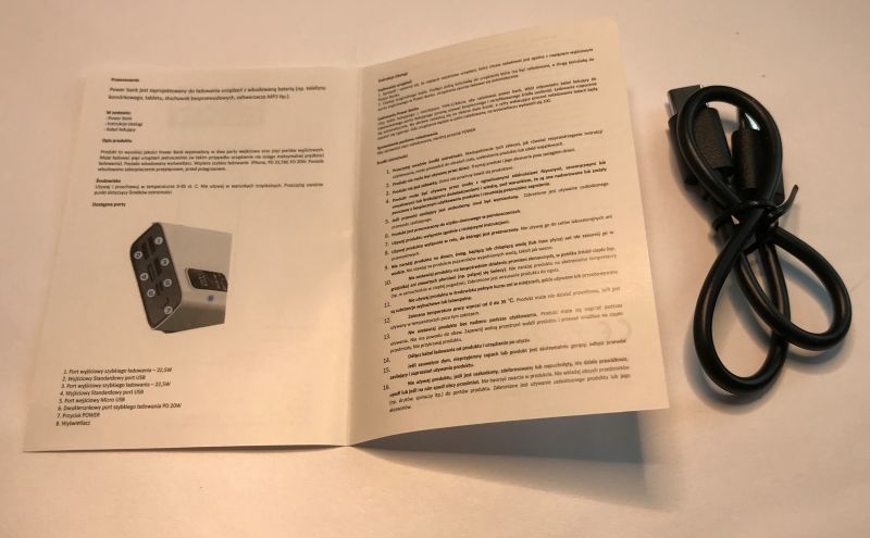

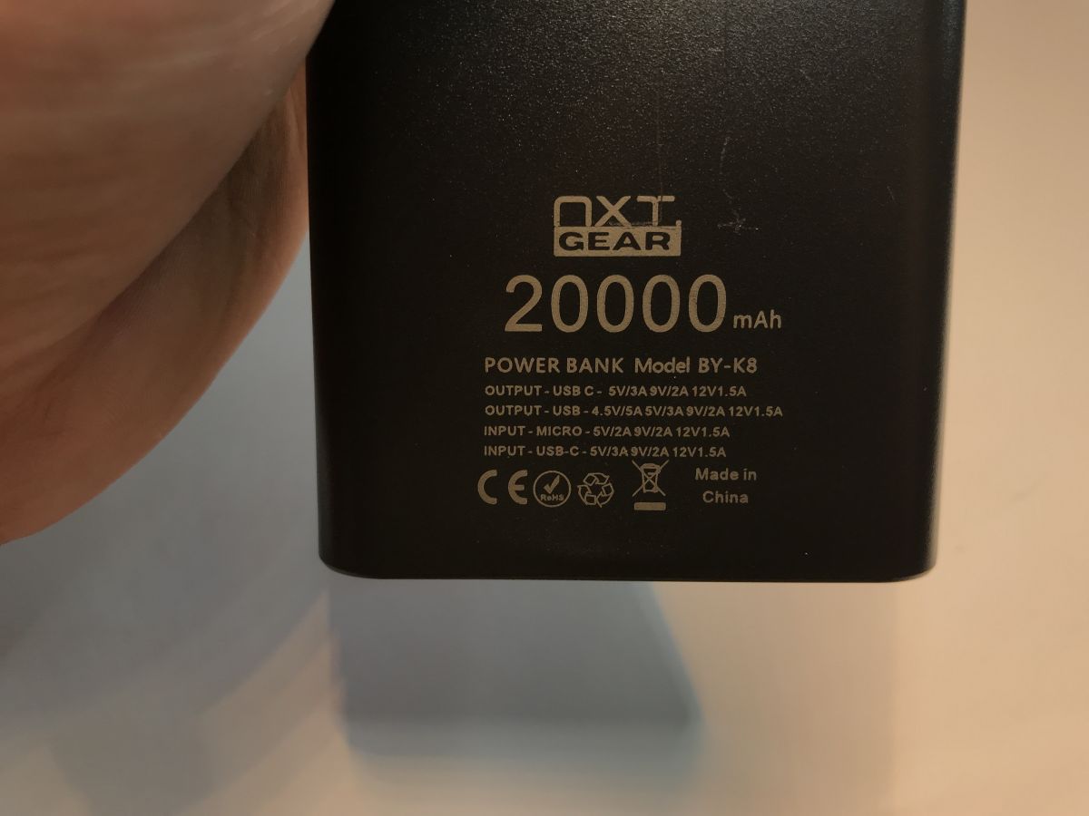

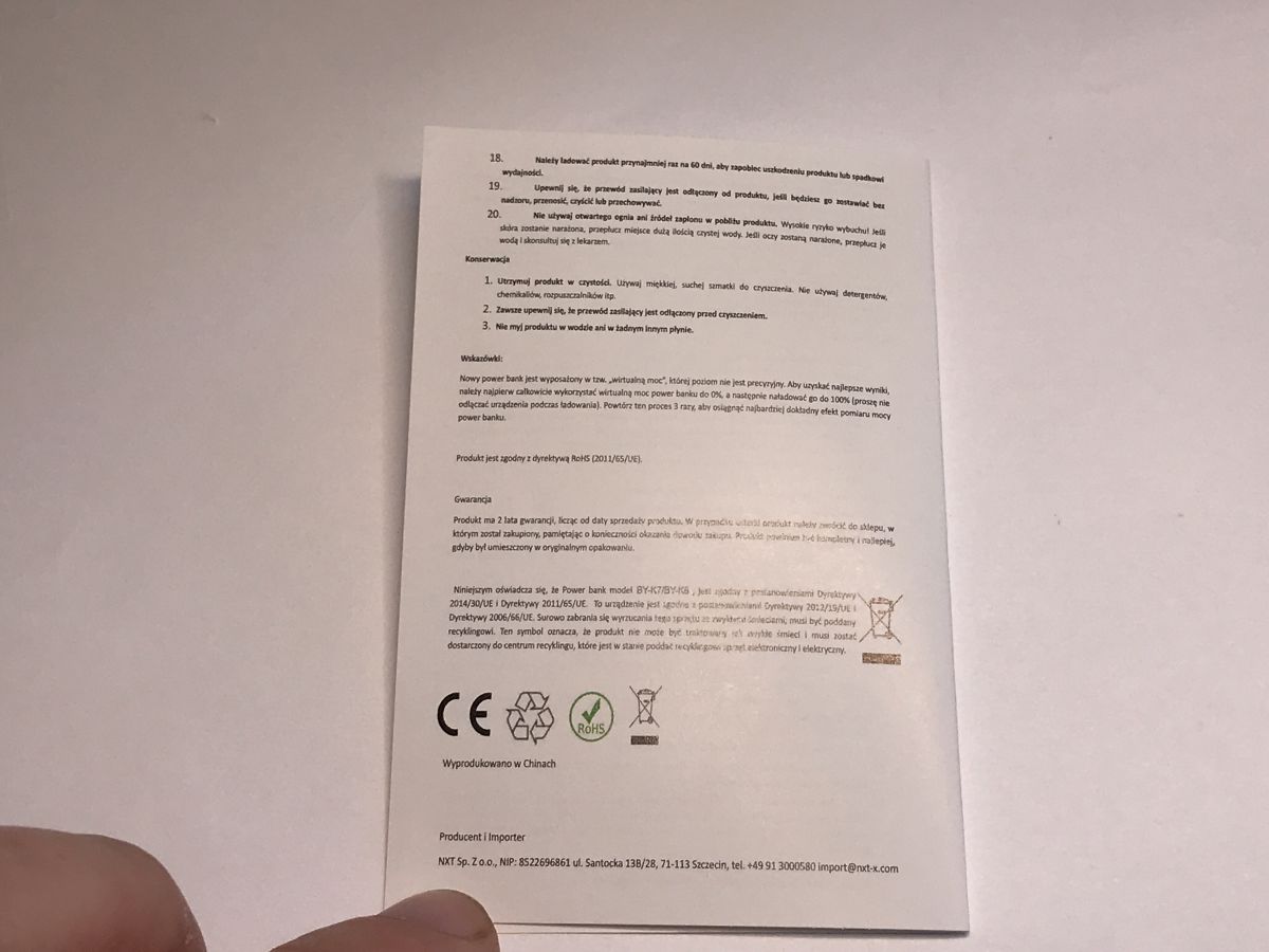

    Voltages and currents are also indicated on the case. A manual is also included:
    User manual for NXT Gear BY-K7/BY-K8 power bank lying on white background Open power bank manual showing port diagram and usage warnings in Polish NXT Gear product manual featuring safety notes, warranty, and CE, RoHS markings

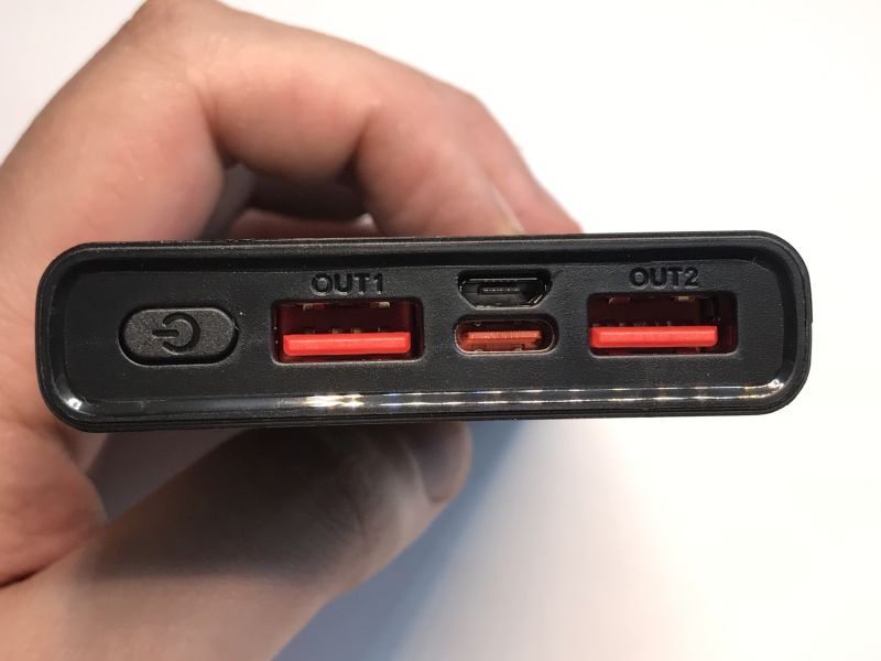

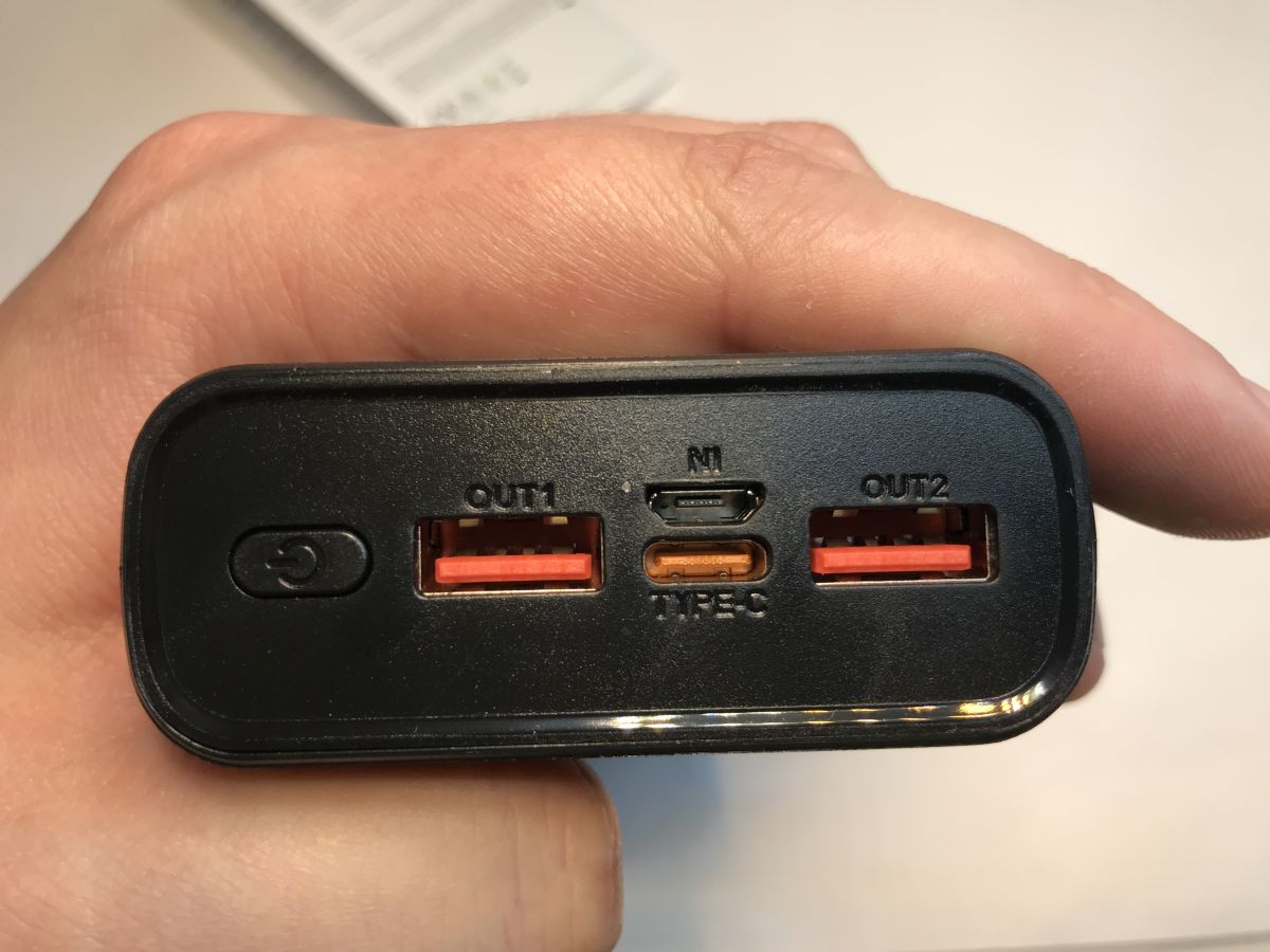

    The two USB A ports are for powering other devices, the micro USB is for powering the powerbank itself, the USB C works both ways.
    Close-up of a power bank with two USB-A ports, micro USB, and USB-C

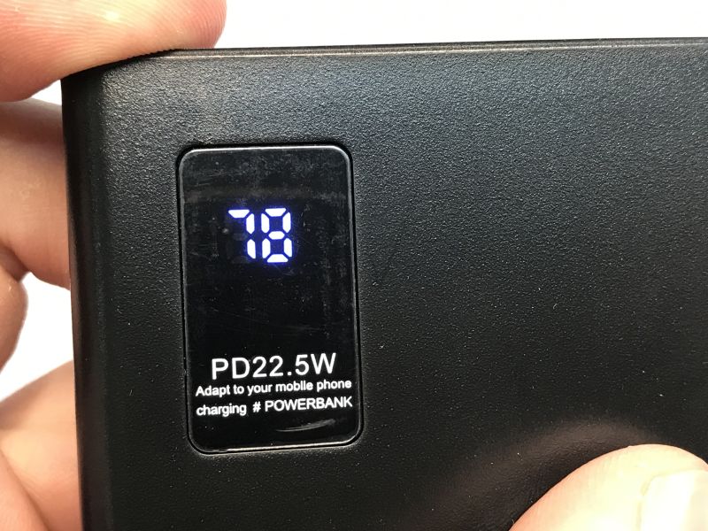

    Pressing the button awakens the display and we already know how charged the powerbank is:
    Close-up of power bank screen showing 78% charge and PD 22.5W label

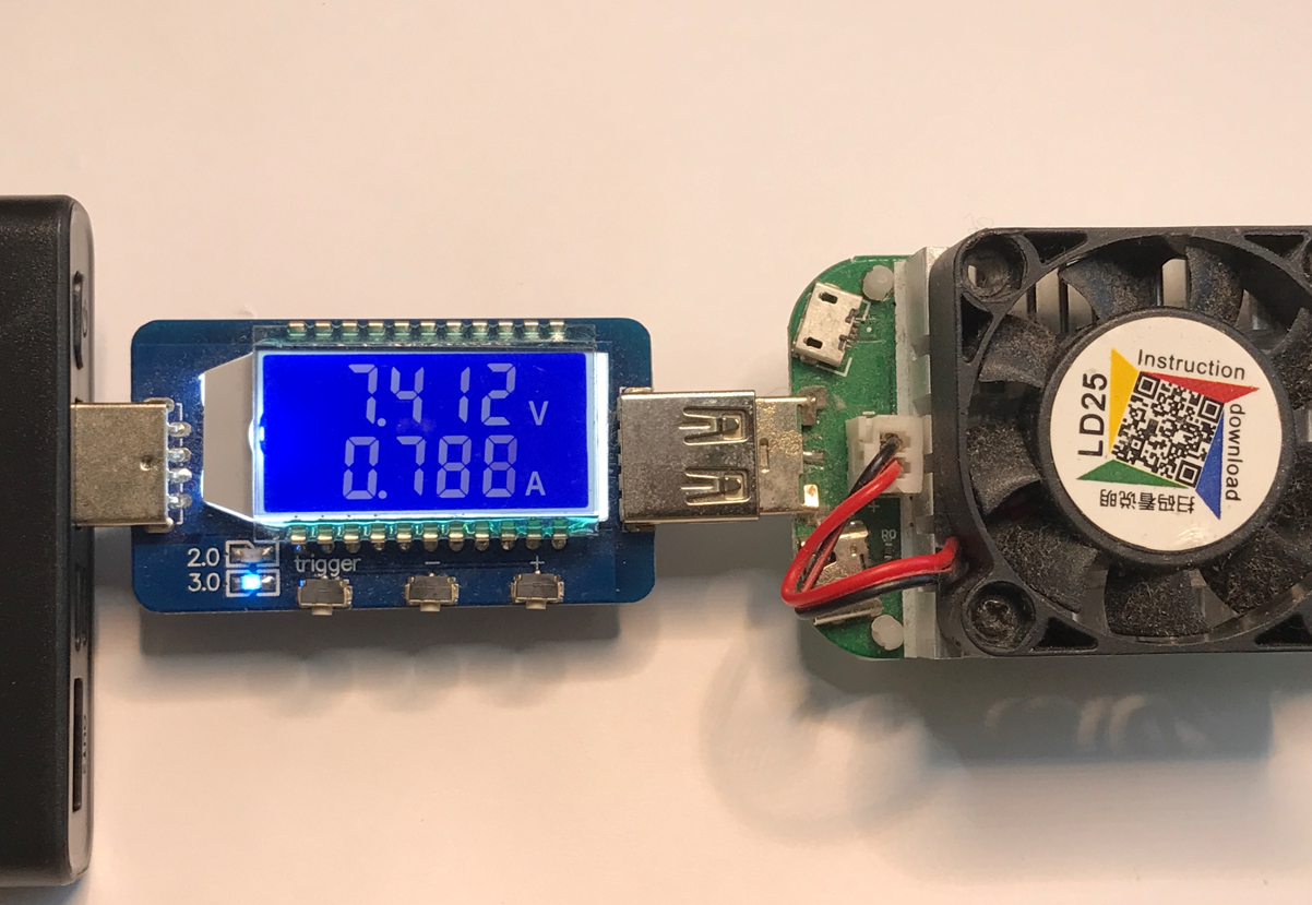

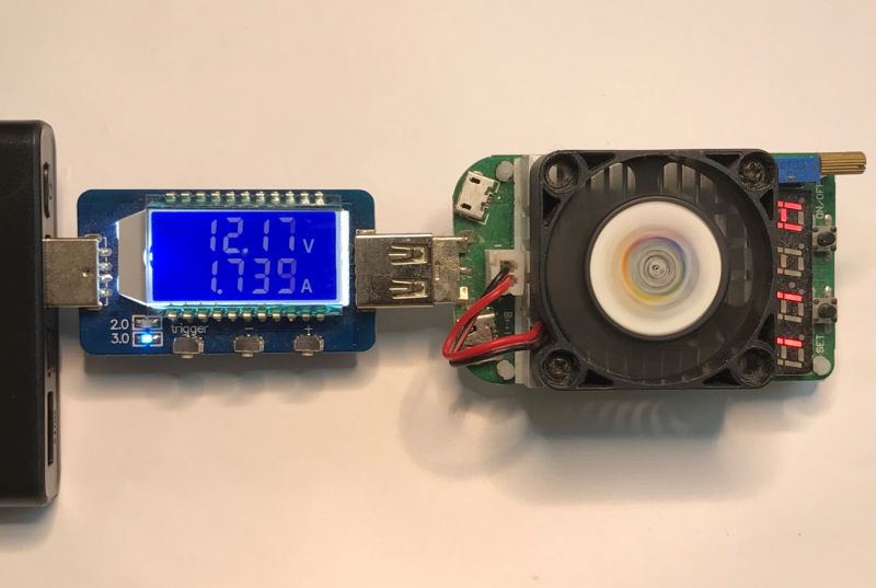

    First, a test with the QC trigger. QC can be triggered in 2.0 and 3.0 mode, with selectable voltages (9 V, 12 V) and stepless voltage adjustment (up to 12 V). It manages to draw up to 1.8 A at 12 V, or approximately 21.5 W.
    Voltage tester showing 7.412 V and 0.788 A connected to a power bank and fan-cooled load
    USB tester shows 12.17 V and 1.739 A with a connected power bank and load with fan

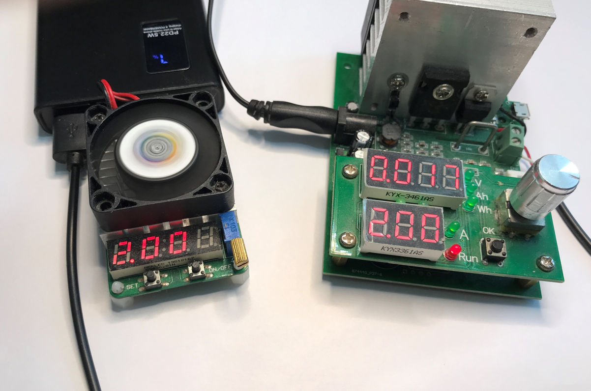

    Now a load test at 5 V. Managed to draw 4 A, 2 A per port. This comes out to a good 20 watts.

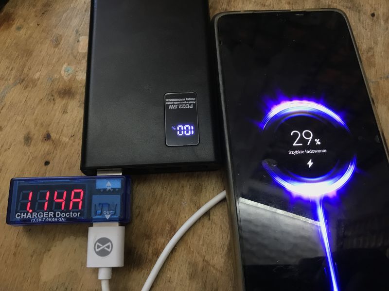

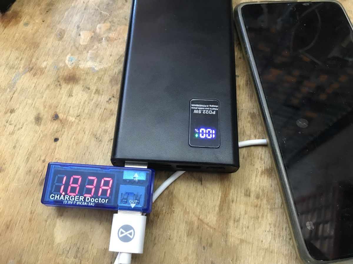

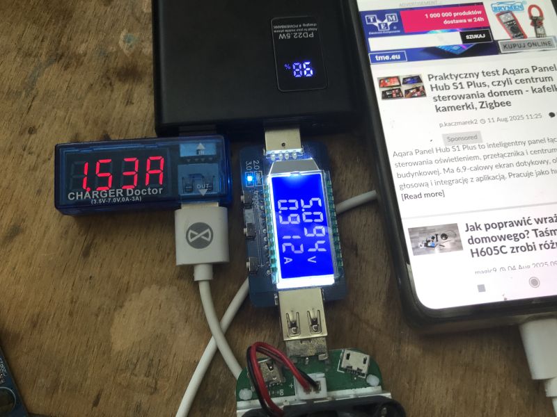

    Now a practical test. How will my Xiaomi 11T charge?
    BY-K7 power bank charges smartphone via QC, showing 29% and 1.14 A on display
    It charges at 7.5 volts, the current is first just over 1 A, then increases to 1.83 A:
    Power bank showing 100% charge, connected to a current meter and a smartphone
    A green icon lights up on the display.

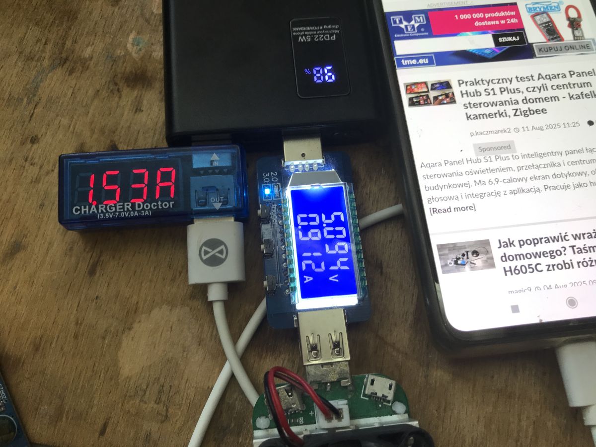

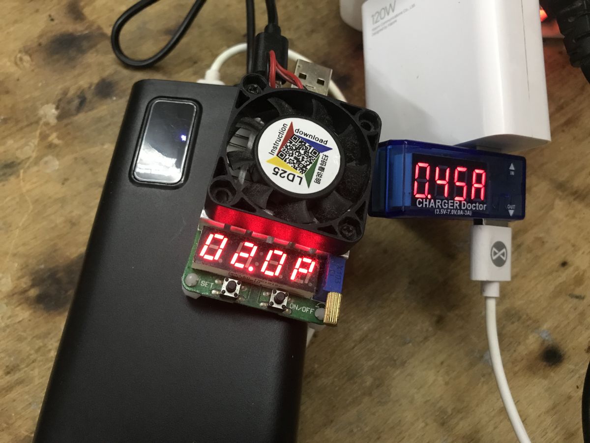

    I also checked what if I connect an additional load - then the QC shuts down and the voltage drops to 5 V:
    Power bank measuring voltage and current while charging a smartphone

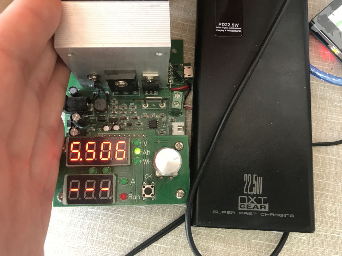

    Then it was time for the capacity test - this would be the capacity at 5 V, then need to be converted to cell capacity. I repeated the test three times.
    Electronic tester showing 5.506 V and NXT Gear 22.5 W power bank during charging test
    5.5 Ah at 5 V gives 27.5 Wh. According to my conversion from previous topics , this would be approximately (5.5/0.65) Ah = 8.46 Ah.
    Test BY-K8

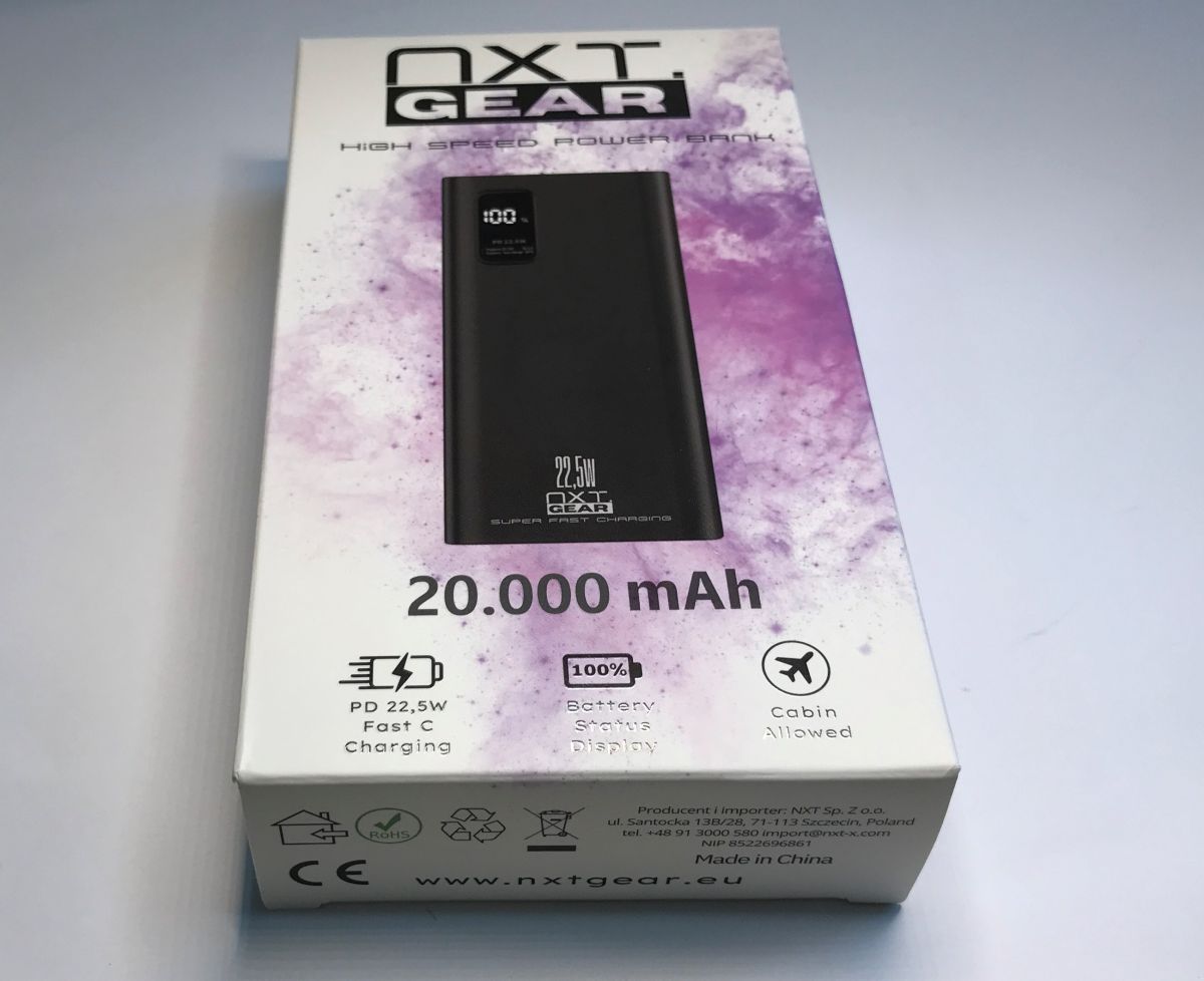

    Without much comment - unpacking and instructions.
    Packaging of the NXT Gear 20,000 mAh power bank labeled 22.5 W White NXT Gear 20,000 mAh power bank box with purple print and tech specs Back of NXT Gear power bank box showing technical specifications Top of BY-K7 power bank packaging with importer details and certification symbols Top of BY-K7 power bank packaging with importer details and certification symbols
    Close-up of NXT Gear BY-K8 power bank showing 20000 mAh and port specs NXT Gear power bank user manual with technical specs at the bottom of the page Open power bank manual showing port diagram and safety instructions Power bank manual page showing CE, RoHS symbols and manufacturer details
    The powerbank is necessarily slightly larger and heavier. However, it has the same connectors as the previous one.

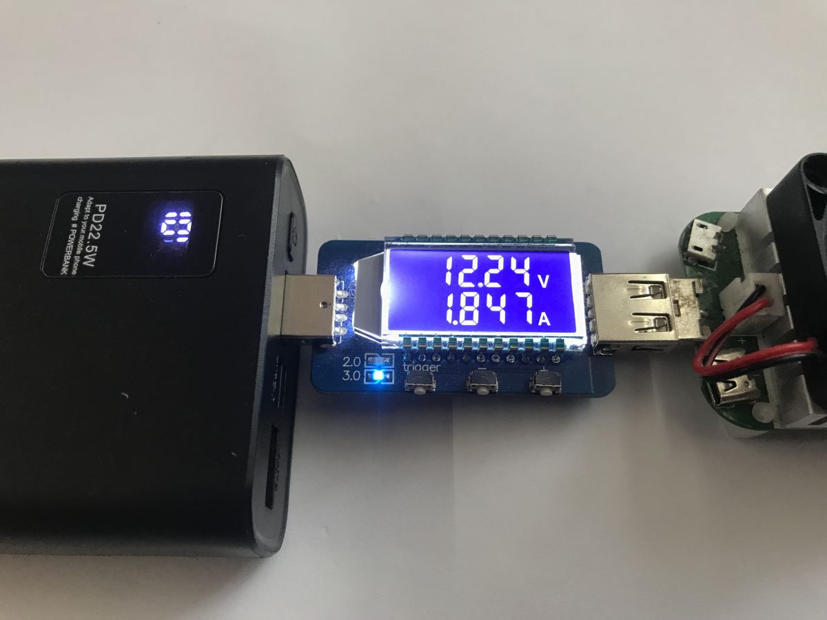

    With Quick Charge as before:
    Power bank with display connected to USB meter showing 12.24 V and 1.847 A

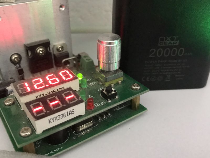

    I tested the capacity with five times:
    Voltage tester showing 12.6 V next to NXT Gear 20000 mAh power bank
    12.6 Ah at 5 V gives 63 Wh. According to my conversion from previous topics , this would be about (12.6/0.65) Ah = 19.4 Ah.

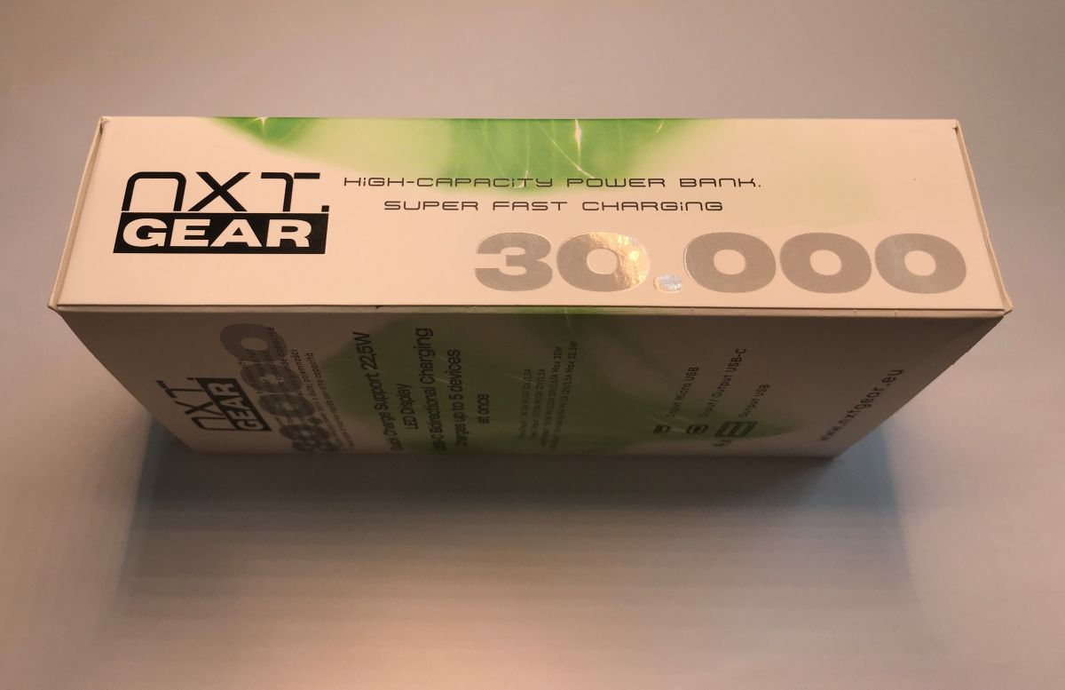

    Now this box is much bigger:
    NXT Gear 30 000 mAh power bank packaging showing 22.5 W fast charging. NXT Gear 30,000 mAh power bank box with printed features and branding. NXT Gear 30000 mAh power bank box labeled “super fast charging”

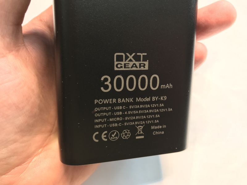

    NXT Gear BY-K9 30000 mAh power bank with technical specs on the casing

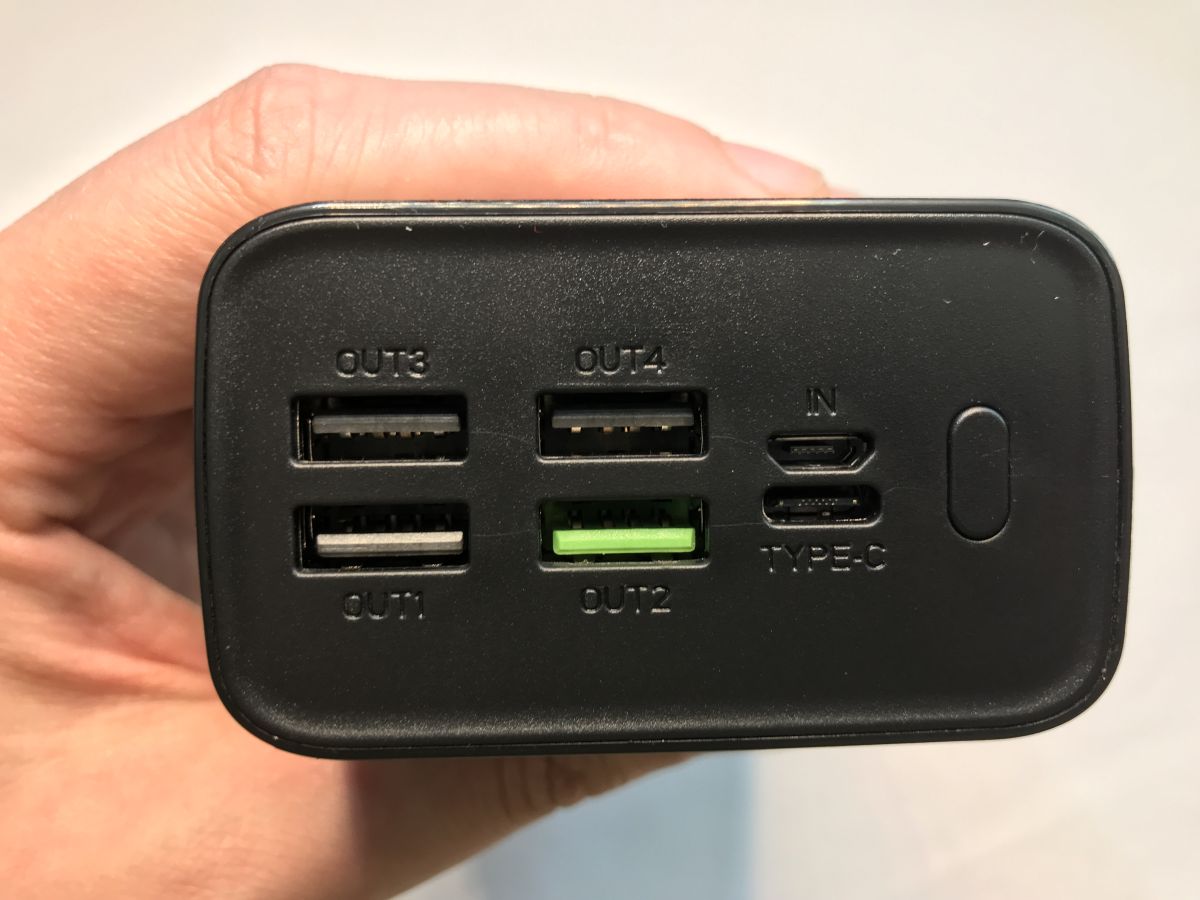

    However, there are more ports:
    Close-up of power bank ports: four USB-A, one USB-C, and one micro USB.

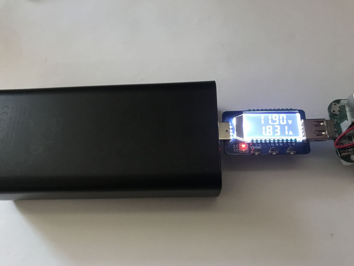

    QC works fine, again shuts down at around 22 W:
    Power bank connected to USB voltage tester showing 11.90 V and 1.831 A

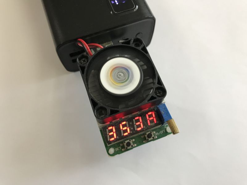

    Just over 3.5 A at 5 V can be drawn from a single port:
    Power bank with USB load tester showing 3.63 A on digital display

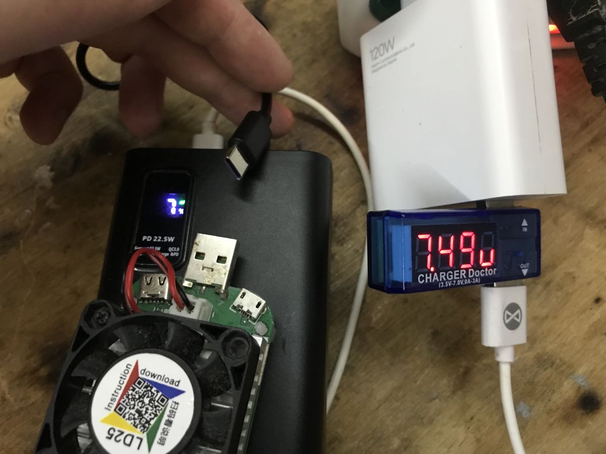

    The QC shuts down again as soon as I connect something more, e.g. here an additional load:
    BY-K7 power bank under load with USB voltage and current testers attached Powerbank QC test with 7% on display, voltage meter shows 7.49 V

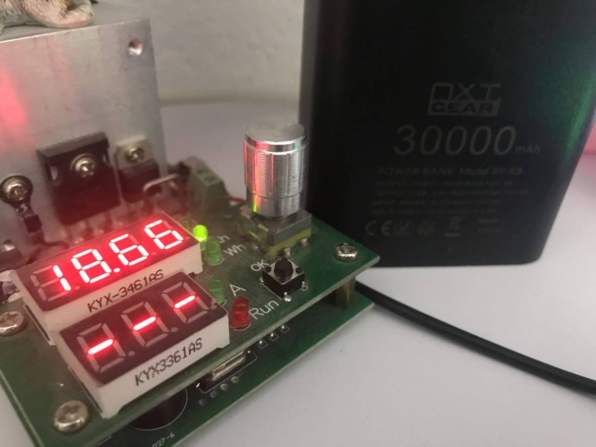

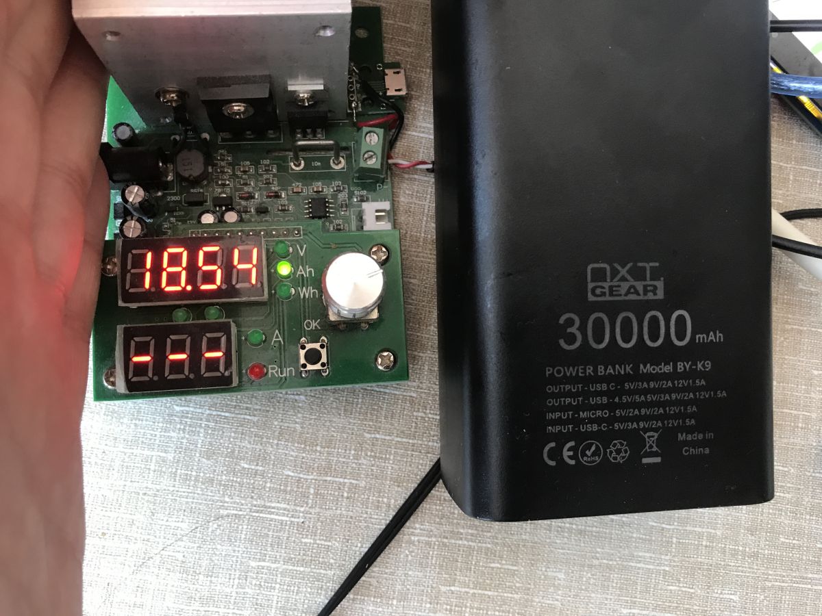

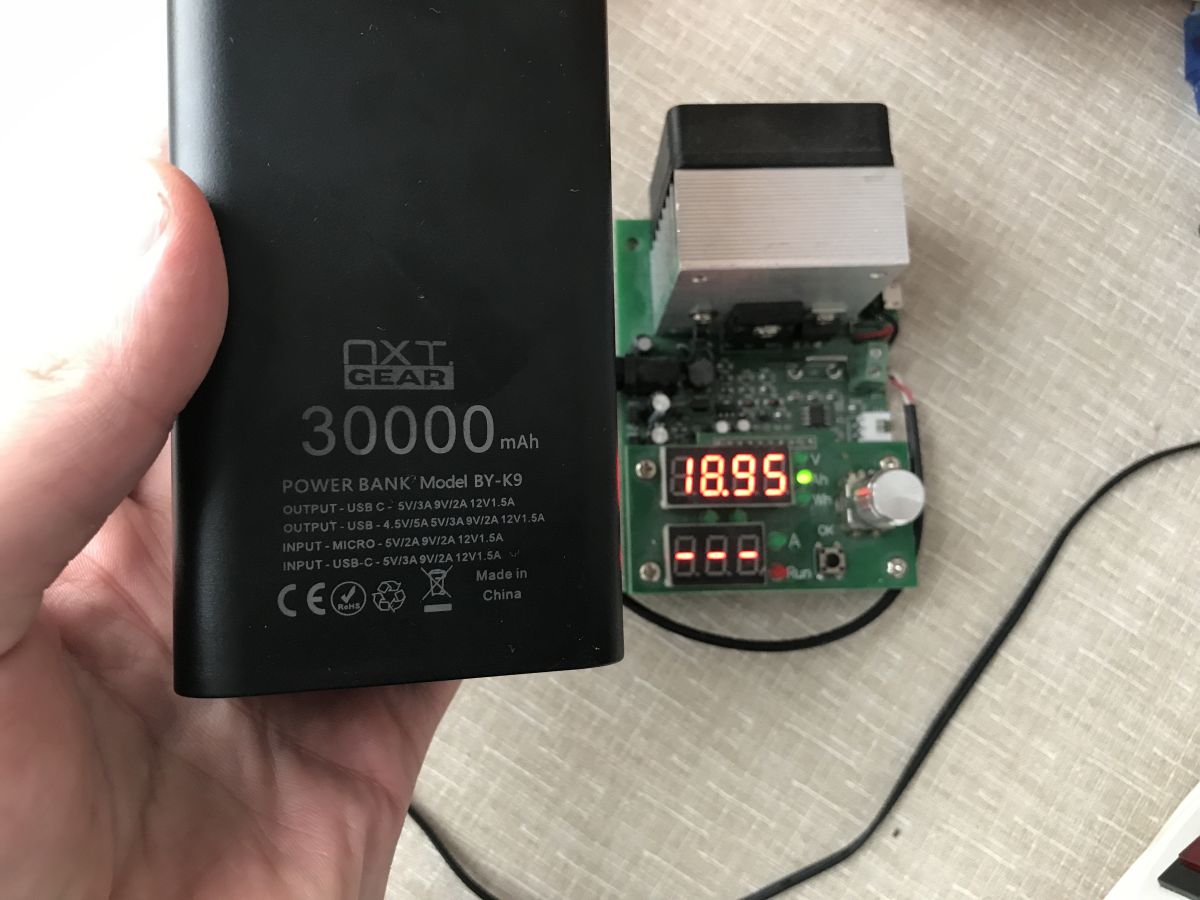

    I repeated the capacity tests again several times:
    NXT Gear BY-K9 30000 mAh power bank next to a tester showing 18.66 on its display Electronic load tester connected to NXT Gear BY-K9 30000 mAh power bank NXT Gear BY-K9 30000 mAh power bank with specs visible and tester showing 18.95 Ah
    Let's take these 18.95 Ah at 5 volts for calculation. That comes out to just under 95 Wh. According to my conversion from previous topics , this would be about (18.95/0.65) Ah = 29.15 Ah.

    I also checked the current capacity and QC. I think it is very good - we get what the seller promised. It even managed to get 12 volts, although my phone didn't switch on as much as that voltage, it only stopped at 7.5 volts. The powerbank itself is also able to take the increased voltage, as we connect it to a suitable power supply. On a side note, I've observed that the QC shuts down when you plug in a second USB cable - no matter whether to charge the device itself or something external. This means that by connecting the phone for charging "via powerbank" we lose the QC option altogether and this should be kept in mind, but I don't suppose anyone does this?
