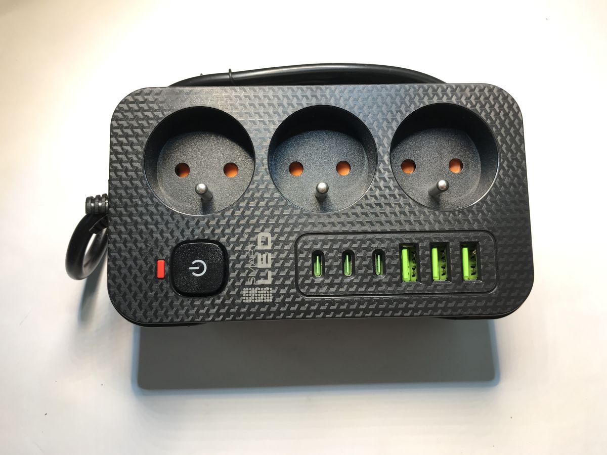

    In this topic, I will present two products from the same series - SmartLED 8152 (5 x USB, 5 x 230V) and SmartLED 8110 (6 x USB, 3 x 230V). Both cost around PLN35 each, which is suspiciously cheap, but they do have USB C, which might seem like a good bargain. Just does the presence of a USB C socket equate to support for fast charging standards such as QC and PD? We shall see.
    SmartLED 8110 (PLN32)

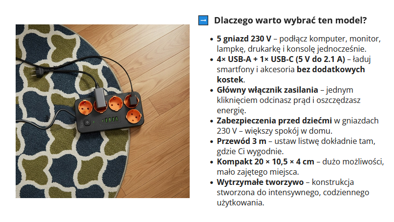

    Let's start with the description. The text does not mention USB parameters, so supported voltages and current capacity are a mystery.
    What to look out for when buying a USB C strip? SmartLED 8152 and 8110 tests
    There is a bit more information on the packaging - 5 V/2.1 A, not to be confused with 21 A. The question now becomes, is this the current capacity of one socket or all six together?
    What to look out for when buying a USB C strip? SmartLED 8152 and 8110 tests What to look out for when buying a USB C strip? SmartLED 8152 and 8110 tests What to look out for when buying a USB C strip? SmartLED 8152 and 8110 tests
    The product itself looks good and is signed with the importer's logo.

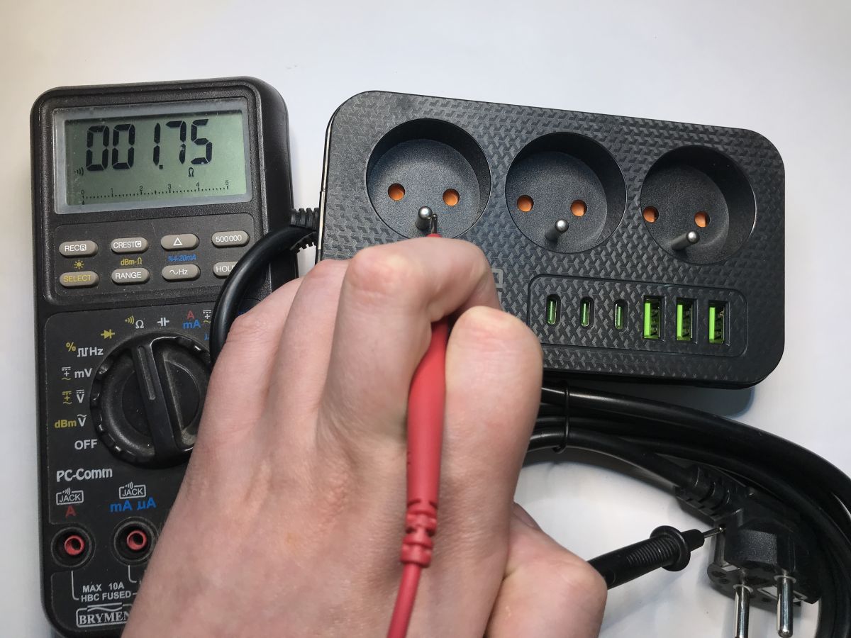

    i have checked the ground connection:

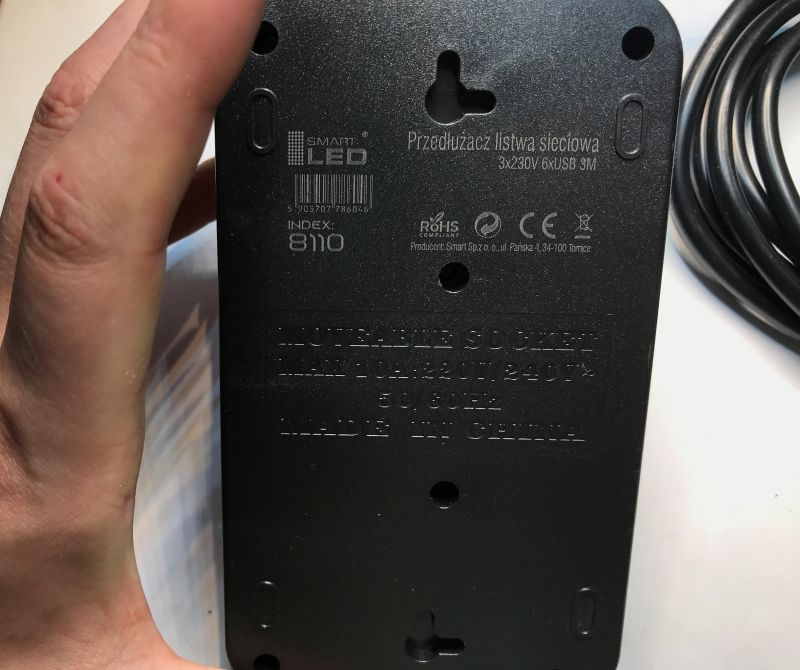

    The information on the bottom is in Polish, someone has made an effort:

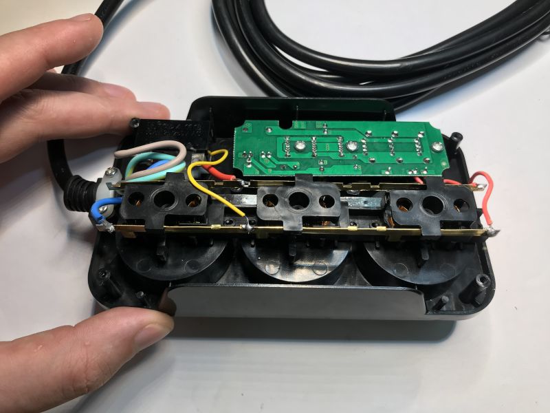

    Already at this stage I can see that all the USB ports are on a single ground and power line - 5 volts.
    The wires from the strip don't look too bad, although they are soldered rather than crimped.

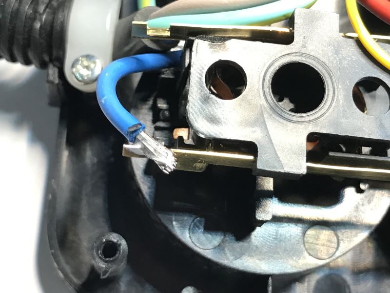

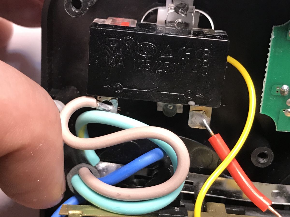

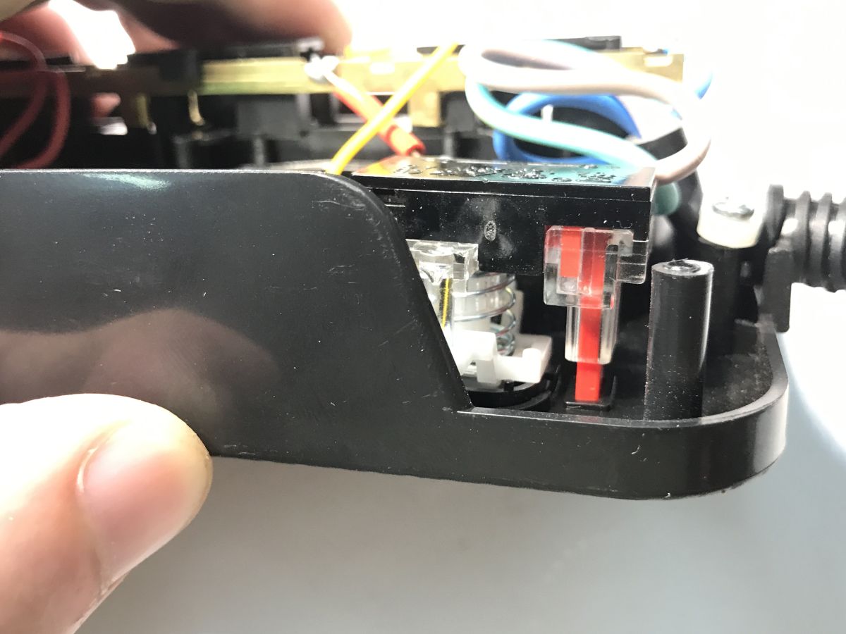

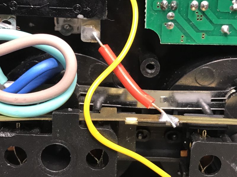

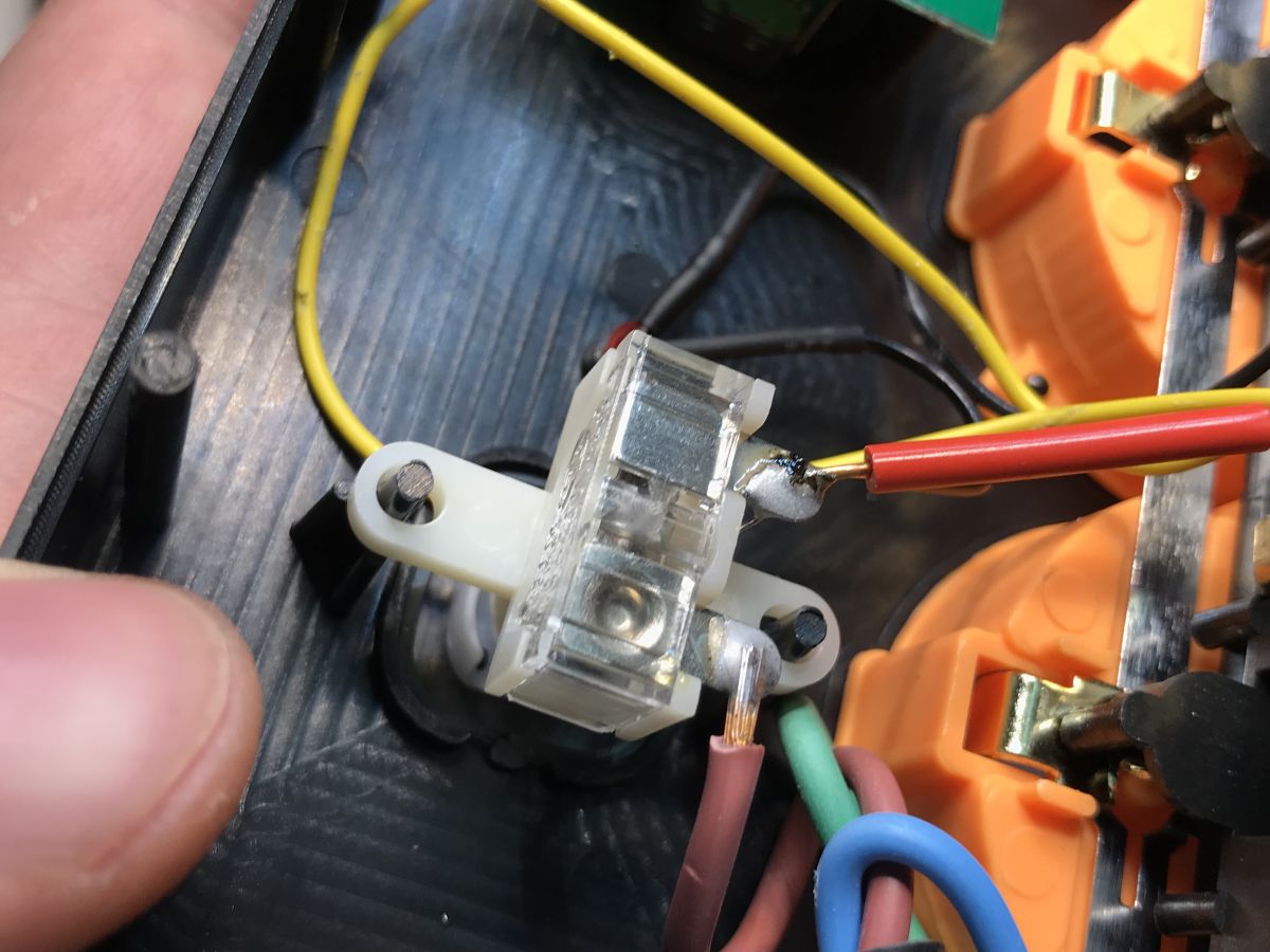

    There is a simple circuit breaker inside - it looks like an overcurrent circuit breaker. It cuts off one conductor:
    It can be reset if necessary:
    Worse is the connection from the switch to the sockets - the cable is much thinner.

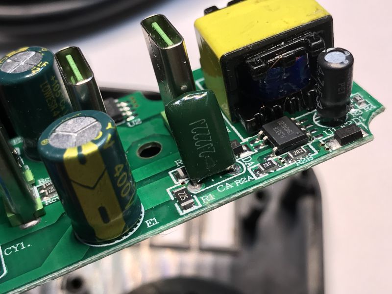

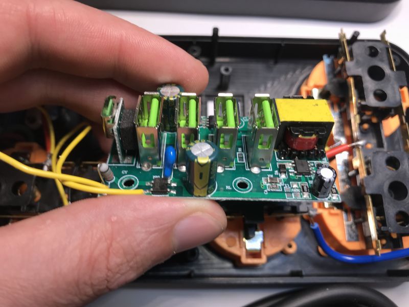

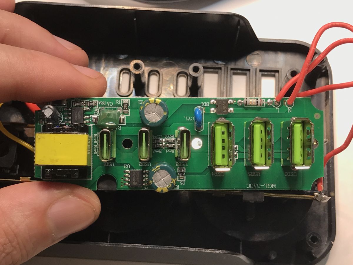

    The power supply can now be viewed.
    At the input you can see the fuse resistor, further on is the MB10F rectifier bridge. Next to it you can also see the capacitor CY1. Next is the electrolytic capacitor and the flyback converter controller.

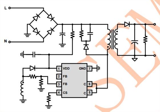

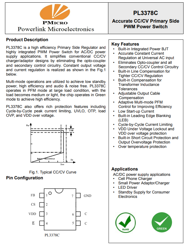

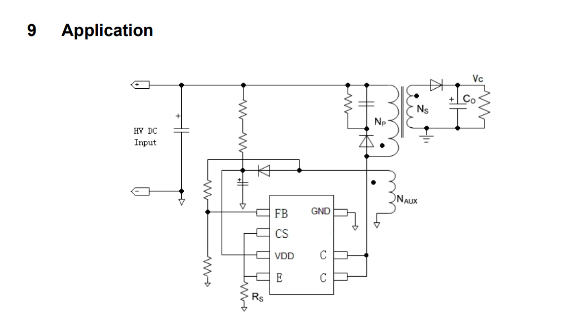

    The power supply is based on the PL3378.
    Informational leaflet for PL3378C chip with feature list and pinout diagram
    Flyback converter application diagram with transformer windings and controller block.
    This is the simplest flyback converter controller with an integrated keying transistor and feedback taken from the primary side. There is no support here for any of the higher voltage supply standards.

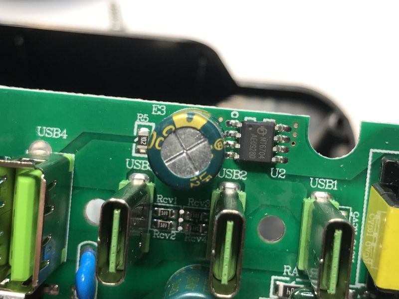

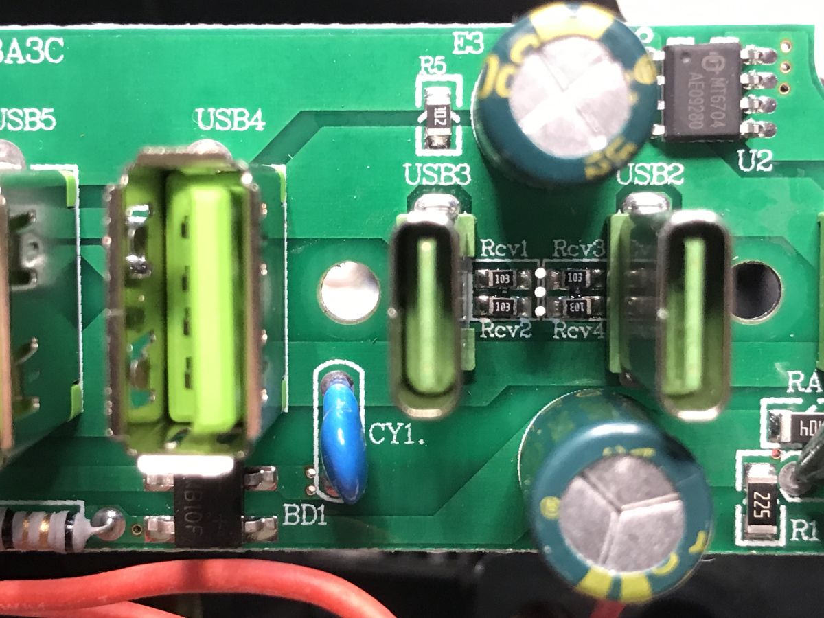

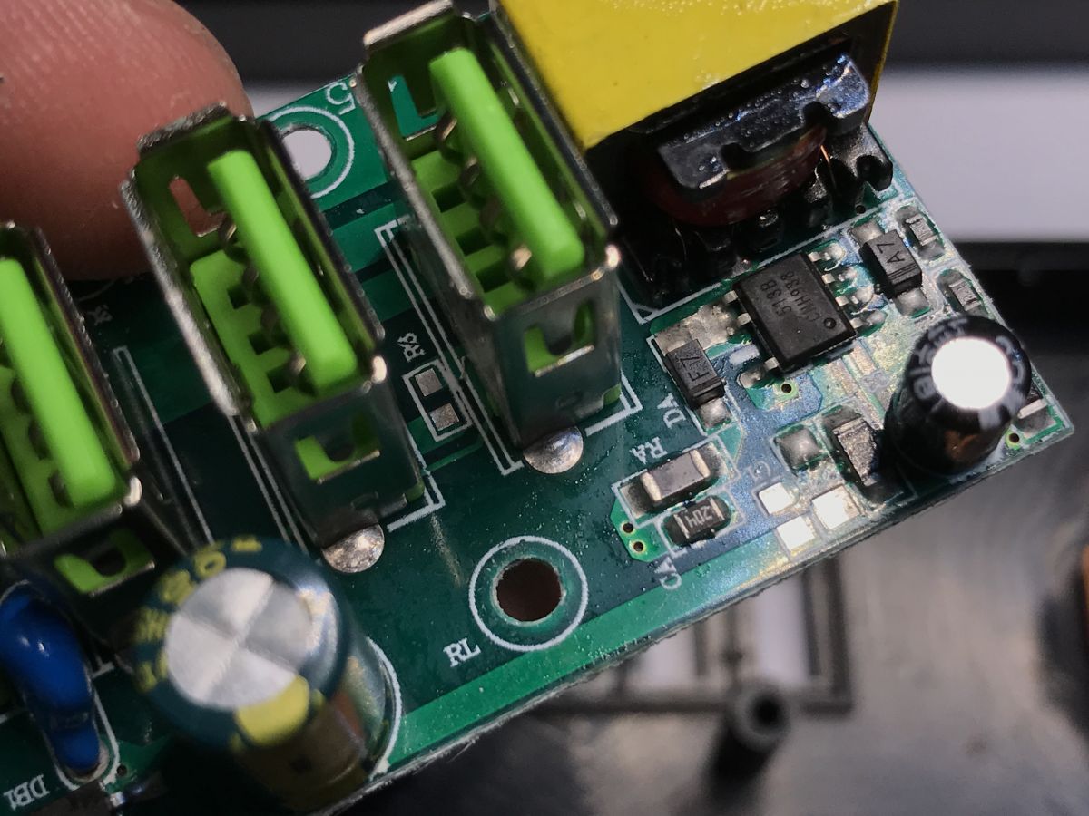

    Close-up of circuit board with USB ports and MT6704 chip visible

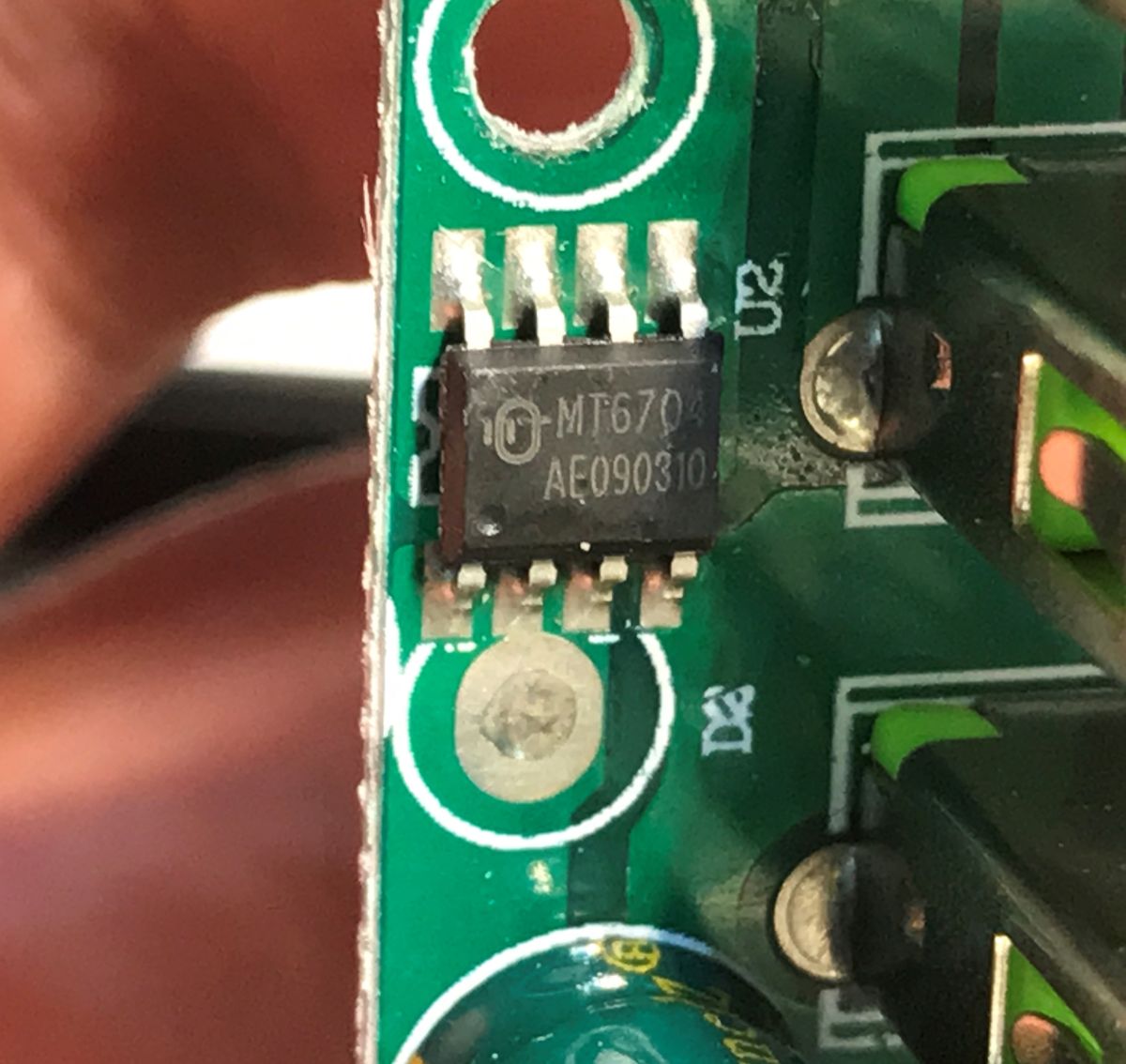

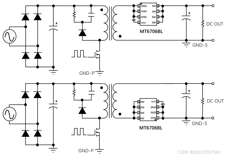

    On the secondary side is an MT6704, which looks to me like a synchronous rectifier. It replaces a Schottky diode. It's essentially a properly controlled MOSFET with low resistance in the open state.
    Diagram of two flyback converters with MT6706BL synchronous rectifier circuits
    Vain to look for any additional electronics here, the only thing more has been added are resistors for the USB C ports to allow devices to detect the power supply.
    Close-up of circuit board with five USB ports and electronic components.
    An even simpler solution was used for the USB A ports - simply shorting the D+ and D-.

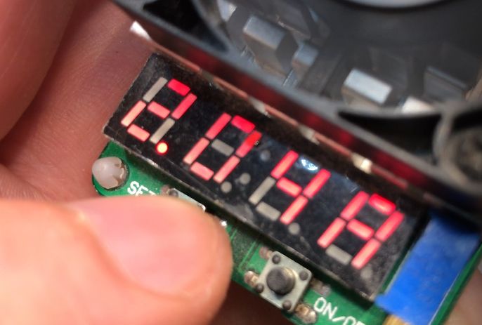

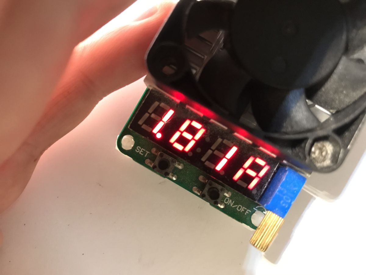

    It was left to check the current capacity - you can draw up to 1.9 A at 5 V, then the voltage drops to around 3 V.
    USB tester display showing current of 1.91 A
    Not even that legendary 2.1 A, and that's the current of all the ports together, so the result is very poor.

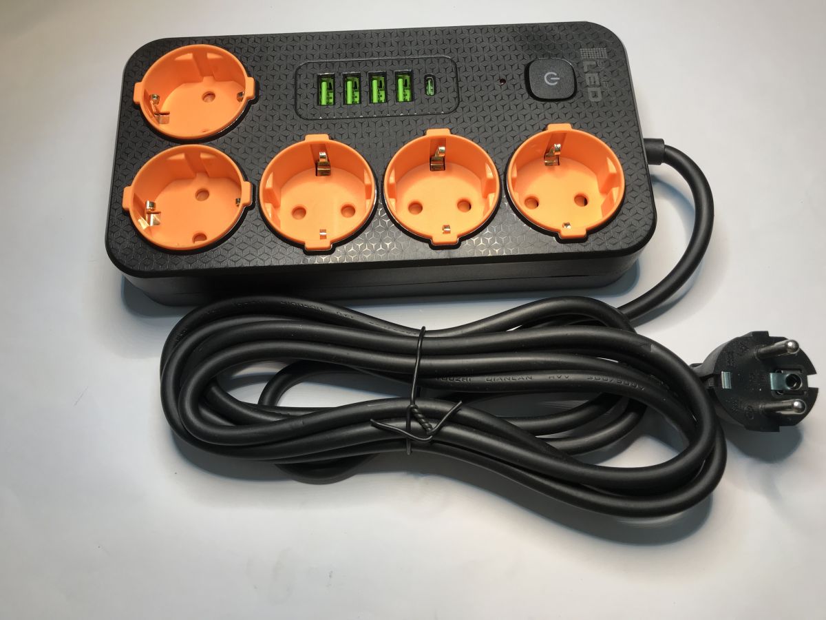

    SmartLED 8152 (PLN37)
    Again, we start with the description. Here it is slightly better. There is a tentative mention of 5 V and 2.1 A in the description:
    Power strip with three sockets and five USB ports placed on a patterned carpet floor.
    The author of the description, however, does not seem to see the problem. The information then appears once again and is presented as an asset:
    Power strip with 5 USB ports and 5 Schuko-type 230V sockets
    Confusing voltage with current does not add any credibility to the description.

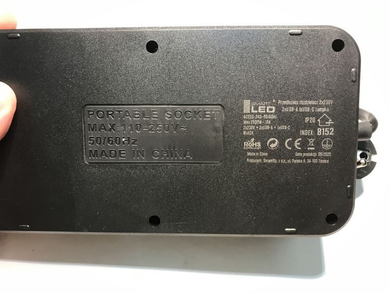

    Polish description on the bottom:
    Bottom of SmartLED 8152 power strip with printed technical specifications

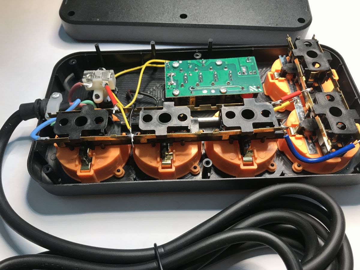

    The construction is quite similar to the previous one, also only one conductor is cut off:
    Power strip interior with five AC sockets and visible electrical wiring
    Power strip interior with plastic reset switch and soldered wires
    Construction of the power supply as before:

    On the secondary side is a similar synchronous rectifier as before - MT6704.

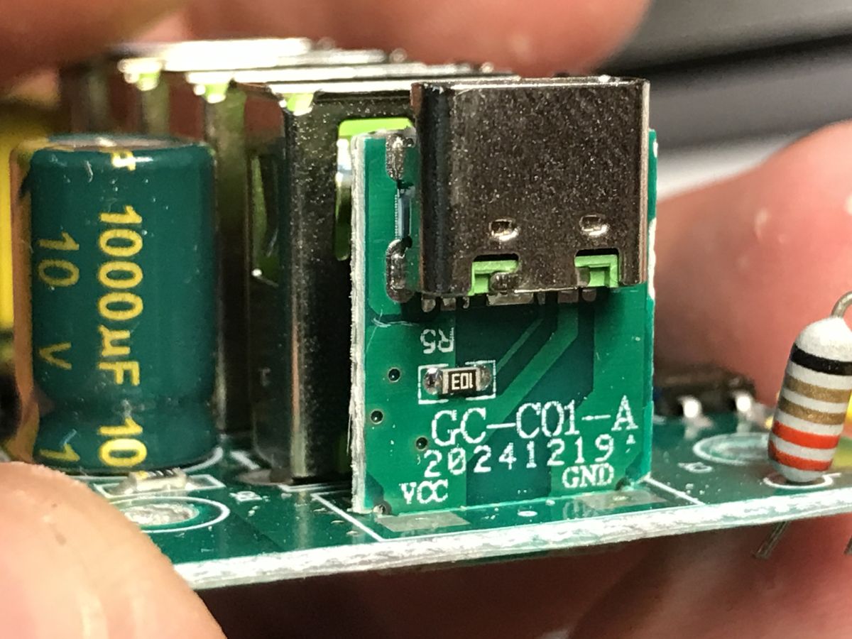

    USB C is on a separate board, but there is nothing else there. No chip to negotiate or there to report the power supply.
    Close-up of USB-C port on GC-C01-A circuit board with components and labels visible
    Again, you can only draw up to 2A.
    Close-up of meter with LED display showing a reading of 4.84

    Both products are very similar. Only one has information in the description about the current capacity of the power supply, and anyway it is presented in such a way that a non-technical person will not realise that something is wrong. This current capacity is far too low and, in my opinion, is more suitable for a single-port, possibly a dual-port USB charger - or rather a power supply, because "charger" is a marketing name, but it is really just a power supply and the charging circuit is in the phone.
    Even my old iPhone, with the right negotiation circuit in the USB port, is capable of drawing almost 2 A when charging:
    Two-port USB charger that accelerated the charging of my iPhone
    Both power supplies shown here already shut down at this current, so I really don't know why the extra ports there? Do you see any use for this type of invention? As far as I'm concerned the current capacity rather rules it out....
    It's hard not to get the impression that this is another product to "fool" non-technical people...

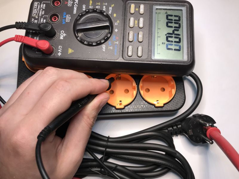

  • High resistance measurements suggest no protective conductor
    #4 21752504
    Ktoś_tam
    Level 40  
    Posts: 5321
    Help: 504
    Rate: 2873

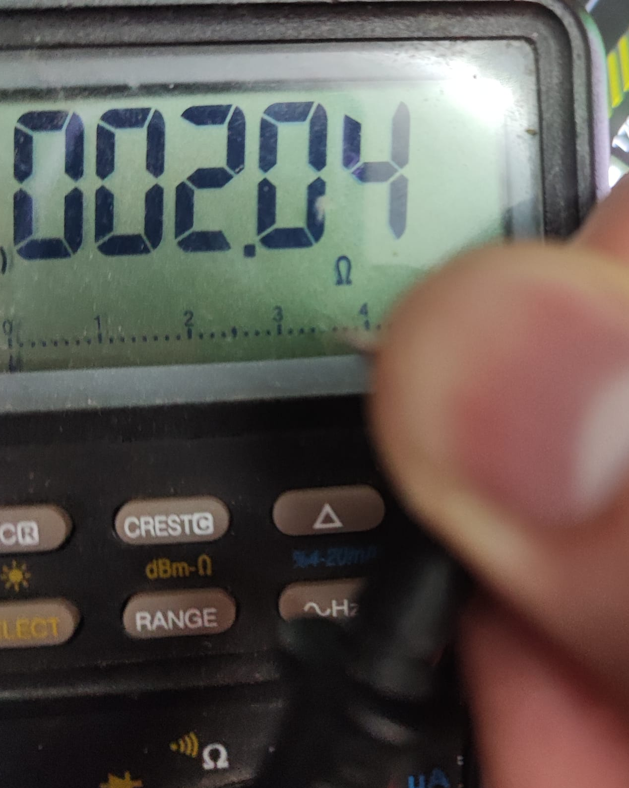

    Is earthing finally there or not? For me, if the measurement is reliable then it is not there. With the measurement of 1.75R you write nothing and with the measurement of 4R you write that the earthing is connected. As far as I'm concerned, both measurements, if they're not subject to error, rule out these strips as having a protective conductor. Can you write something about whether it is an error in the measurement or whether the resistance is so high that it excludes these strips from use because the resistance values are too high?
  • Probe contact error may skew resistance measurements
    #5 21752535
    Posts: 14648
    Help: 655
    Rate: 12660
    The measurements are subject to error and I wouldn't draw too firm a conclusion from them. The photo was taken while holding both probes with one hand so the contact was not very good, plus when I now short the same probes for a test it shows similar resistance, now 2 ohms for example:
    Multimeter display showing a resistance value of 2.04 ohms, partially obscured by a finger.
    But all in all you are right, good point, I could potentially pay more attention to this issue, thanks.

    now on test I short-circuit the same probes it shows similar resistance, now for example 2 ohms:
    What is the button with the triangle on the meter used for?

    Indeed a delta against the shorted probes may help to offset the error due to their resistance, I will take this into account for the next test.
    I'll honestly admit that I treated this test more with its zero-one (is there contact or not) to satisfy my first curiosity and just listened to see if there was a buzzer. But fact, the actual resistance is probably worth bearing in mind too.
    Now I wonder if, as if I took a good quality strip, and at least from this topic this product, if there will be visible differences in such a measurement.
