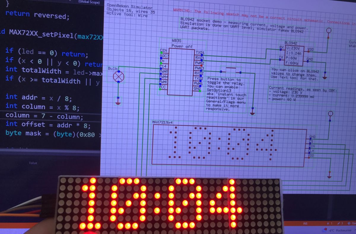

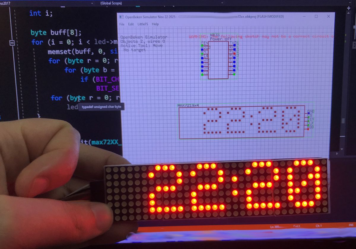

    Recently I reactivated the project of a network synchronised clock based on the MAX7219 display and additional sensors, but the work was effectively slowed down by the lack of free space on the table and the long time waiting for compilation and uploading firmware to the board. For this reason, I started looking for an alternative solution, the basis of which I had in principle already prepared - it turned out to be a clever way of running the MAX7219 on a Windows platform. Here I will briefly describe the implementation and operation of my idea.
    Introduction
    I wrote the project with a number of platforms in mind in our environment OpenBeken , which at the moment supports the platforms shown in the table below (as of 2025.11.22):

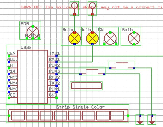

    Connection diagram in OpenBeken IoT simulator with bulbs and LED strips.
    It would probably be best to implement this at the signal level - that is, probably perform a logic step with each change of the associated pins from SPI. This would read the bits and then assemble them into bytes and eventually parse and handle the commands like the MAX7219 does.
    Unfortunately, this would require a bit of work - for this reason, I've decided to assume for now that there will be one MAX7219 and ignore its connections in the Simulator. Instead, I am sending the information to its pixel level:

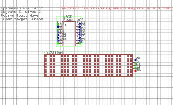

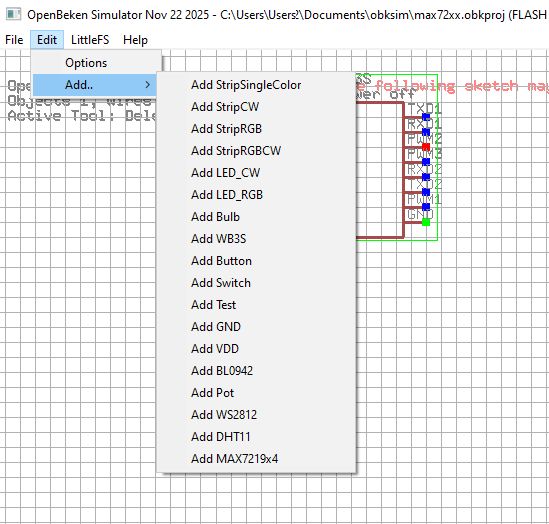

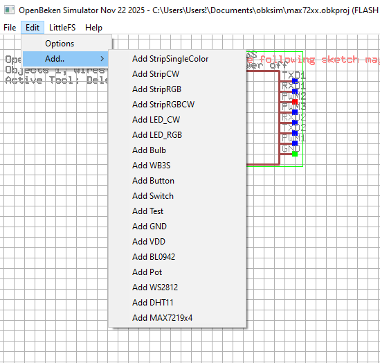

    We start by adding a display object - for now there is only a quadruple version:
    OpenBeken simulator add-menu listing components, including MAX7219x4 module

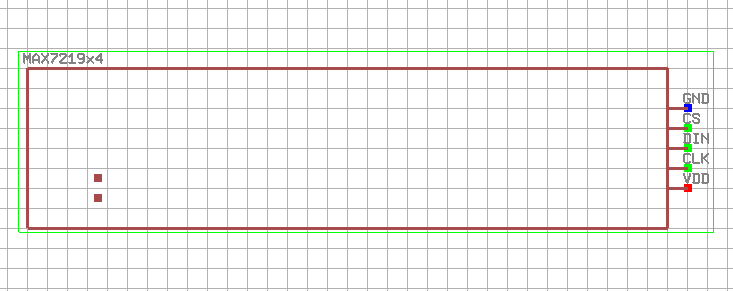

    We get the object - at this point it doesn't need to be connected. This is obviously a flaw, but I'll fix that in part two:

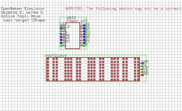

    View of ESP and MAX7219 display components in OpenBeken simulator

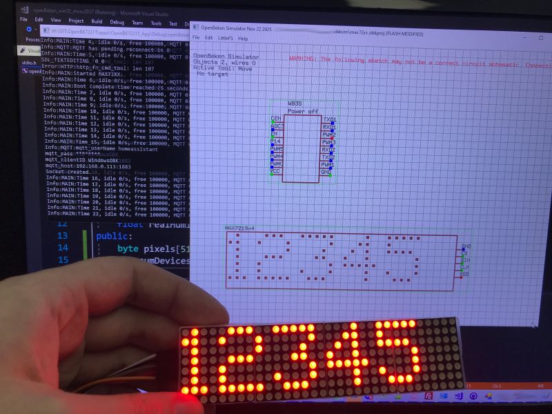

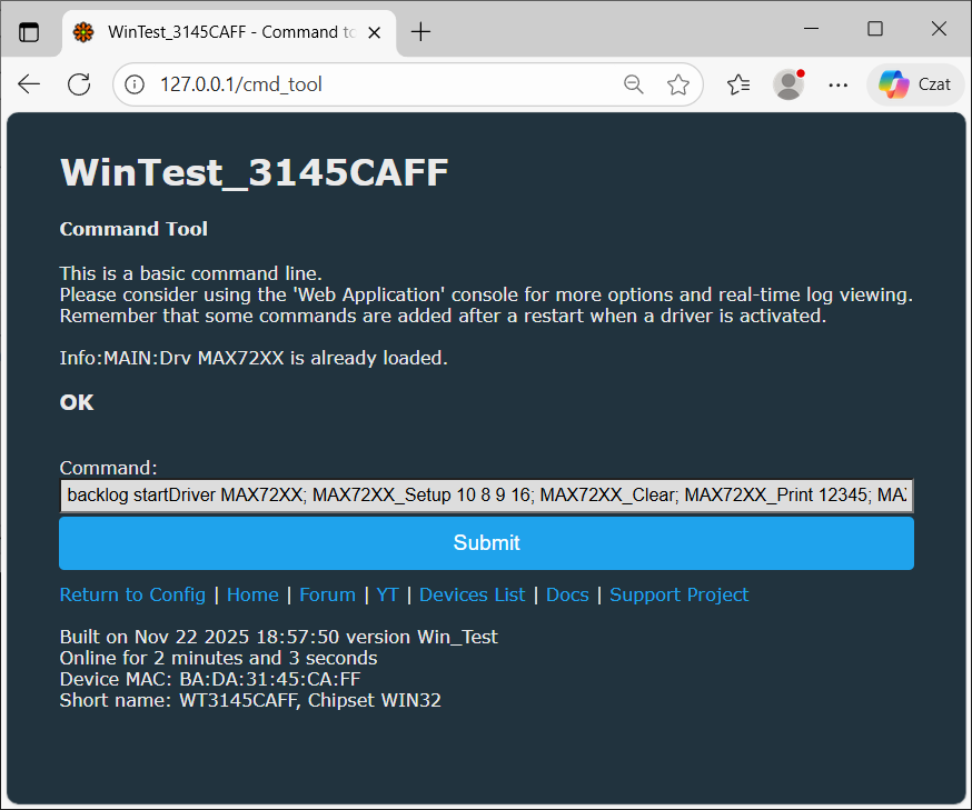

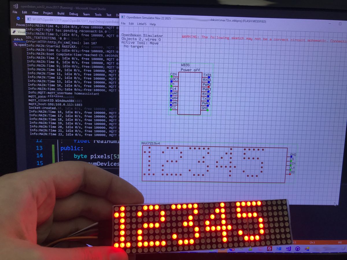

    Now you can access the web panel of the virtual device and operate the MAX72XX controller at will, just as if you were doing it on a physical Wi-Fi module. For example, you could try to display some text:
    Command panel of OpenBeken simulator with active MAX72XX driver.
    I fired an identical command on an ESP8266 with a physical display module. The effect in both cases is the same:
    MAX7219 LED display showing the number “12345” in front of a simulation screen.

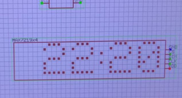

    Similarly, the clock driver with time taken from the network via NTP, also behaves the same on both platforms:
    MAX7219 LED display shows 22:20; background shows simulator window on computer

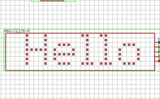

    In a similar way, the Berry scripts now work - consider the simplest example:
    autoexec = module("autoexec")
    def myLogic()
          runCmd("MAX72XX_Scroll 1")
          runCmd("MAX72XX_refresh")
    end
    runCmd("startDriver MAX72XX")
    runCmd("MAX72XX_Setup 10 8 9 5")
    runCmd("MAX72XX_Clear")
    runCmd("MAX72XX_Print Hello")
    setInterval(myLogic, 100)
    return autoexec
    PCB layout with HELLO written in a grid of red dots
    Then more advanced scripts can be tested:
    test = module("test")
    def pad2(n)
          if n < 10 return "0" + str(n) end
          return str(n)
    end
    [inContentAd]
    def myLogic()
          time = gmtime("YMDhms")
          Y = time[0]
          M = time[1]
          D = time[2]
          h = time[3]
          m = time[4]
          s = time[5]
          runCmd("MAX72XX_Print " + pad2(h) + ":" + pad2(m))
    end
    runCmd("startDriver NTP")
    runCmd("MAX72XX_Setup 10 8 9 16")
    setInterval(myLogic, 1000)
    return test

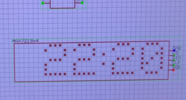

    This script runs NTP and retrieves and breaks down the time from it. In addition, it ensures that the hours and minutes are correctly displayed, i.e. always with two digits, even when their value is less than 10.
    MAX7219 LED clock simulation on a grid showing time 22:20

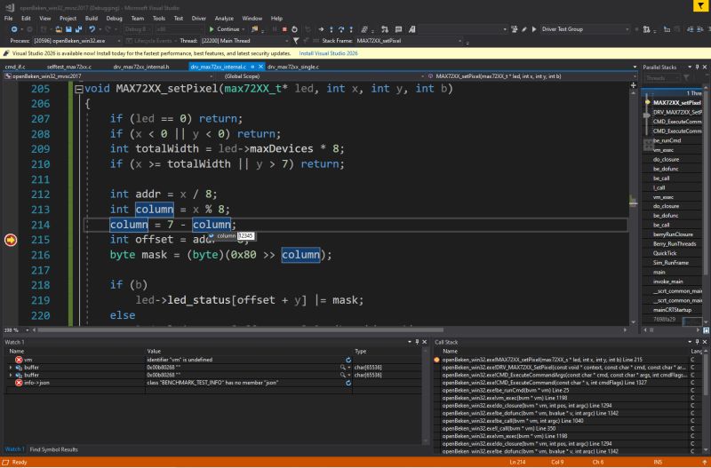

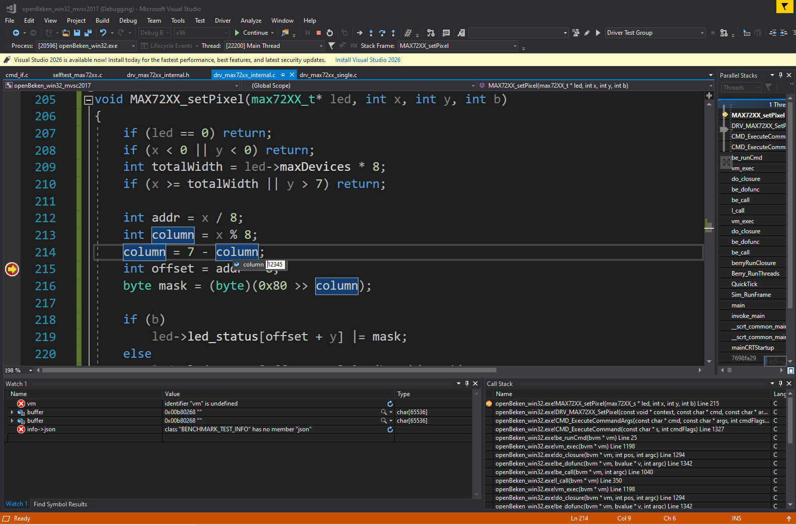

    It's also hard not to mention debugging here - complete with variable viewing and even the possibility of changing their values - all conveniently, without the target hardware:

    In the end the choice was for a simpler connection between the virtual MAX7219 and the actual driver code and the SPI communication itself is omitted, but I don't see this as a problem. The operation of the SPI has long since been tested, and it's not something I'm further editing or developing, so I'm not worried about errors there.
    The virtual MAX7219 has been linked to the driver at the pixel level, which is fully sufficient for my applications and actually speeds up my prototyping and work.
    I have the other drivers such as scripts, NTP, OpenWeatherMap or there Home Assistant integrations already ported to Windows long ago - as well as GPIO and relay handling. The MAX7219 controller was just the last missing piece of the puzzle.
    This way, I can essentially do the whole project on the PC (in the Simulator) and then compile it and upload it, for example, to an ESP or BK7231.
