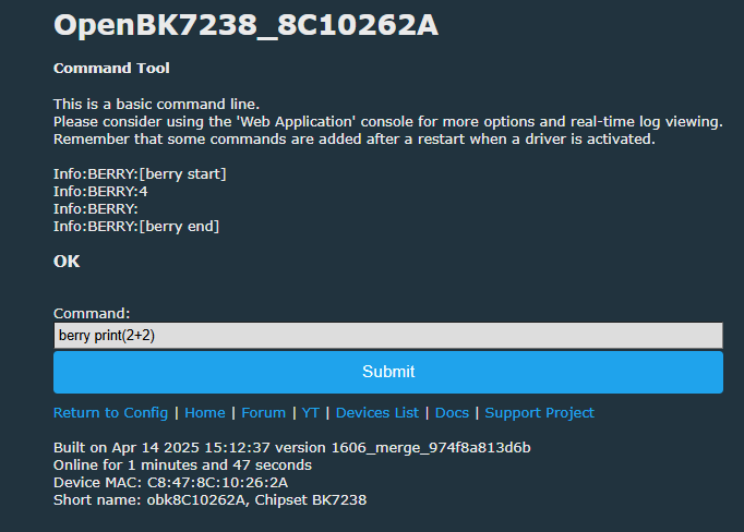

    Let's start by executing some simple Berry commands in OBK command line:
    berry print("Hello, Berry")
    Berry command tool interface displaying the result of the command berry print(Hello, Berry).

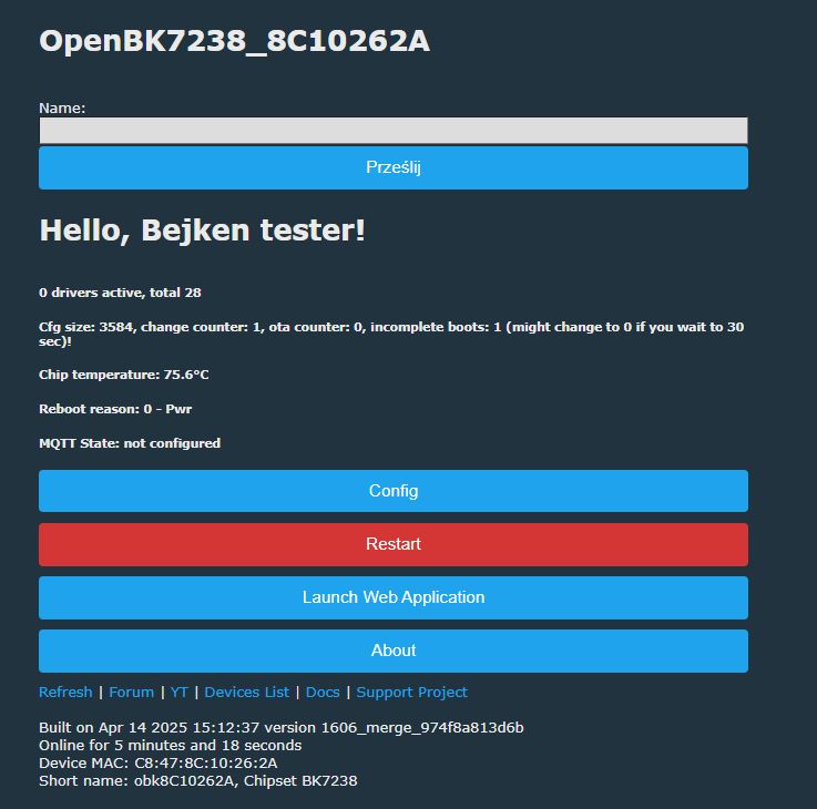

    The same could be done in the Web App console:
    Screenshot of logs showing execution of the command berry print('Hello, Berry') in the OpenBeken environment.

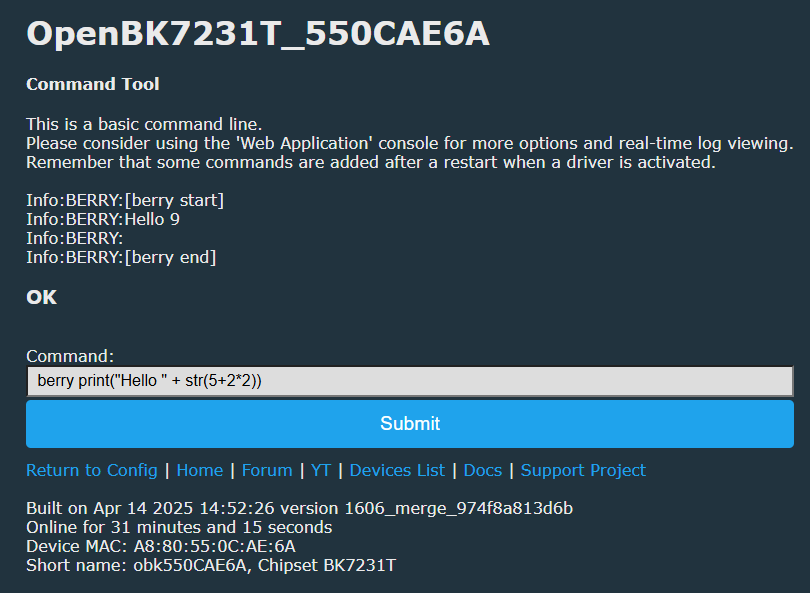

    This way you can test various berry commands, for example, expressions:
    berry print("Hello " + str(5+2*2))

    Custom HTML fields
    HTTP callback also allows you to create custom HTML fields. They can store any kind of data that is later processed by Berry. You can use getVar to access GET variables as well. The input field, however, can be tricky. This is becaue state section is refreshed automatically, so you'd lose the data you type. That's why there is another callback - called "prestate" that runs before state div. So field is created in prestate, and display in the state.
    autoexec = module('autoexec')
    name = "Unknown";
    autoexec.myPre= def(request)
         other = getVar("name");
          if other != nil
            name = other;
         end
          poststr(request, "<form method='GET'>Name: <input name='name'><input type='submit'></form>")
    end
    autoexec.myState= def(request)
         poststr(request, "<h1> Hello, " + name+"!</h1>")
    end
    addEventHandler("OnHTTP", "prestate", autoexec.myPre)
    addEventHandler("OnHTTP", "state", autoexec.myState)
    return autoexec
    Screenshot of a form with a field to enter a name and a Submit button, below is the text Hello, Unknown!
    OBK Simulator user interface with a text field and Submit button

    Added after 57 [minutes]:
    BK7238 test:
    Command line tool window of OpenBK7238 with executed command.
    Added after 3 [minutes]:
    Works:
    User interface for OpenBK7238 with technical information.

    Posts: 5027
    Help: 438
    Rate: 891
    BK-T
    OpenBK7231T command line interface displaying Hello, Berry command example.Command tool with berry print command and results.
