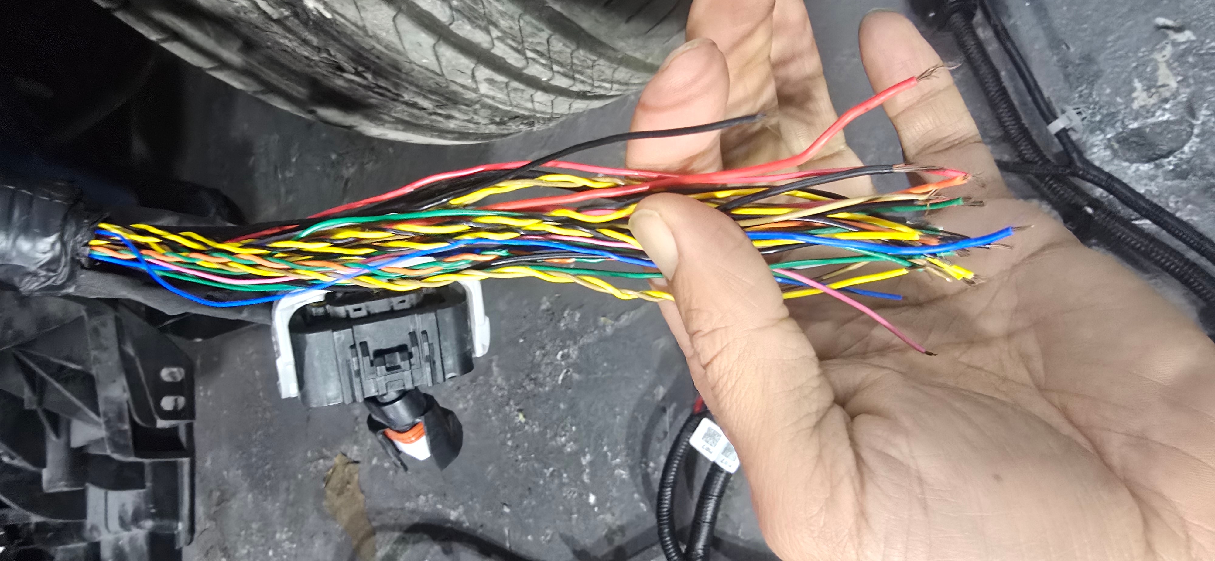

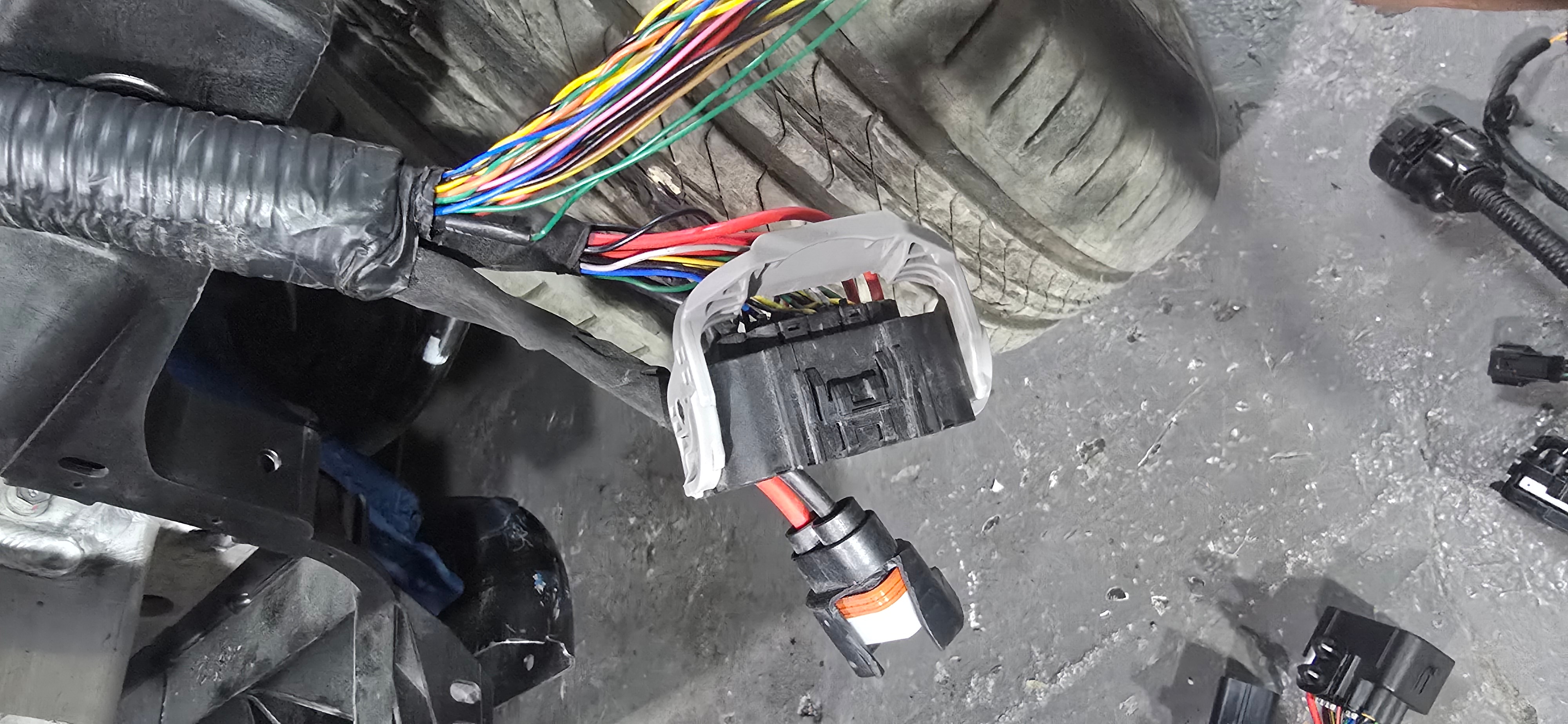

    I have a plug broken that comes out from the fuse box and connects to the front bumper wiring harness. I have a new plug but need diagram or instructions to connect the wires to the plug
    Kia EV9 2024
    MH73ERV
    VIN KNAAE8151R6015354

    Initial assessment of available information
    - You have a broken multi‑pin plug that exits the front (motor) compartment fuse/junction box and mates to the front bumper wiring harness on a 2024 Kia EV9 (VIN KNAAE8151R6015354). You already have a replacement plug and want the correct wire‑to‑cavity assignment.
    - Public owner manuals list fuse/relay names but do not publish connector pinouts. Those are in Kia’s service information (GSW/KGSIS) or licensed third‑party manuals. The exact pinout depends on build options tied to your VIN (trim, ADAS package, fog/DRL type, tow, etc.). (ownersmanual.kia.com)
    - The front bumper harness for EV9 appears as OEM parts 91890‑DO010/‑DO030/‑DO140 depending on trim/market, but the part listing does not include the electrical pin map. (kia.parts)
    Direct answer to the question
    - The safest way to obtain the precise pinout for your exact connector (by VIN) is to pull the “connector view” and “wiring diagram” pages from Kia’s Global Service information. For North America this is Kia GSW/KGSIS (72‑hour subscription available; Canada example shown below), which provides VIN‑specific connector IDs, cavity numbering, wire color/gauge, and circuit destinations. With those two pages you can repin the new plug correctly. (gsw-kia.ca)
    - If you prefer not to subscribe, a dealer service department or an online manual provider can print or provide the two pages for your VIN (connector view and system schematic). Example commercial aggregators exist (e.g., RepairSurge) if dealer access is inconvenient. (repairsurge.com)

    - “Transfer method” (if the old shell still shows original positions): Move one wire at a time from the damaged shell to the new one, matching cavity numbers. Photograph both faces before starting. This avoids schematic hunting.
    - “Map‑and‑verify method” (if wires are loose or shell missing):
    1) Identify the connector code on the harness label (white tag near the plug).
    2) Pull the “connector view” and “system” pages for that code in GSW/KGSIS (or have a dealer print them).
    3) Confirm each wire by color and destination using a multimeter for continuity (e.g., to fog lamp or horn connectors) and by identifying grounds (continuity to chassis). Maintain twist rate of data pairs and shield bonds for camera/radar lines.

    Questions for the user
    Please provide the following so I can tailor a step‑by‑step pin map or confirm the correct connector page to pull:
    - A clear photo of the new plug (front/terminal side and back/wire side).
    - Any markings or part numbers on the plug (inside the latch area or on the rear).
    - Pin count and the list of wire colors/gauges present.
    - A photo of the mating connector on the bumper harness and the white label near it (often shows the connector code).
    - Which functions on the bumper currently do not work (fog/DRL, horn, sensors, camera, active air flap)?
    With that, I can identify the connector code and tell you exactly which EWD pages to grab (or, if the photos are clear enough, guide you cavity‑by‑cavity).
  • #3 21782944
    ymasjidi871
    Where can I get the wiring diagram for this part
