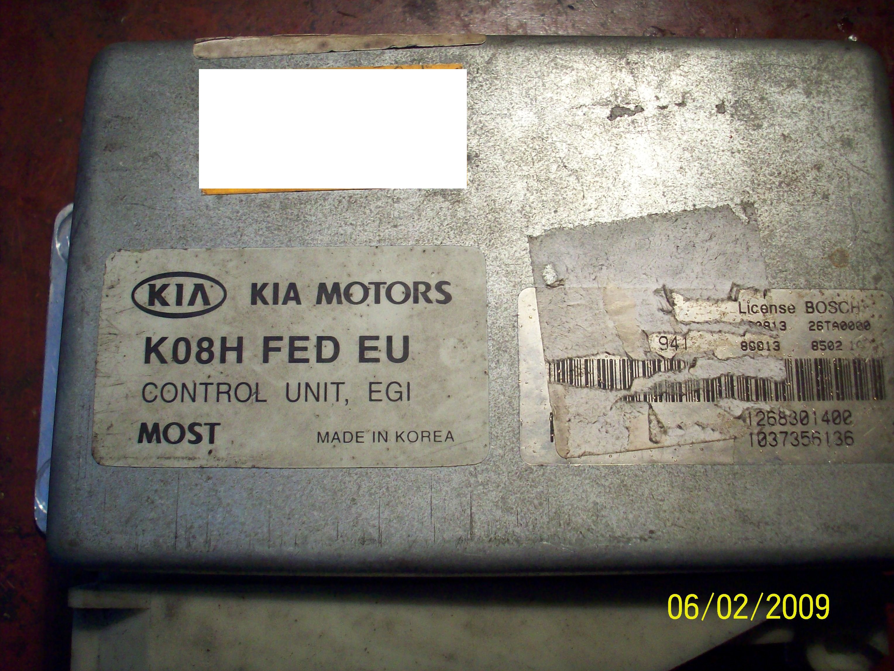

    So the matter looks like this - I got a car like in the subject, the key is out of the car, the driver is from the car (No. BOSCH: M 261 204 941 / No. KIA: K08H FED EU).
    Only the immo cannon is missing (some fejsiarz undertook to make the key and disappeared with the can).
    And now the question to the Collegues - does anyone know the mark of the box immo, because I must admit that I do not sit in Korean every day. At Allegro, I found 350 cans with the designation Q2AC 67 7R0A - will this can come?
    I am asking you that ONLY people who have something specific to say would be the subject of the speech. I have Carmana, factory drums for matching and without immo, so I have no problem with the background.
    PS- I tried immortally to try, I put in the memory and eprom the ream without, I transfered the transistor, I made a cross on the tile, but it did not help (I had a hint of hope that it will move despite the lack of can), Carman shows no faults.
    So it's wisest to put a can and fold everything - I just want to make sure about the can.
    greetings

    to the author of the topic - you want the central unit is just a service by vin numbers. Otherwise at random.

    I do not know what, but I think the kill_immo option will be better. The only additional job will be to swap the two end cables in the three-pin coil plug or the ignition cables.
    It also seems to me that this will be the most sensible option, just the question of whether it will move without an immo box? Because maybe you've changed the subject and will not have to reinvent America. Because if it moves without a can it's ok, and if it turns out that, after all, it is needed, I will only do the work. However, I will probably leave it as a last resort, because I would prefer to put on a can, match everything to myself and do it as I left the factory. I always leave immo removal as a last resort.
    more economical will not buy a new immo even I have a few new Meta M36T2 for 300 I can sell at home.
    I wrote that I would like to ask people oriented in the topic and not for offers a'la allegro - why do I need any immo, if the case concerns a factory immobilizer bypass (motor controller + immo can + key) - do not know, do not say a.
    I have already determined the numbers of the ori central unit: OK2AC 67 7R0B - now there is only one to buy somewhere :)

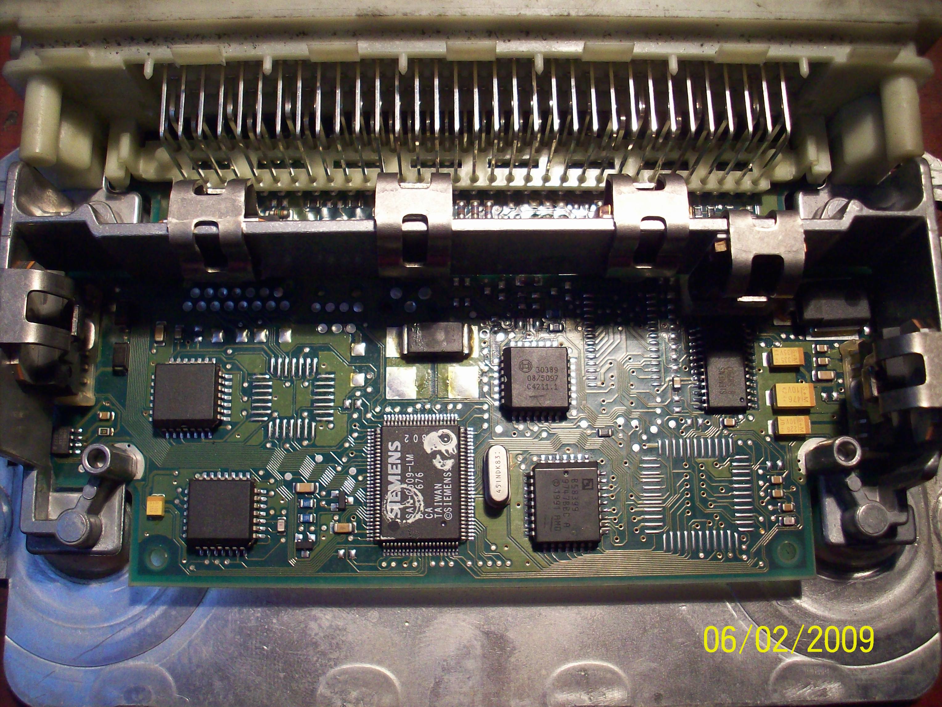

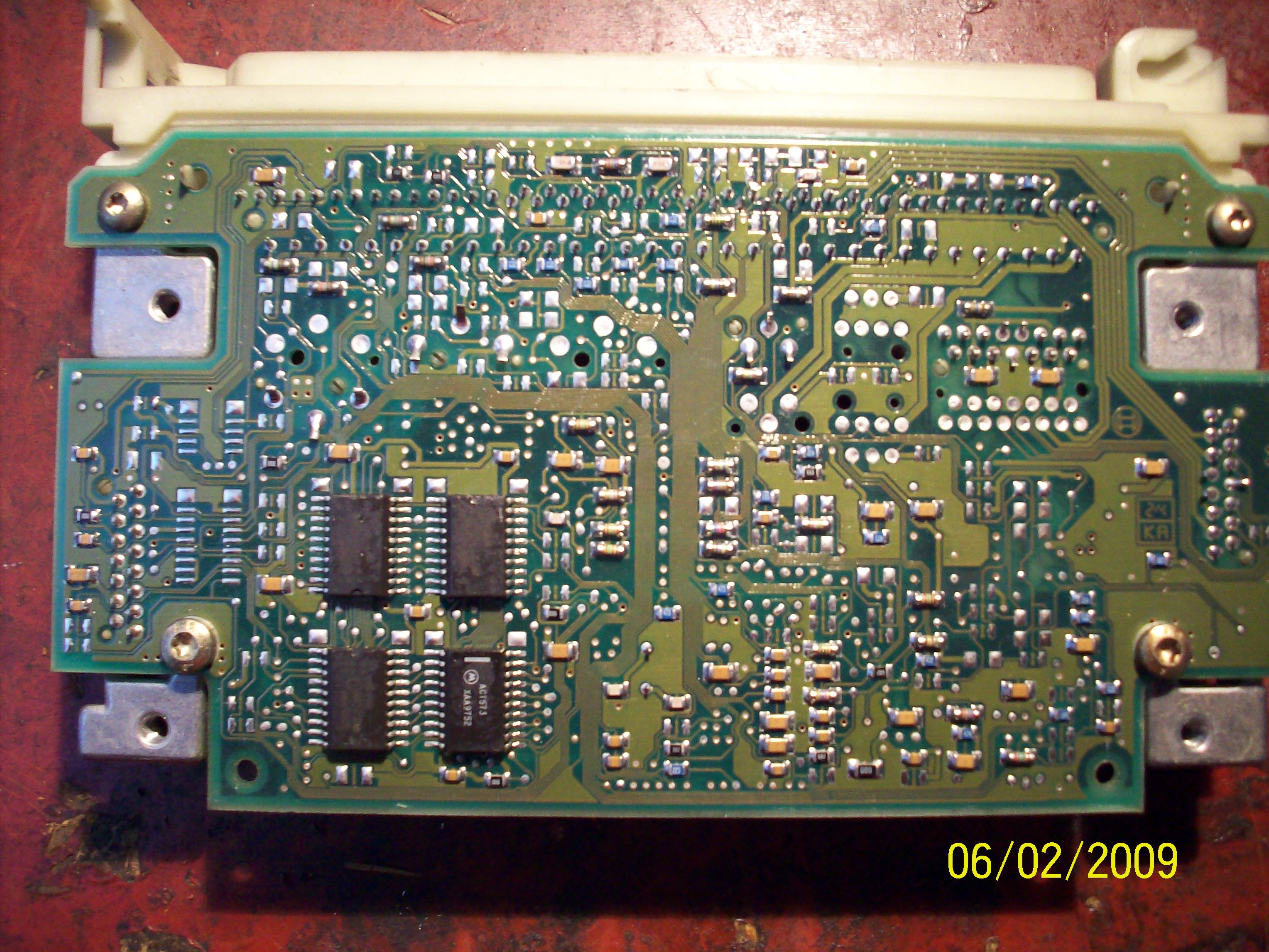

    The driver is still the old Motronic clunker, but there is no inscription on the embossed housing. In the middle of 28F010 PLCC and 24C04. I will add a photo of the viscera, and you, the elektrite, sent ripples to PW - you can take a peek of curiosity :)

    autoelektronika.ns wrote:
    The driver is still the old Motronic clover, only there is no lettering on the embossed housing. In the middle of 28F010 PLCC and 24C04. I will add a photo of the viscera, and you, the elektrite, sent ripples to PW - you can take a peek of curiosity :)
    A small note
    B58253 to 24c02
    and should be just B58253 - I do not think I'm wrong?
